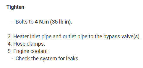

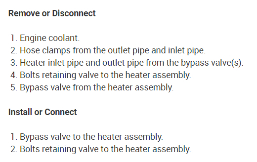

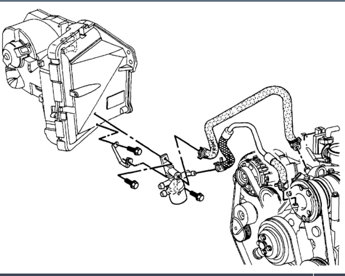

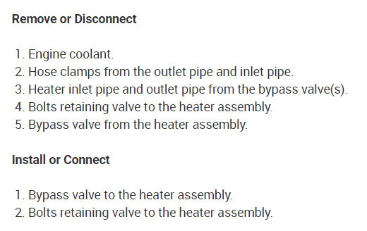

I've attached the picture steps below on how to change the valve and its location.Hope this helps and thanks again for using 2CarPros.
