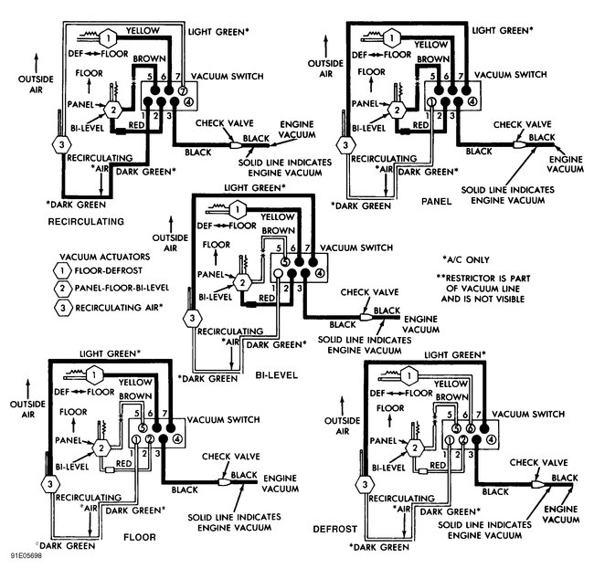

I just do not know where to disconnect the vacuum lines.
Feb 5, 2017 at 1:18 PM
Should be a large connector block with the lines molded into it that plugs onto the back of the control panel. Here is a diagram showing the line colors and locations.
