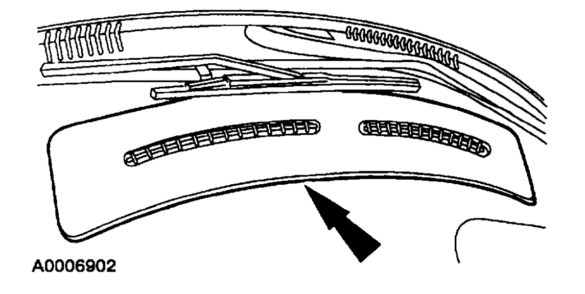

Have a heater codes 024 and 051 say's that it is a solar radiation sensor, but cannot find it on any parts sites. Is it called something else?
Nov 28, 2018 at 11:15 PM
Good morning,
This sensor is part of the ambient temperature sensor outside the car. I attached pictures and the procedure for you to view.
REMOVAL
1. Remove the defroster grille.
^ Disconnect the sunload/headlamp sensor electrical connector.
NOTE: Lift upwards on the rear edge of the defroster grille then slide rearward to remove.

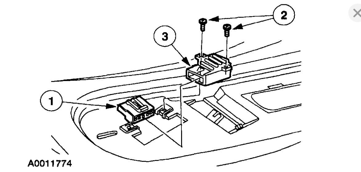

2. Remove the light sensor amplifier.
1 Disconnect the light sensor amplifier electrical connector.
2 Remove the screws.
3 Remove the sensor.
CAUTION: To avoid damaging the light sensor amplifier electrical connector, carefully tilt the panel to expose the connector without stretching the wiring.
INSTALLATION
1. To install, reverse the removal procedure.
