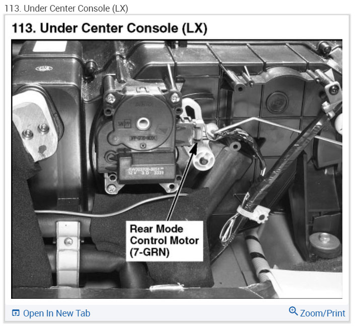

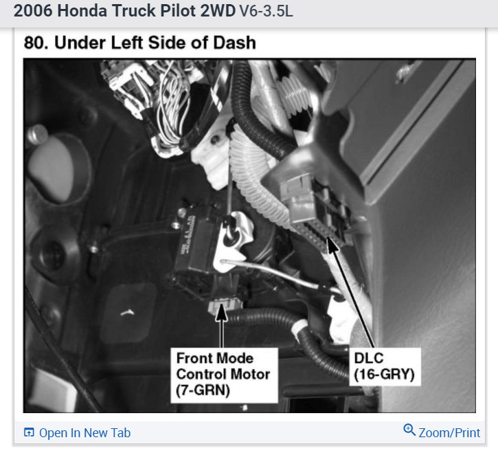

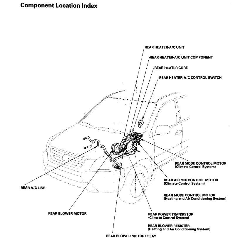

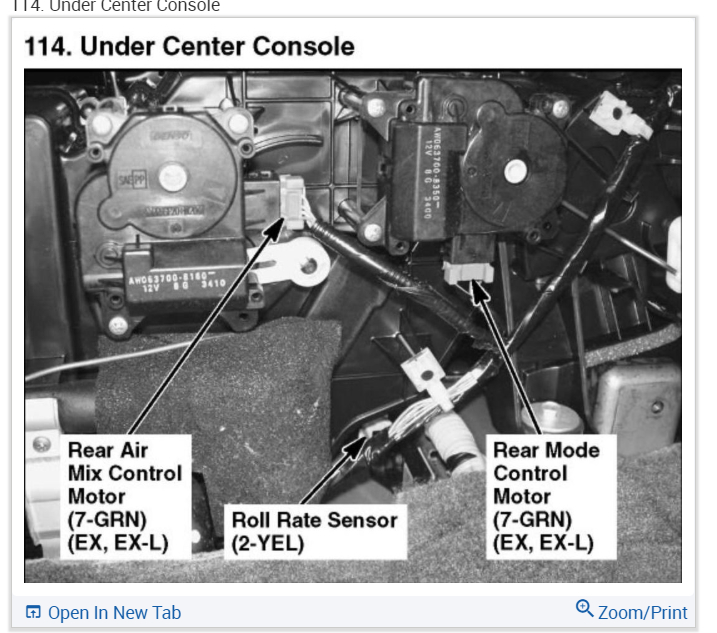

Additional to my first question. It feels as if it is blowing hotter in the rear console. Also I switched out the control assembly on the dash with one from recycle yard, but no changes. I got a new blend door actuator from AutoZone plugged it into the connector outside before switching out, but that did not show any movement on the cam, instead, when connected and the system is on, the screen on control goes blank after turning the ignition off and disconnect actuator it resolves back to normal but no movement. Thanks I hope my explanation makes some sense.
Oct 19, 2018 at 8:11 PM

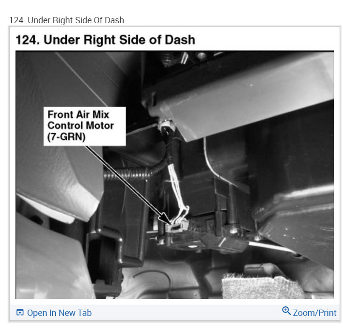

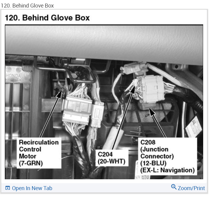

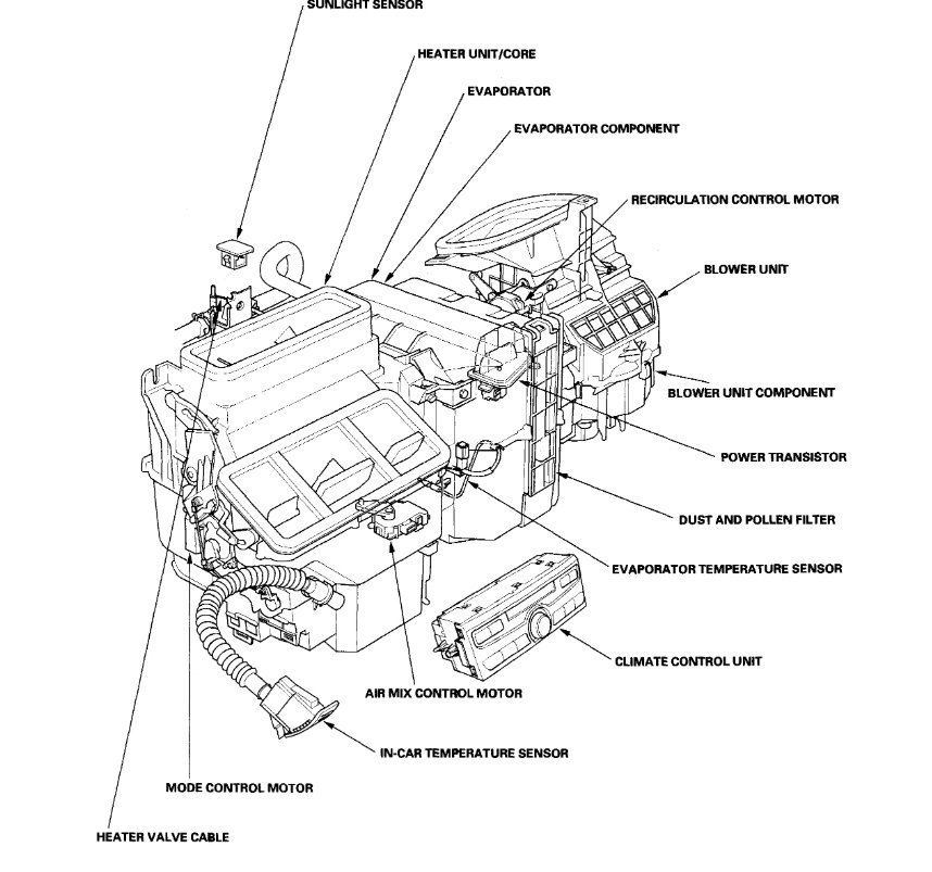

It sounds like you have a bad actuator. I would try a OEM unit can you confirm the heater hoses coming into and going out from the fire wall are hot? You may have air trapped inside the heater core which is common.
Here is a guide that can help and diagrams below to show you how the system works and the locations of each blend door actuators:

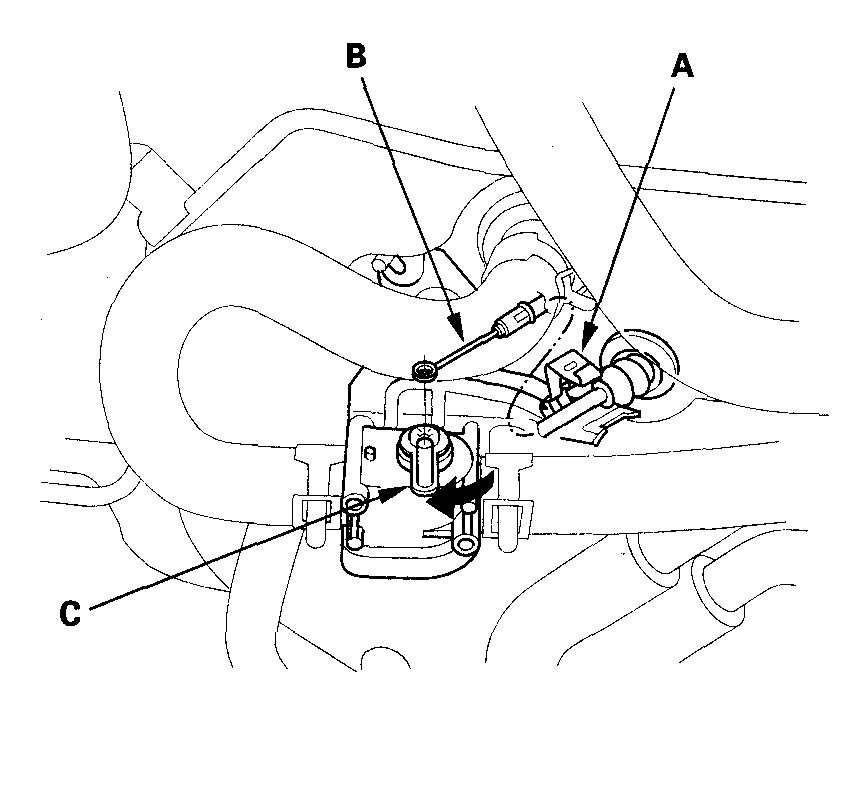

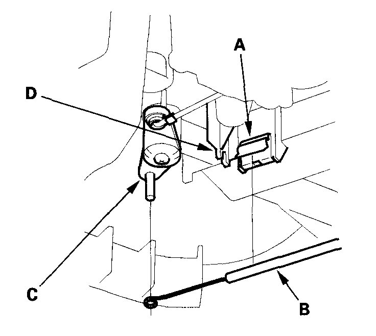

No heat. Changed heater valve and thermostat, still no heat. Discovered cable on old valve was stuck on partial open before replacement. All vents are functioning as they should, but the cable on the valve is still in the same position. Right now the cable on the valve is disconnected in order to facilitate some heat. Thanks for any advise.
Oct 22, 2018 at 8:03 PM (Merged)
HI and thanks for using 2CarPros.com.

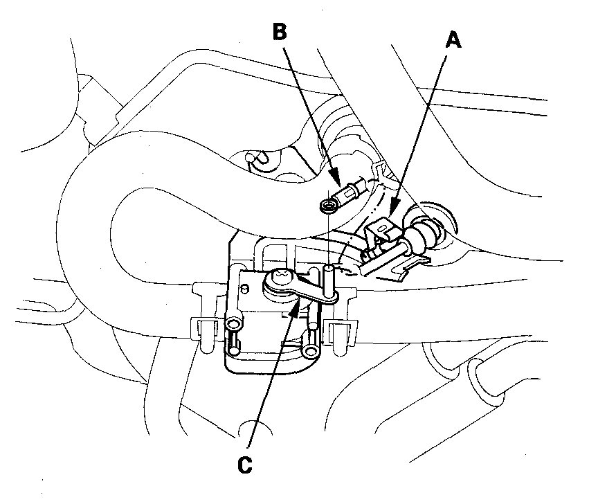

It sounds like the cable itself is either damaged, disconnected in the vehicle, or needs adjustment.
First, since you already have it disconnected under the hood, have a helper move the temperature control knob in the vehicle while you watch under the hood to see if it is moving.
If it is moving correctly, follow these directions for adjustment. The first three pictures correlate with adjustment.
________________________________________
Heater Valve Cable Adjustment
1. From under the hood, open the cable clamp (A), then disconnect the heater valve cable (B) from the heater valve arm (C).
2. From under the dash, disconnect the heater valve cable housing from the cable clamp (A), and disconnect the heater valve cable (B) from the air mix control linkage (C).
3. Set the temperature control dial to Max Cool with the ignition switch ON (II).
4. Attach the heater valve cable (B) to the air mix control linkage (C) as shown in step 2. Hold the end of the heater valve cable housing against the stop (D), then snap the heater valve cable housing into the cable clamp (A).
5. From under the hood, turn the heater valve arm (C) to the fully closed position as shown, and hold it. Attach the heater valve cable (B) to the heater valve arm, and gently pull on the heater valve cable housing to take up any slack, then install the heater valve cable housing into the cable clamp (A).
If the cable doesn't move when it is being adjusted in the vehicle, either it is broken, detached on the interior, or it is corroded internally and needs replaced.
Let me know if any of this helps.
