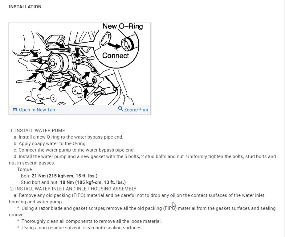

When installing heater bypass tube into back of water pump is silicone needed as well as new o-ring?

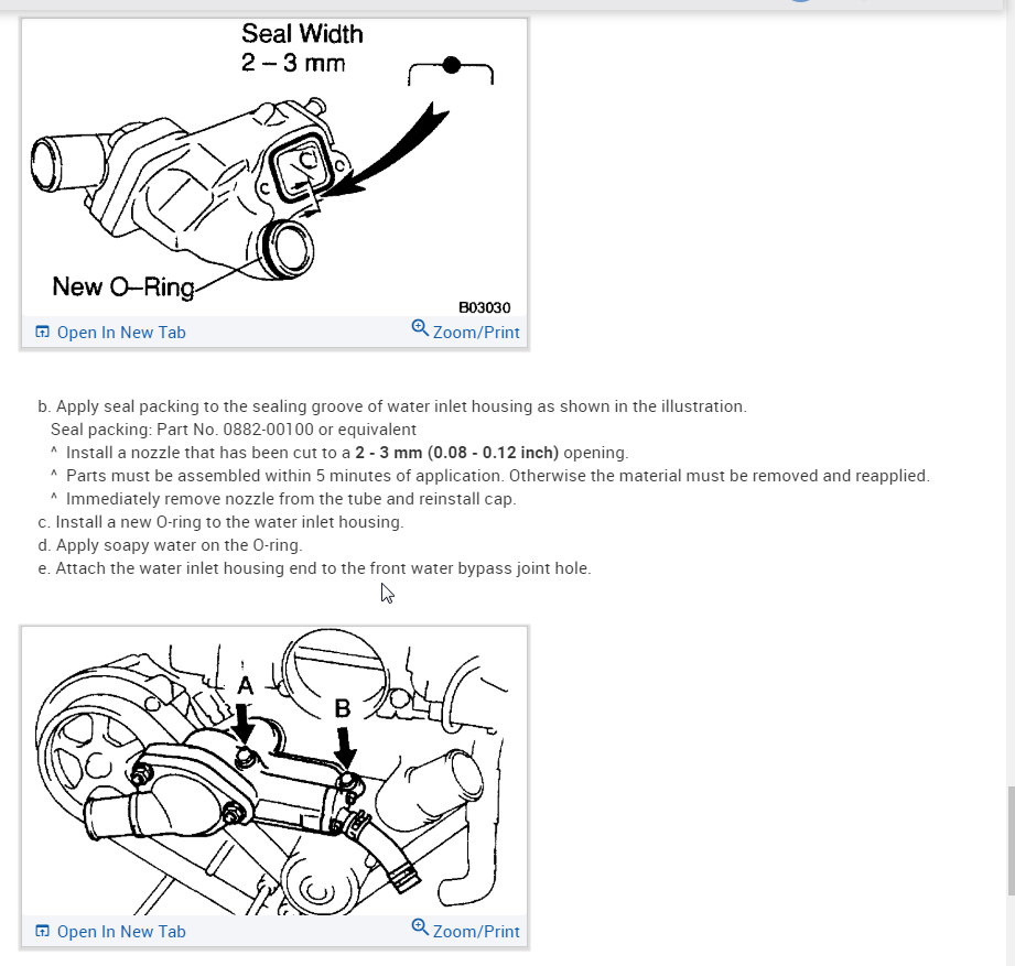

Hi Dave,
According to the manual you do not. Here is the installation procedure in case you need the rest of the process.
Let me know if you need anything else. Thanks
