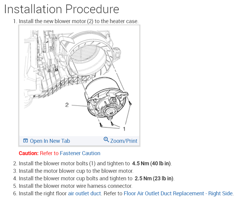

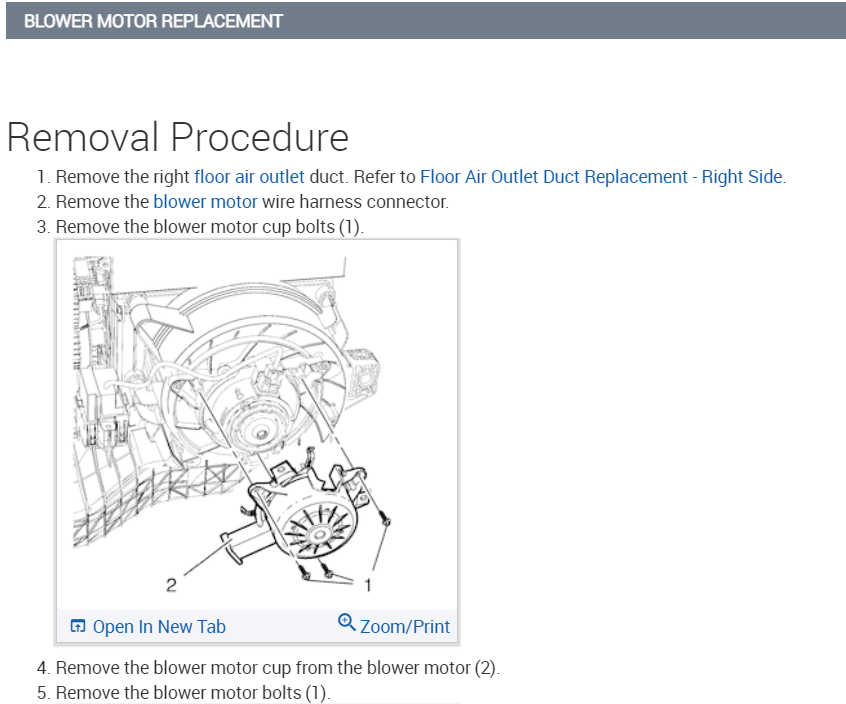

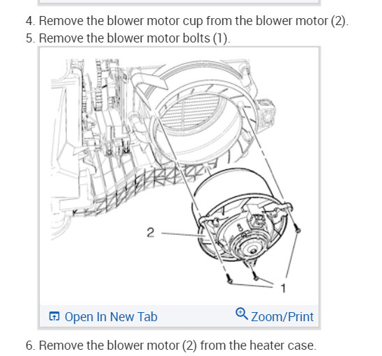

It sounds like the blower motor is not working. Here is a guide to help confirm the issue with images below to show you how to change the part out:
https://www.2carpros.com/articles/blower-fan-motor-works-on-high-speed-only
Check out the images (below). Please let us know how it goes.
