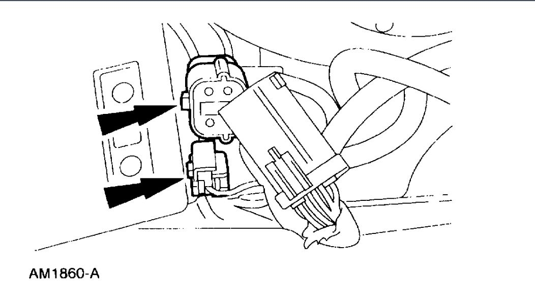

It is behind the trim panels inside the rear hatch.
I provided pictures and a procedure for you.
REMOVAL
1. Remove the trim panels.

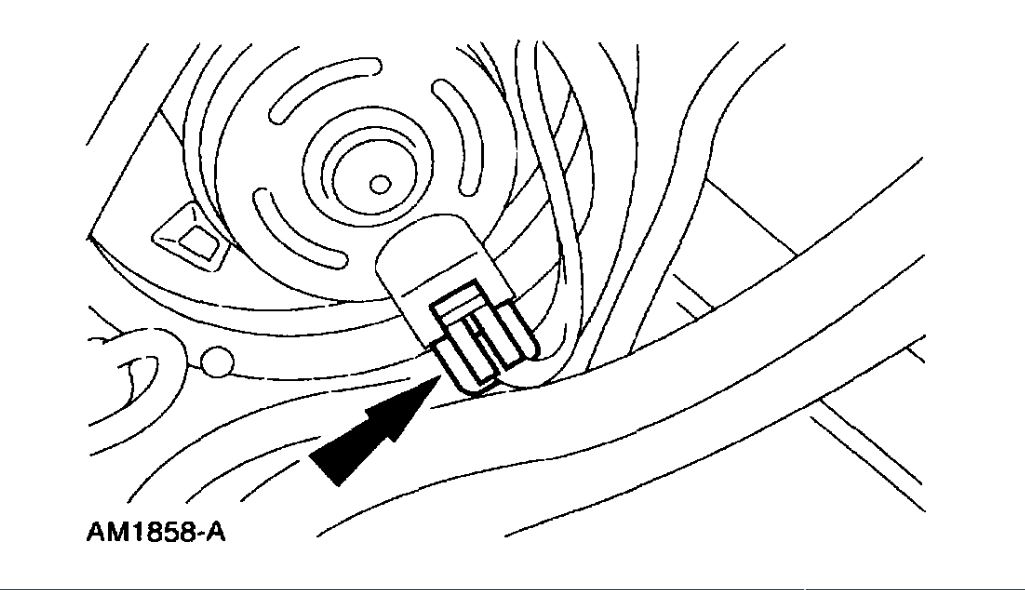

2. Disconnect the connectors.
3. Disconnect the rear blower motor.

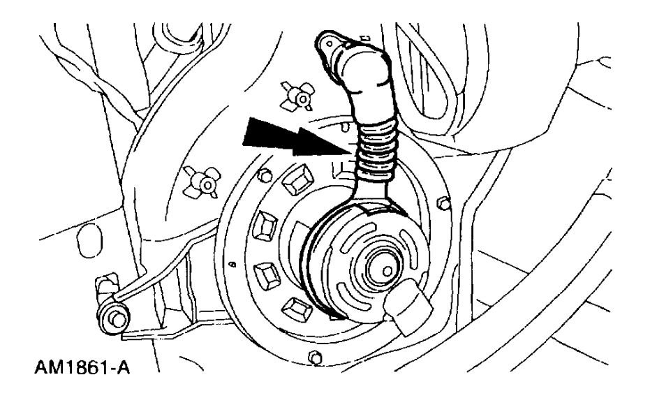

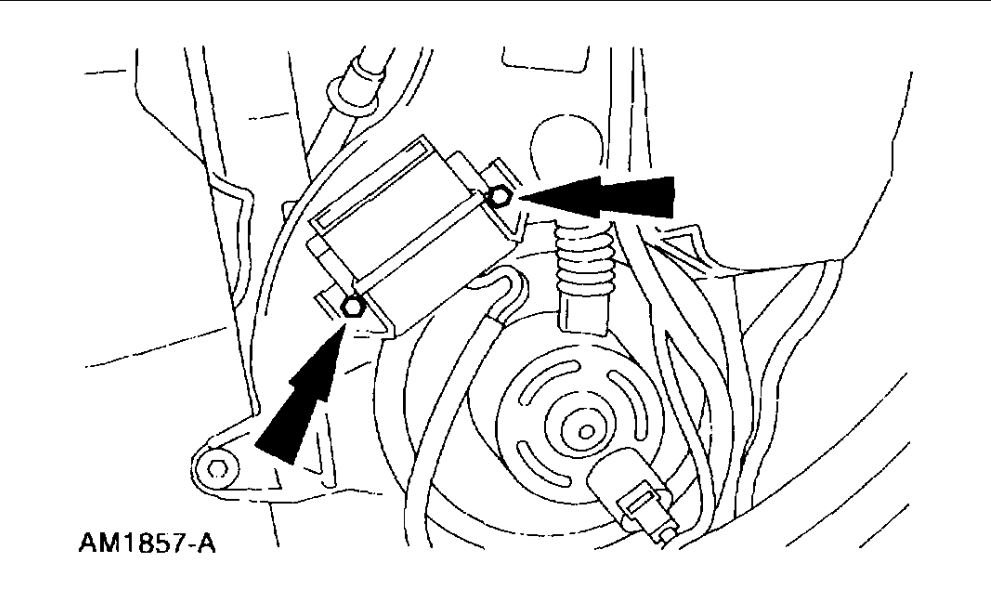

4. Remove the screws.
5. Remove the vent tube.

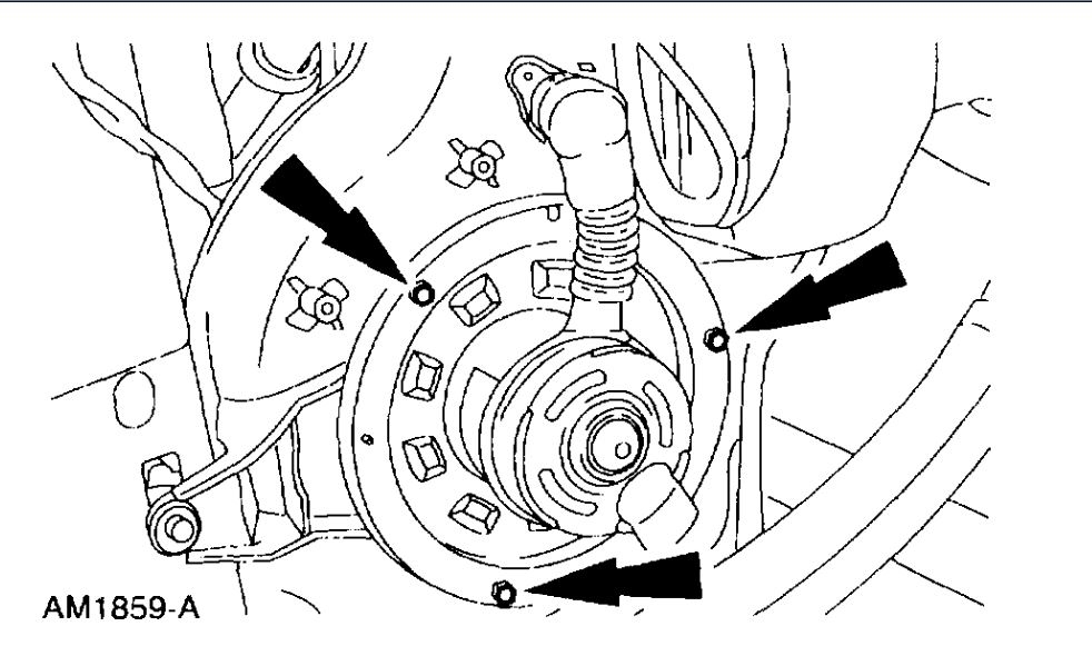

6. Remove the rear blower motor.
Remove the screws.
