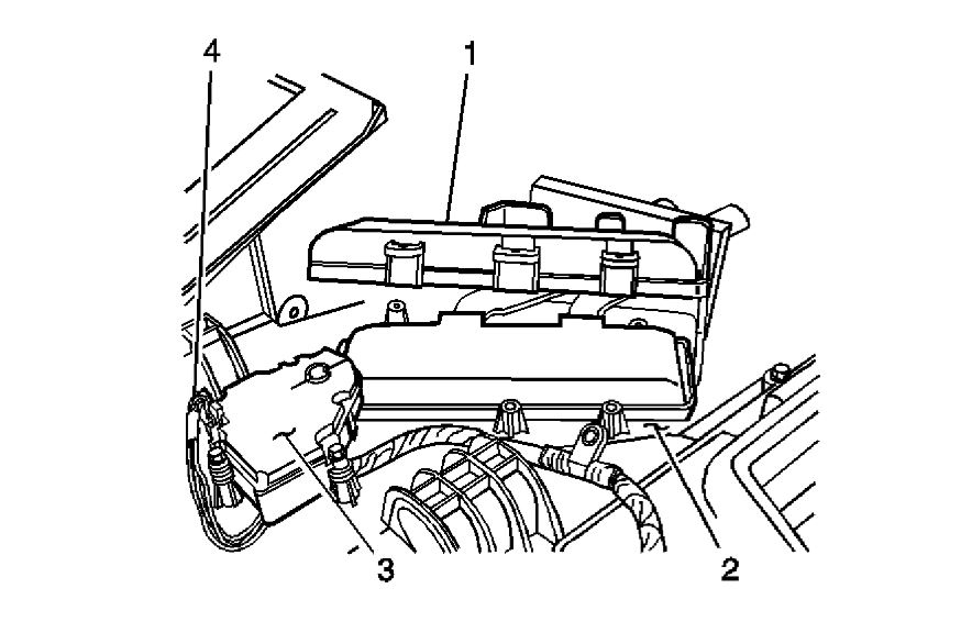

When I turn the heat on, the driver side blows heat but the passenger side blows cold air. I don't hear any unusual noises.
Oct 23, 2019 at 10:11 AM
Welcome to 2CarPros.

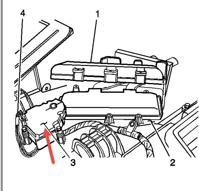

On this vehicle's dual climate control, there are two blend air door actuators. Most likely, the one for the passenger side has failed.
Take a look through this link:

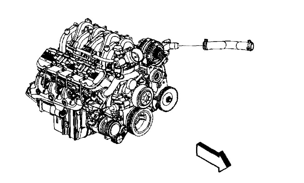

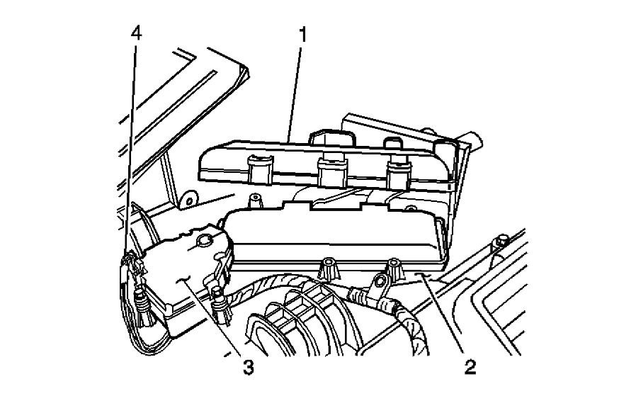

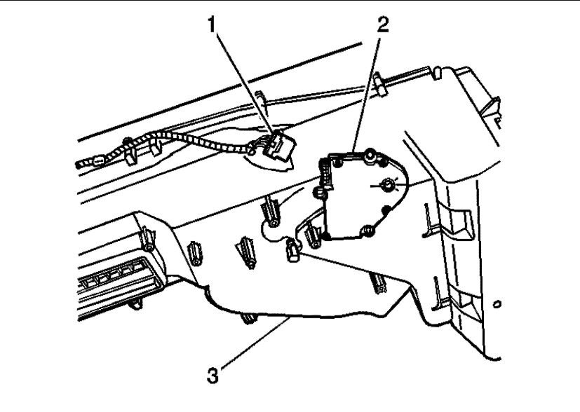

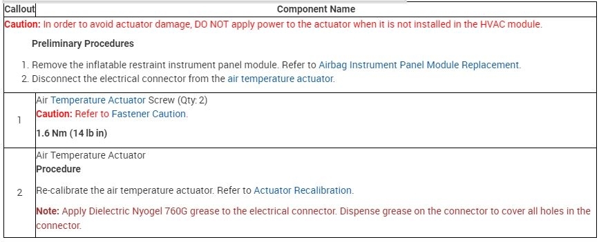

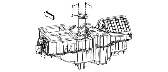

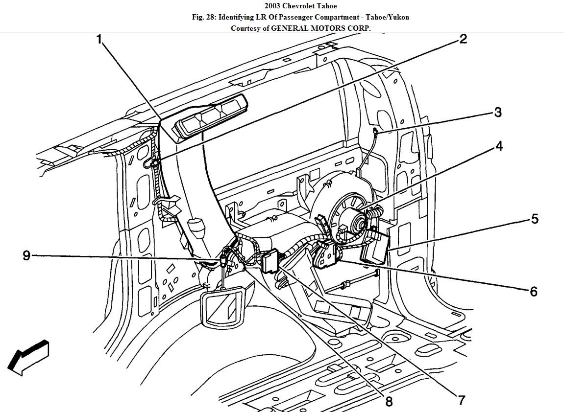

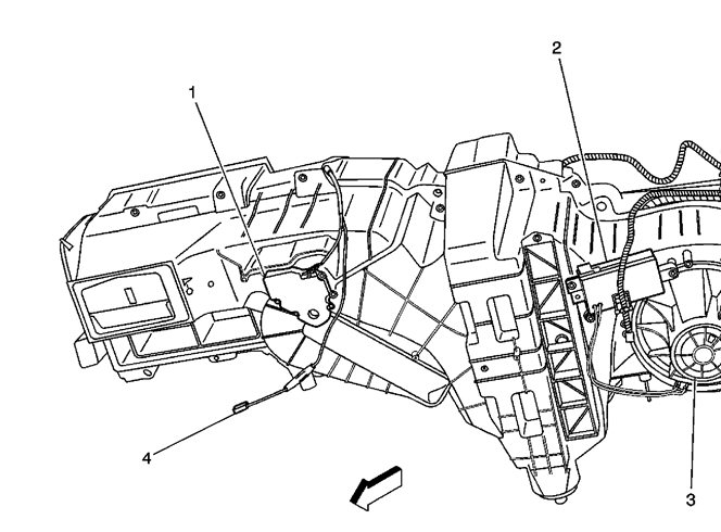

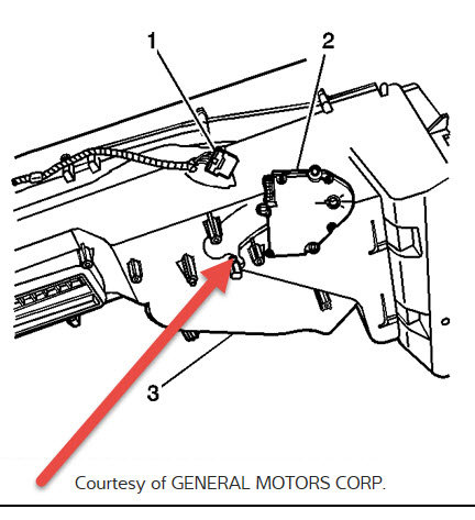

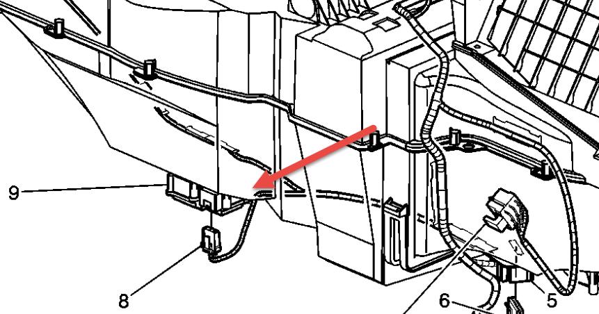

Now, I attached the pics specific to your vehicle for right side actuator replacement. Pic 1 shows location and pic 2 are the directions.
What I would suggest is to locate and test the switch to see if it is getting power. If there is power and the actuator isn't responding, replace it.

Ok sounds like auto system, here's a diagram of the parts and location, I do recommend a scan!

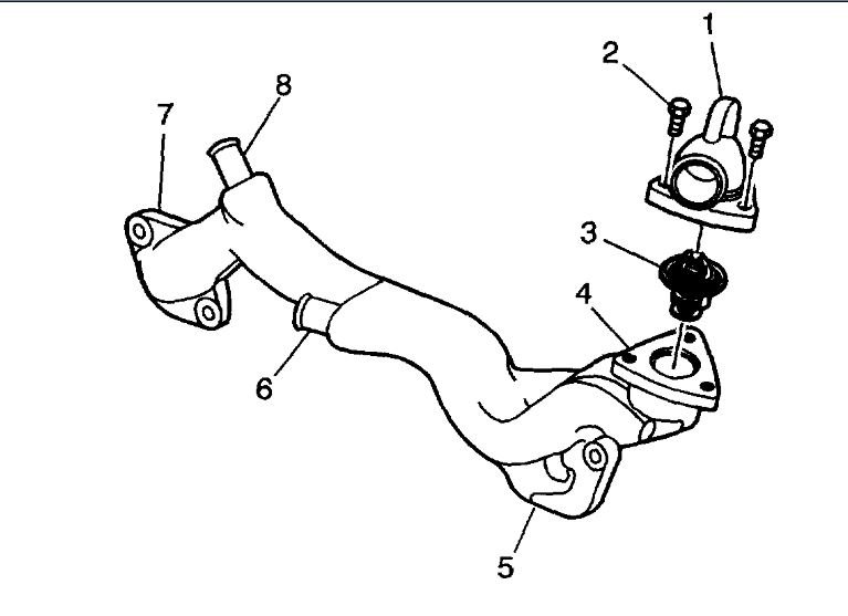

BRYAN FORBES
what are the possible cause for no heat coming into cabin to the vehicle. Cabin air filter was change ?
Feb 19, 2021 at 7:54 PM (Merged)
HMAC300
  • 48,601 POSTS

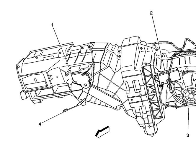

see if both heater hoses are hot when engine warm, then it couldbe an actuator on the heater stuck or not getting power and not opening. beneric pic enclosed.
