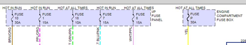

check fuses in pic and then have a pro scan it to see what is wrong due to it being auto temp control can be anything until scanned.
