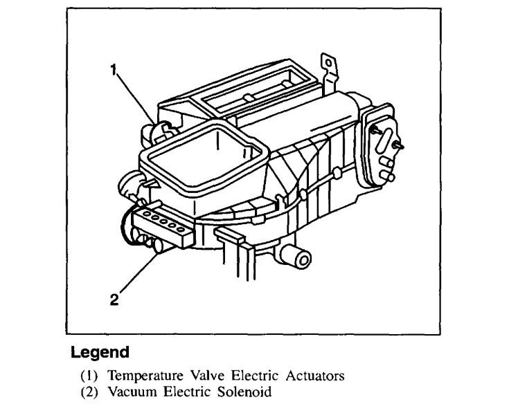

As far as the blend door actuator, if you reset it and it went back to not working, the actuator is the issue. When it is replaced then you can calibrate it for the final step.
Procedure
Remove or Disconnect
1. Battery ground (negative) cable.
2. Instrument panel carrier.
3. Electrical connector to temperature valve electric actuator.
4. Mounting screws to temperature valve electric actuator.
5. Temperature valve electric actuator.
Install or Connect
1. Temperature valve electric actuator.
2. Mounting screws to temperature valve electric actuator.
Tighten
^ Screws to 1.5 N.m (13 lb. in.).
4. Instrument panel carrier.
5. Battery ground (negative) cable.

Am I correct in saying that the the blend door is responsible for mixing hot and cold air to achieve the correct temperature? If so, are there typically two blend doors actuators if the car has dual-side climate controls (driver and passenger side)? I have been searching parts lists and have not found a definitive answer. I know there are two types of actuators for auto vs. manual climate control, but I get conflicting answers on whether there are two blend door actuators in the system.
Nov 13, 2018 at 9:25 AM
The actuators are the same.
You have one for each side.
The blend door actuator moves a door that directs either cold air or hot air based on the command.
