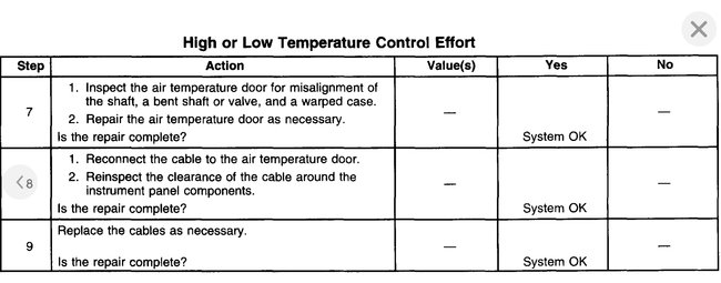

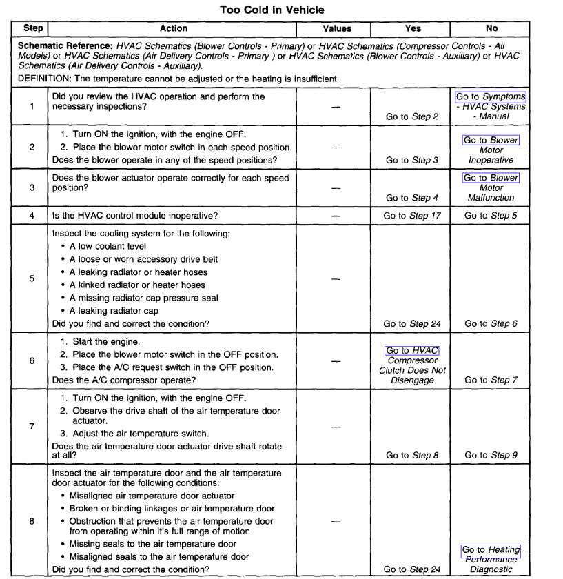

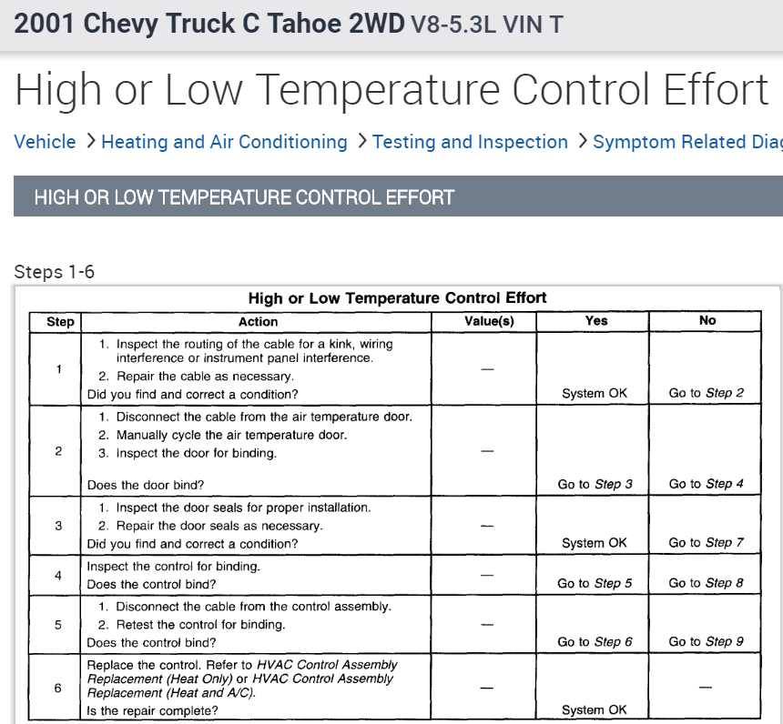

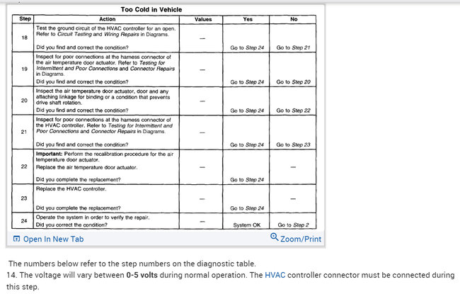

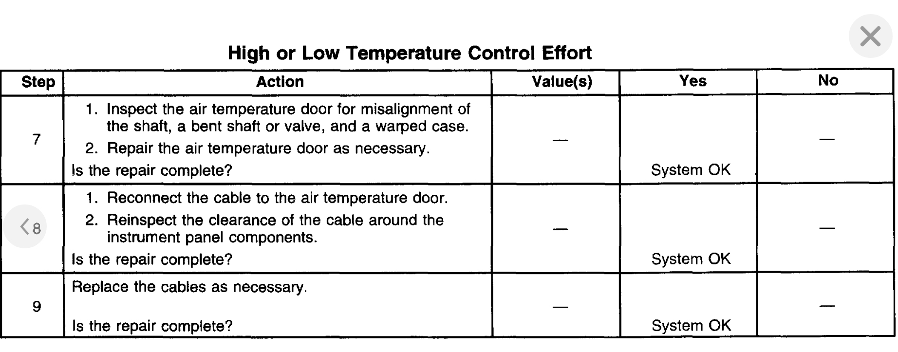

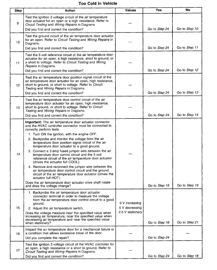

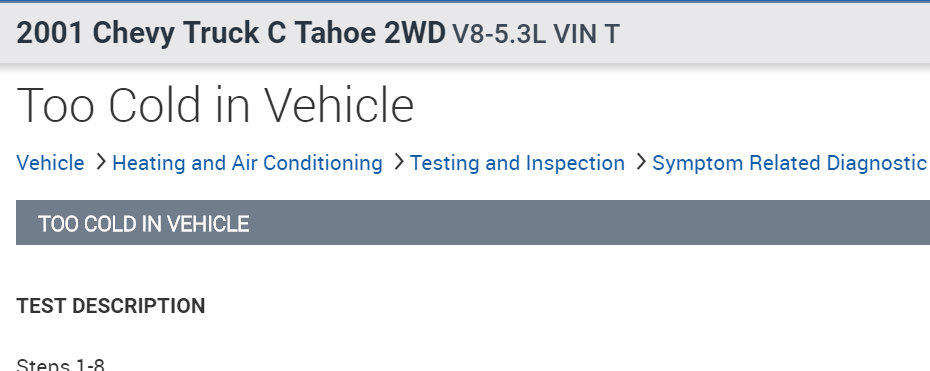

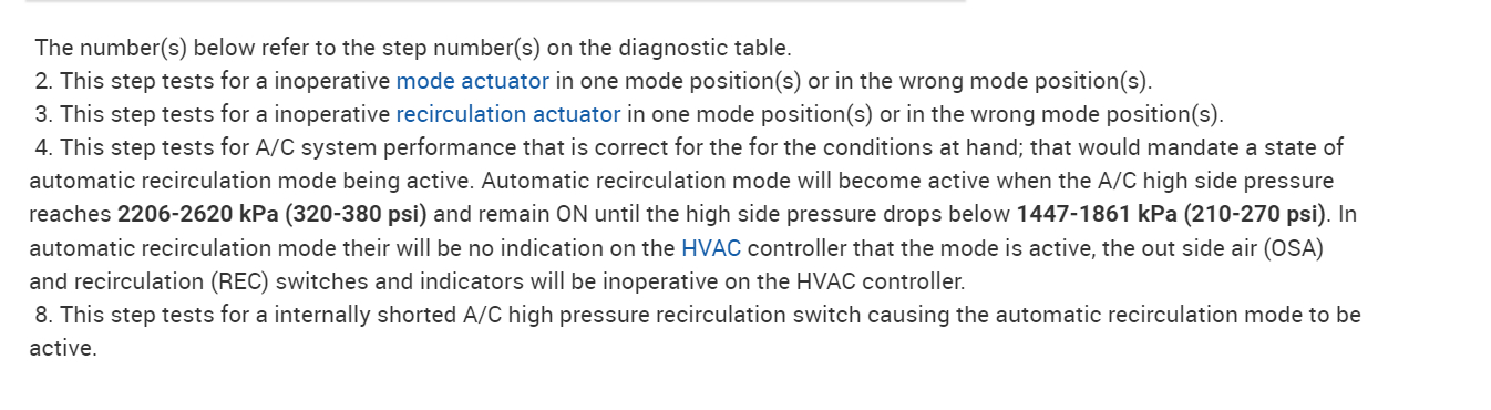

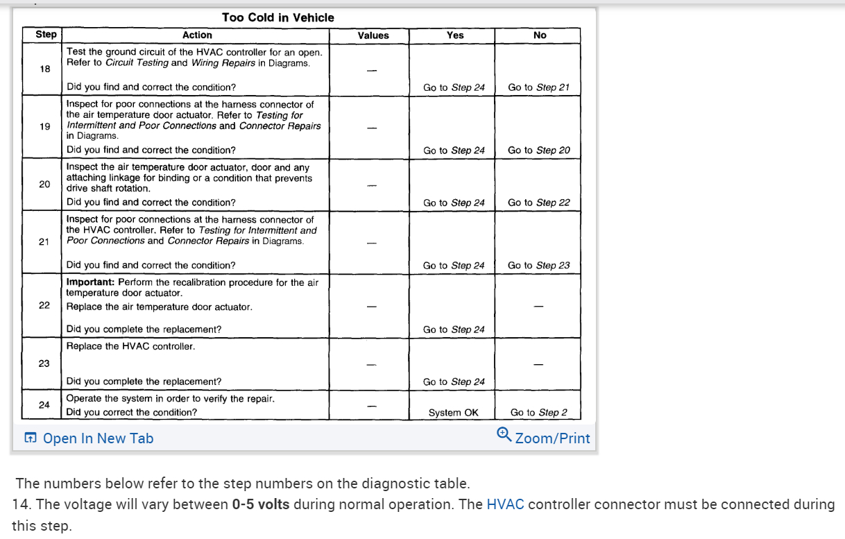

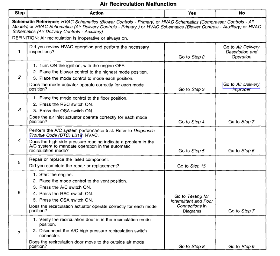

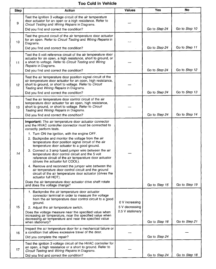

This could be a problem with your blend door. In the diagrams below I have included a few step by step factory troubleshooting flowcharts. Please go through them and let us know what you find out. We are glad to hear that you like the site. These guides can help fix it
https://www.2carpros.com/articles/car-heater-not-working
and
Check out the diagrams (Below). Please let us know what you find. We are interested to see what it is.

I have looked at the diagrams and so far they seem a little complicated for me to understand. I will work on it though for sure.
Just wanted to know if it is possible for the blend door actuator to be bad even if it's turning the blend door shaft? Would you recommend replacing it or should I skip or start with the diagnosis process?
