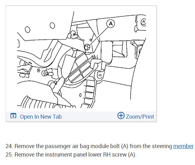

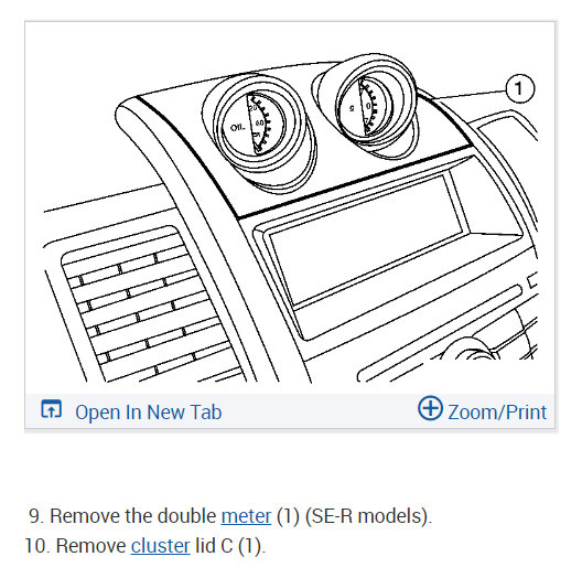

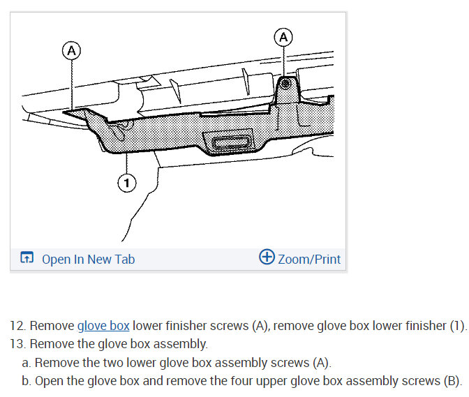

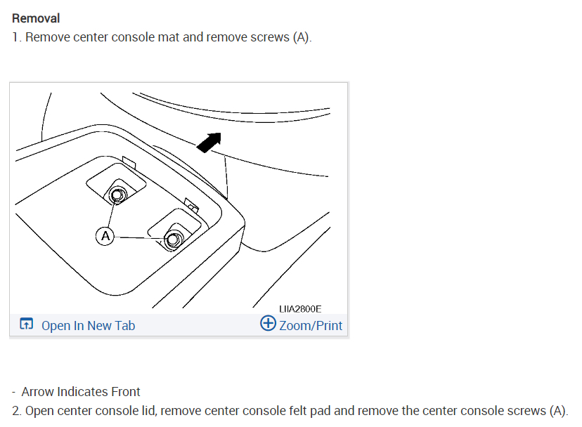

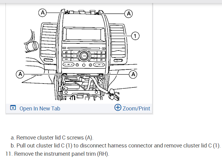

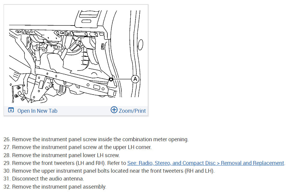

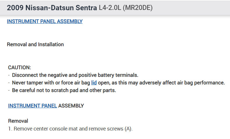

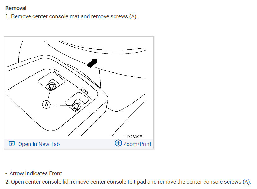

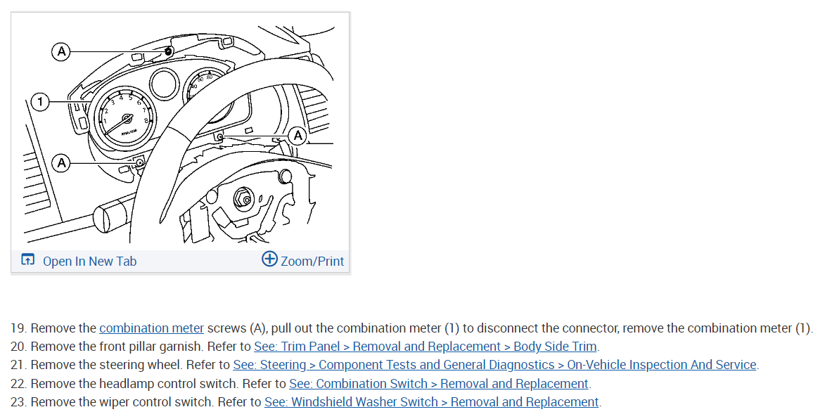

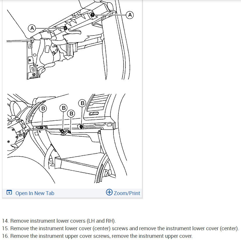

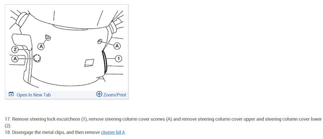

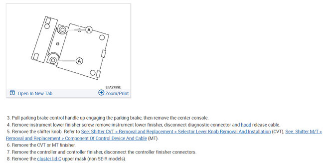

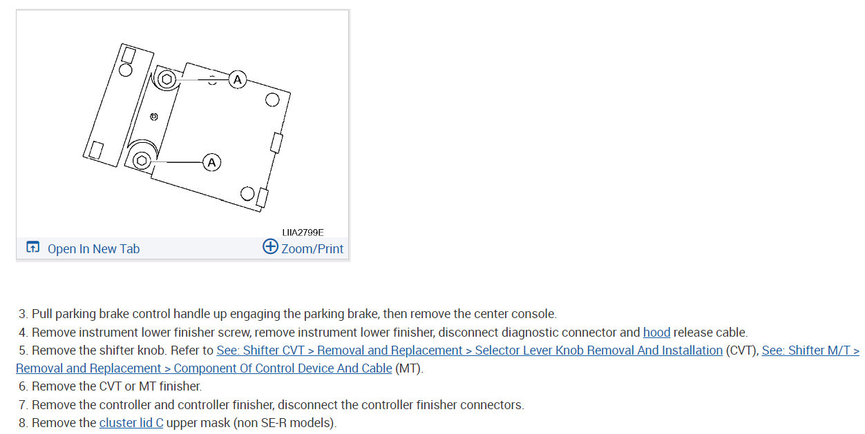

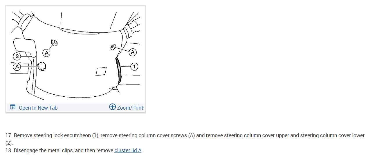

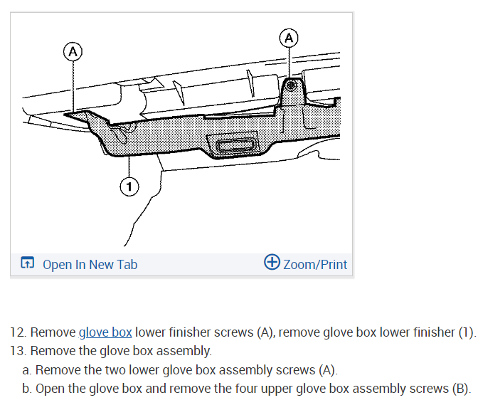

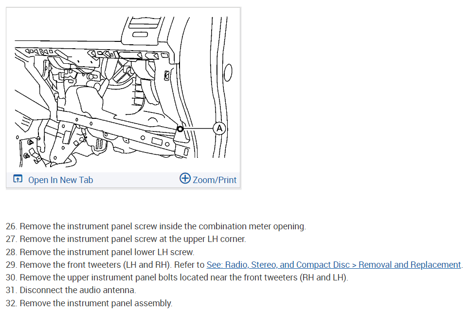

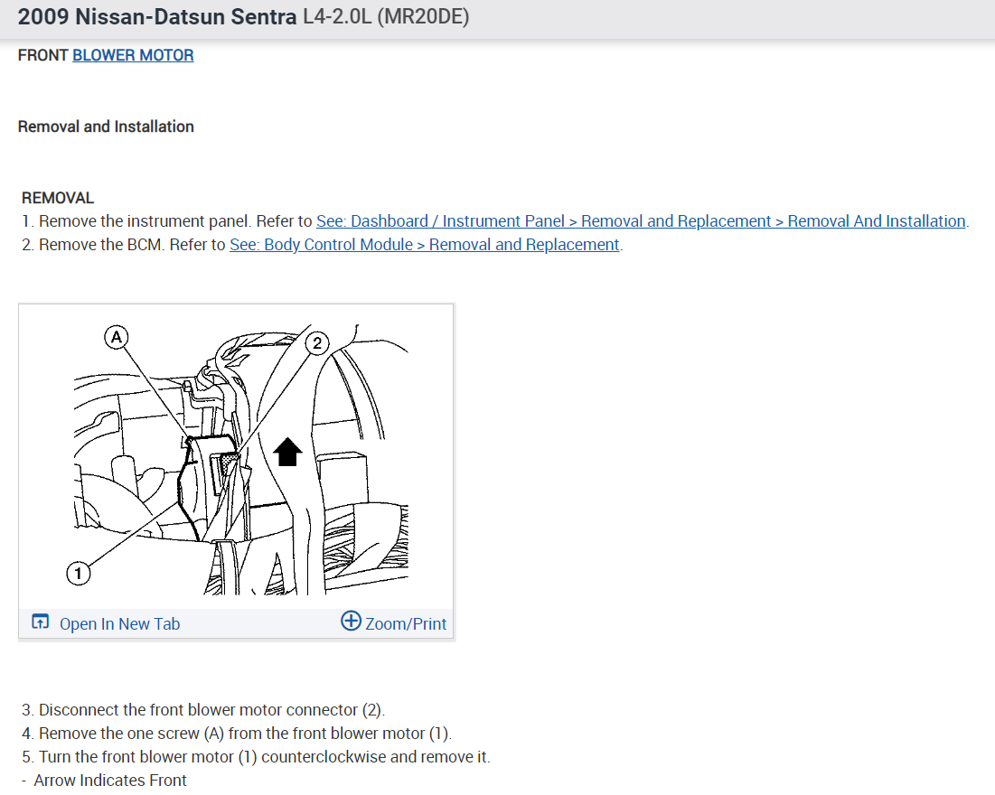

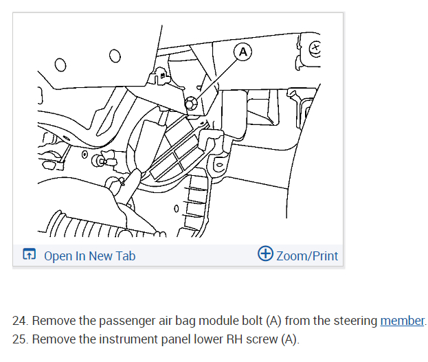

Yep, this happens when the blower motor itself is going out; here is the location of the unit so you can change it out, which should fix the problem. I am sorry but it looks like the dash will need to be removed to access the blower motor which I have included instructions for. Just take your time and you can do the job. Check out the images (below). Please let us know what happens. Start by disconnecting the battery.
