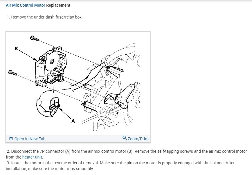

This could be the air mix door actuator. This is a common failure for this issue.
I attached the picture and the procedure for you to replace it. You can get the actuator at any parts store.
