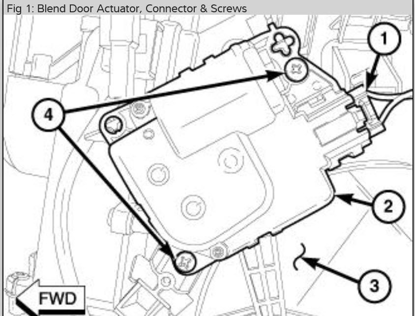

I need to know how to get to this actuator motor to replace it. heater blend actuator fresh air to recycled.
Aug 11, 2016 at 9:52 AM
HMAC300
CERTIFIED EXPERT
48,601 POSTS

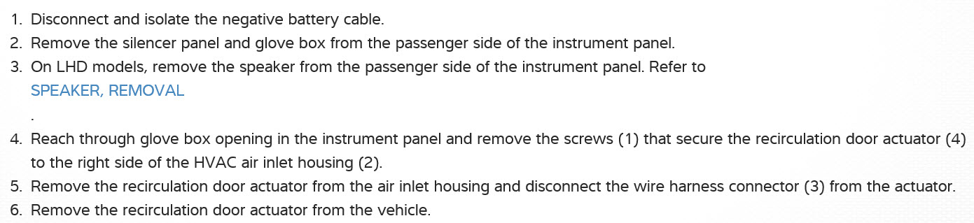

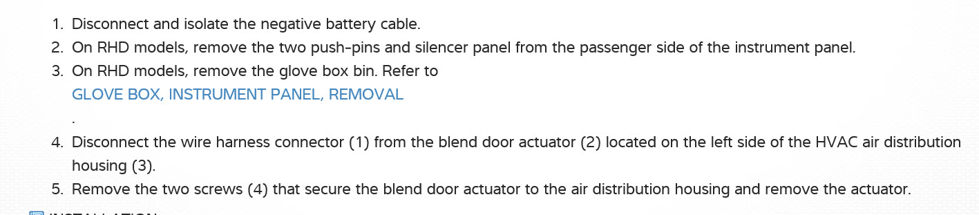

those are two different actuators one for blend and other for fresh air. try pulling HVAC fuse inside car first for 60 seconds with key on then reinstall they may reset. pictures show one actuator and removal for both.
