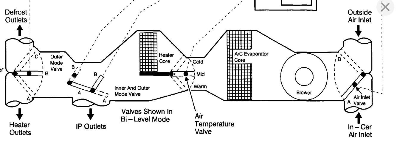

I have changed the blower motor and switches the blower motor works fine, but for some reason even on high the air barely flows out of the vents, no matter where I put the blend doors (I have even unhooked and operated them manually just to check) it has no change. I have checked the duct work as best i can and have not found any clogs. I am totally stumped. Please help

No just the motor, looking at the diagram it looks like the vent motor is by the driver? It have two actuators turning different doors right next to the passenger feet, no matter where they are set the heat still just barely blows.

Ok back at this lumina sir, i have checked fluid level n bled the coolant system, the new blower motor came with a new cage on it, still no matter what i do with the actuator doors it only blows thru the vent and very little when it does even with the blower on high, i cant see how to get inside the ductworking without taking the whole dash out of the car ( i really dont want to do this) im pullin my hair out on this

Okay, i was elbow deep in the box from where the blower mounts, all i can feel is open box and a couple messed up springs, i can't find what they go too no doors etc.,
