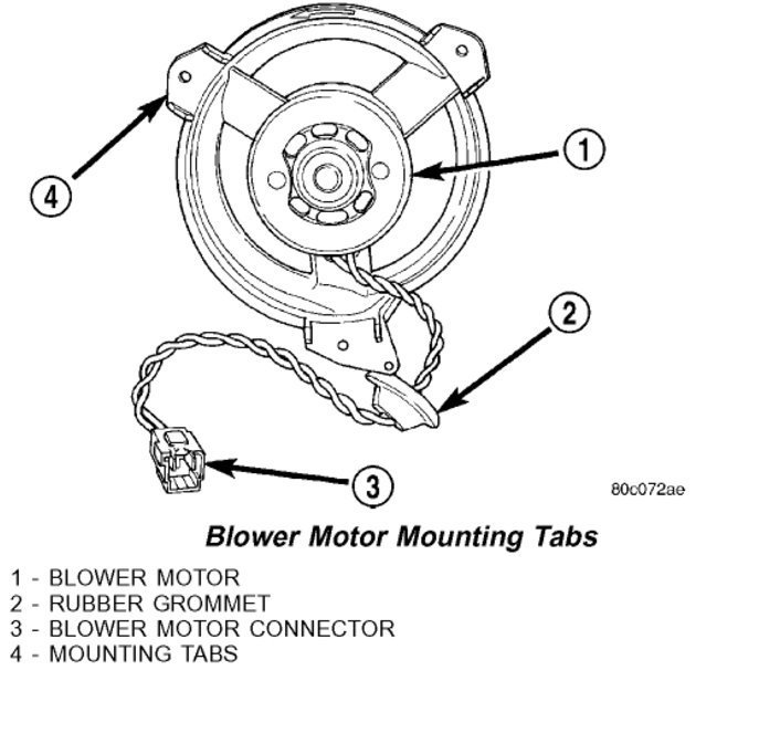

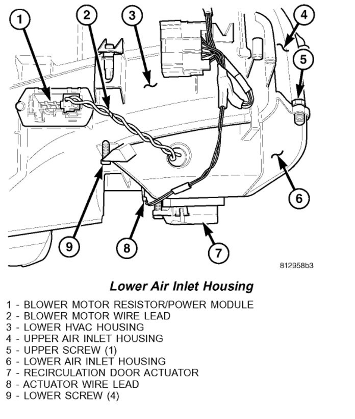

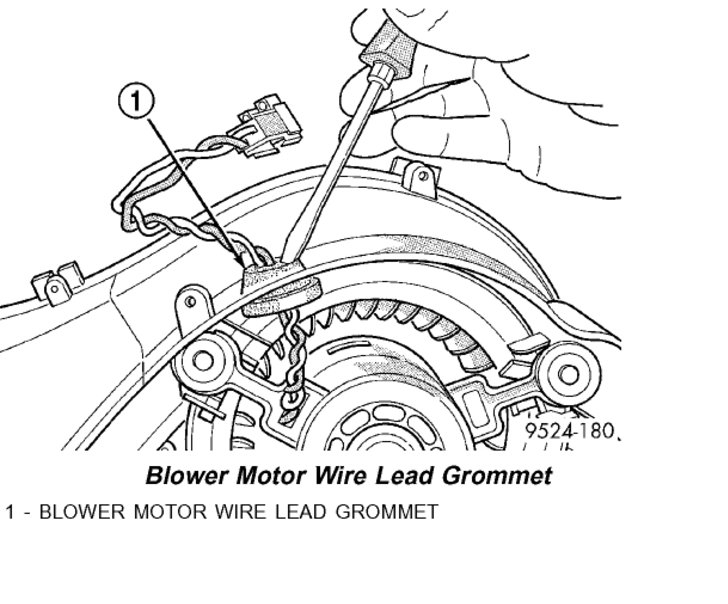

Its best to replace the motor once is starts making noise but you can try to lubricate it. Here is a guide that will show you what you are in for when doing the job and some diagrams (below) to help you get the job done.
https://www.2carpros.com/articles/blower-fan-motor-works-on-high-speed-only
