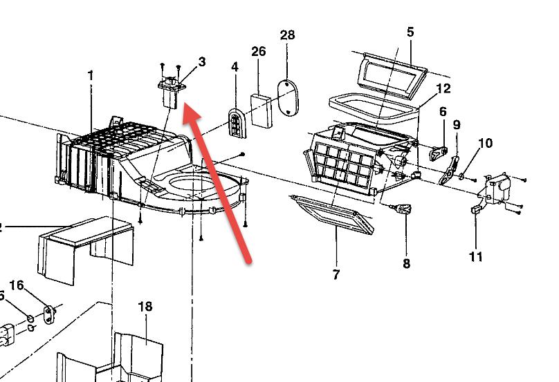

Fan only words on high not on low or medium speed
Jul 22, 2014 at 7:10 AM
HMAC300
CERTIFIED EXPERT
48,601 POSTS
check tosee if resistor is getting power if it is it's probably the resistor.
Image (Click to enlarge)
