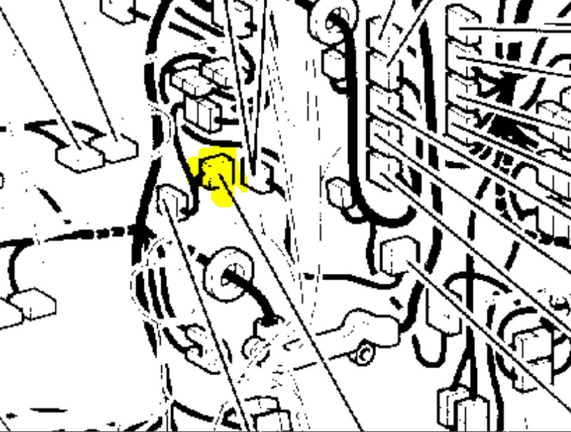

I attached a pic below to help locate the air temp servo (actuator).
Let me know if this helps.
Image (Click to enlarge)

Still little lost from the diagram. Found the recirculation servo and the one that changes what vent. Both are working. Is there a way to manually open the blend door?
Jan 12, 2020 at 4:06 AM
CERTIFIED EXPERT
110,175 POSTS
The only thing you could try is to remove the actuator and move the door. I enlarged the location hoping to make it easier to identify, but I think I made it worse. It is very close to center of the dash.

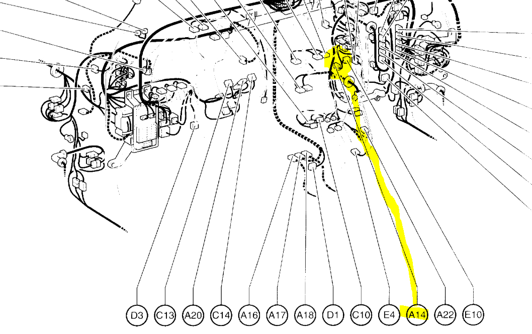

Jan 12, 2020 at 5:53 PM
GLBY
MEMBER
6 POSTS
Better. Thanks.
