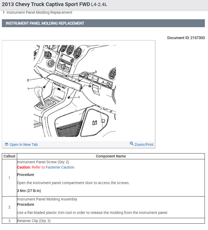

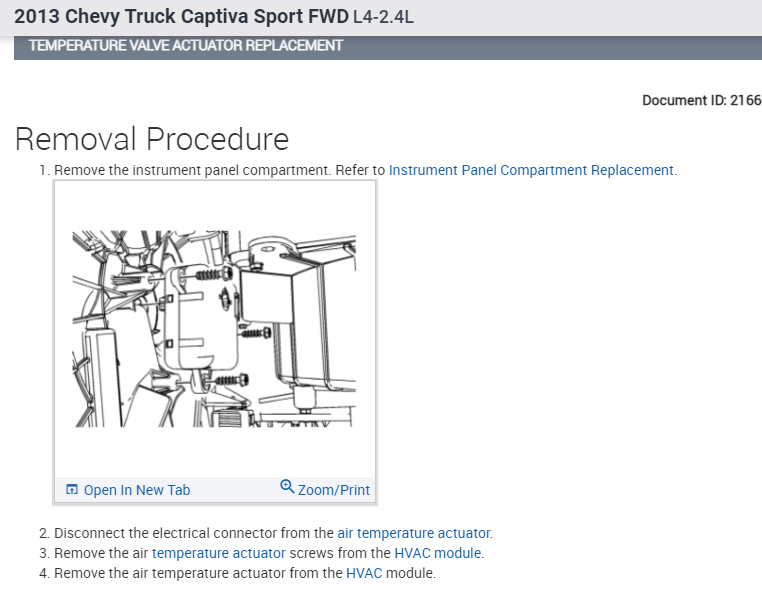

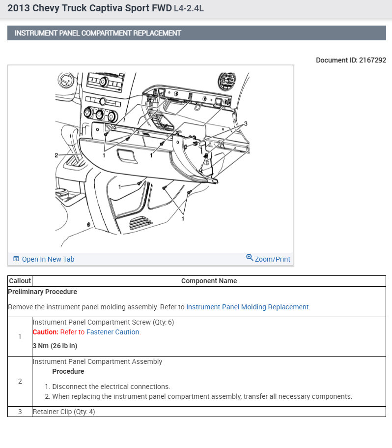

The blend door actuator is located behind the passenger side instrument panel.

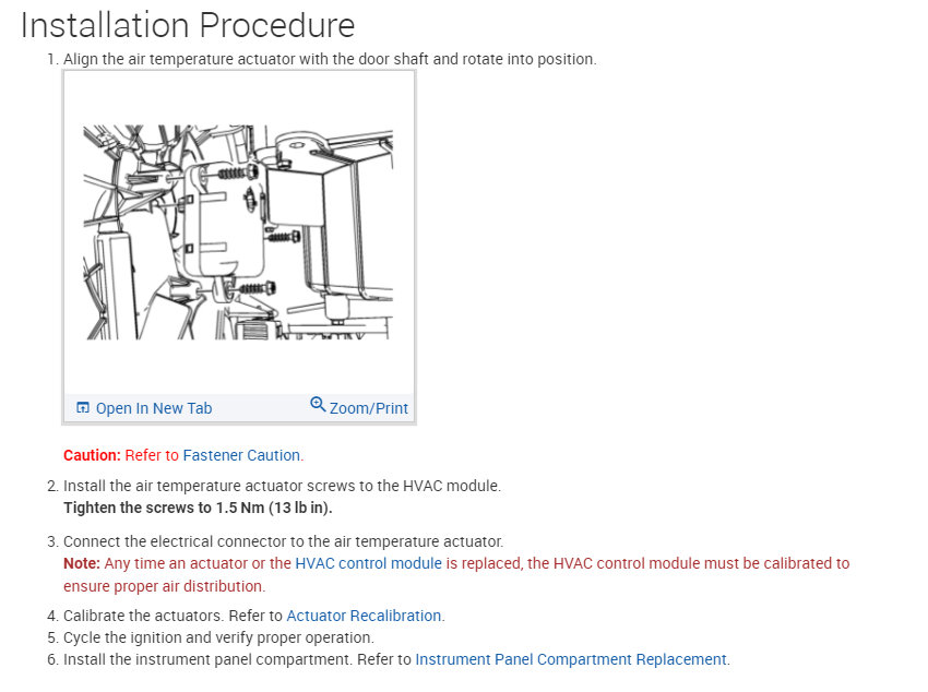

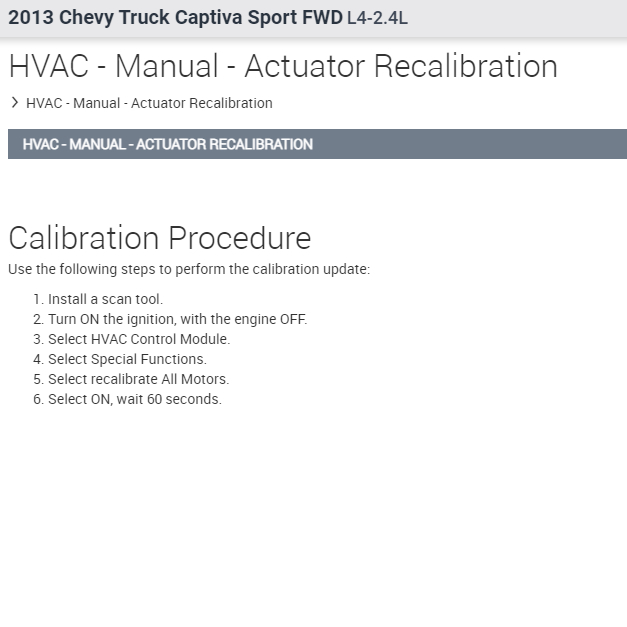

Keep in mind that if the actuator gets replaced, the new one will need to be programmed to the vehicle. Which will need a scan tool.
