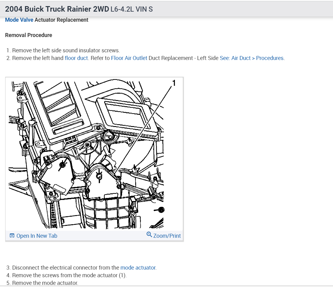

Heat does come out, then all of a sudden, the heat coming out of the vents turns cool while heat is still coming out of defrost. Then it will go back to hot air. There should not be any air coming out of vents because it's on defrost.
Nov 29, 2022 at 7:22 PM

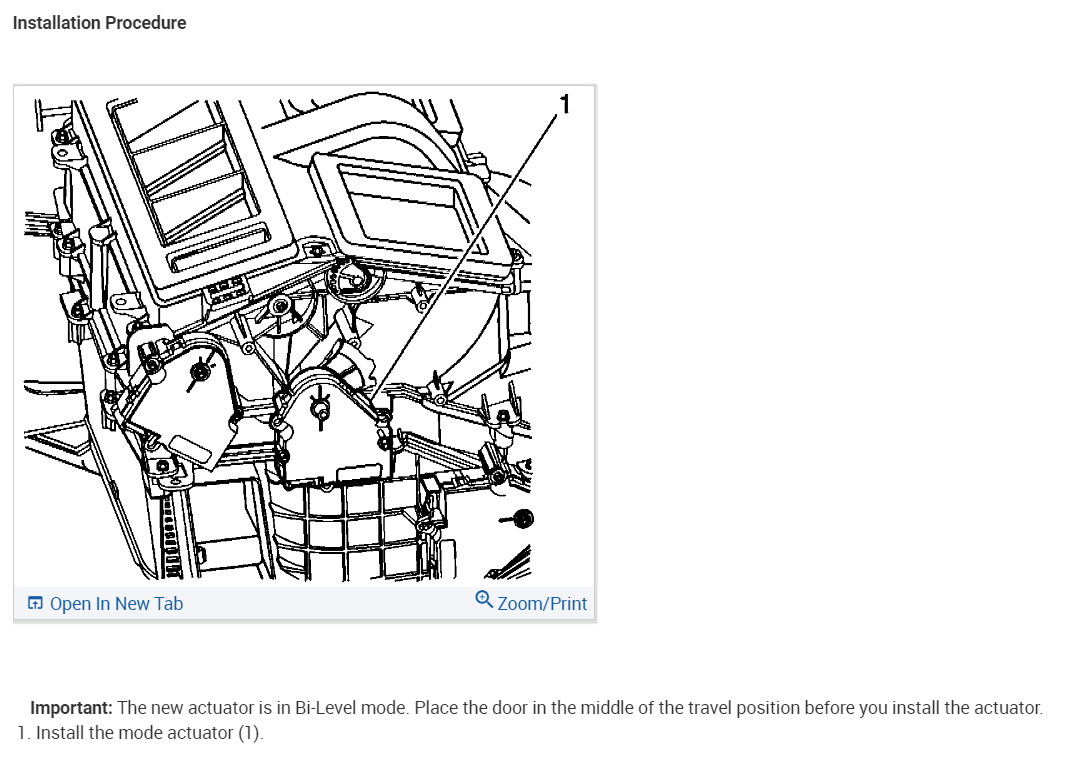

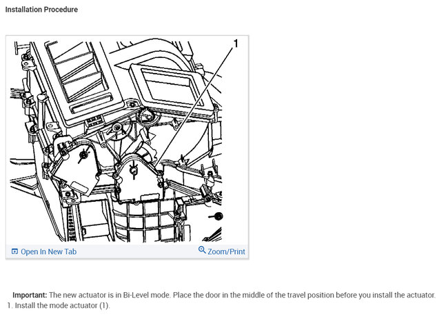

If the coolant is full, then it sounds like you have a mode control actuator that is out. here is the location so you can check it out and replace it to fix the problem. Check out the images (below). Please let us know what happens.
