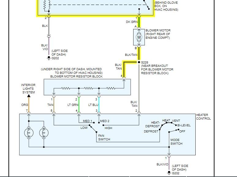

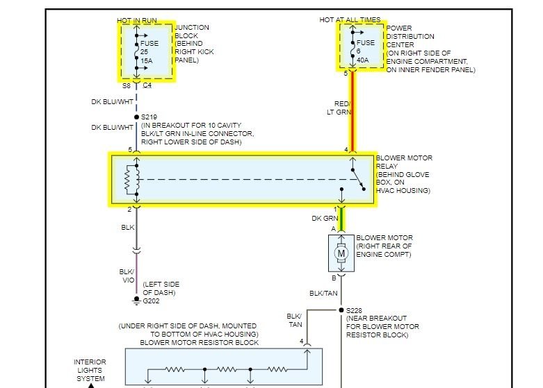

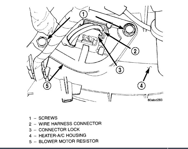

When I replaced my heater blower motor I went to hook it up and it wouldn't work when I plugged it in. it works when I hard wire it. When I drive down the road I feel a little heat coming through when I switch it to cold it blows cold when I got to change where it comes out like defrost feet etc., it does not change. when I have the blower motor plugged in like it's supposed to it does not blow at all when I turn it up or on. what could this be?
