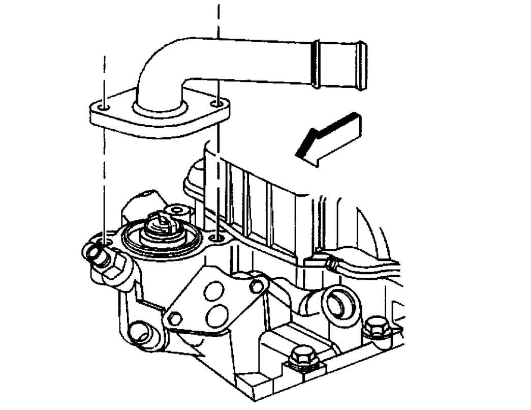

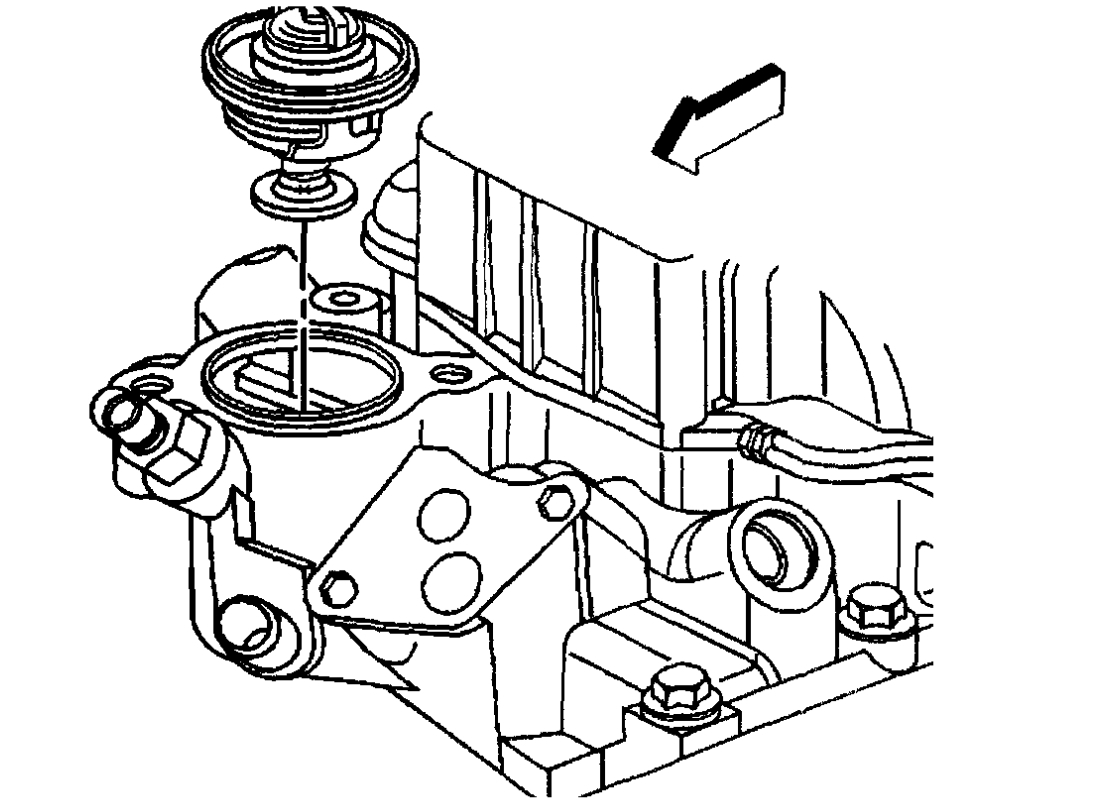

Thermostat Replacement
Removal Procedure
1. Partially drain the cooling system.
2. Remove the air cleaner outlet duct.

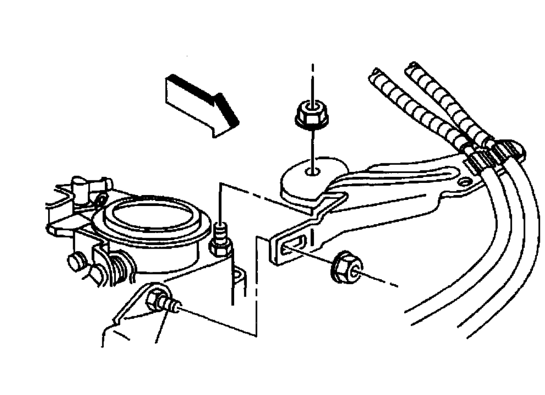

3. Remove the throttle body bracket nuts and reposition the bracket.

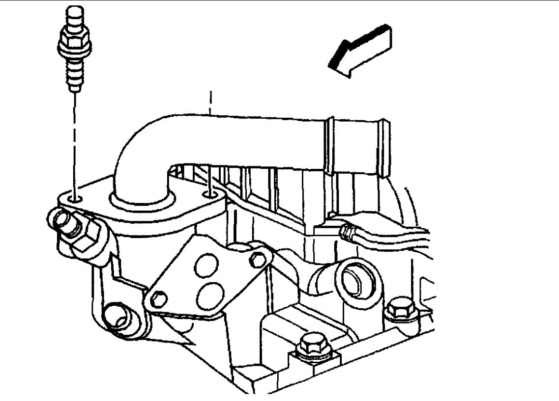

4. Remove the water outlet housing mounting bolts.
5. Remove the water outlet housing from the lower intake manifold and set aside.
6. Remove the gasket or O-ring.
7. Remove the thermostat.

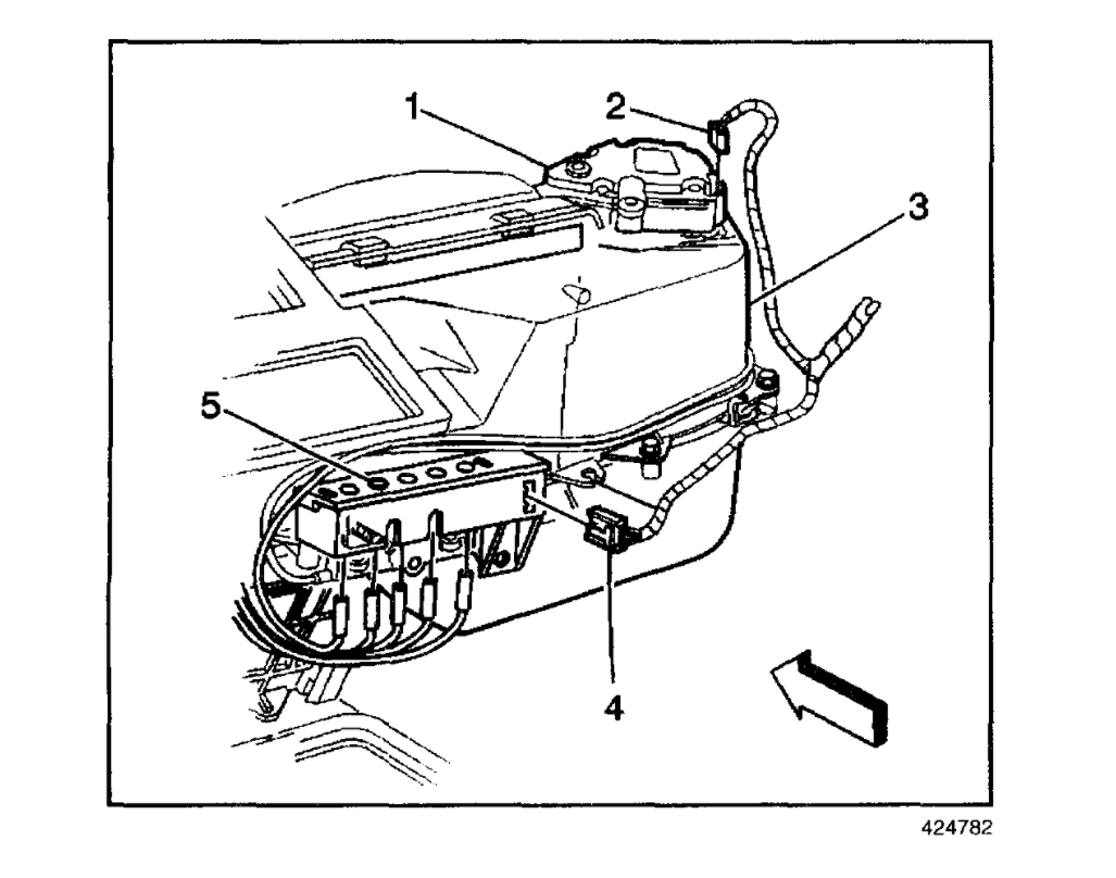

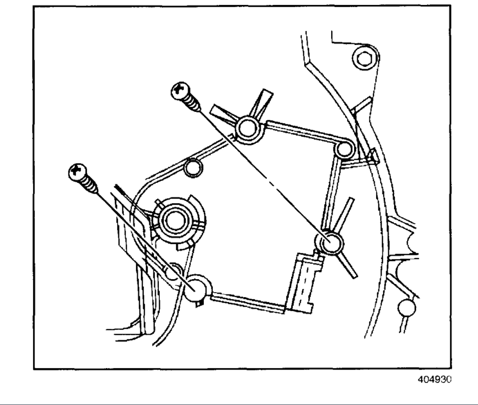

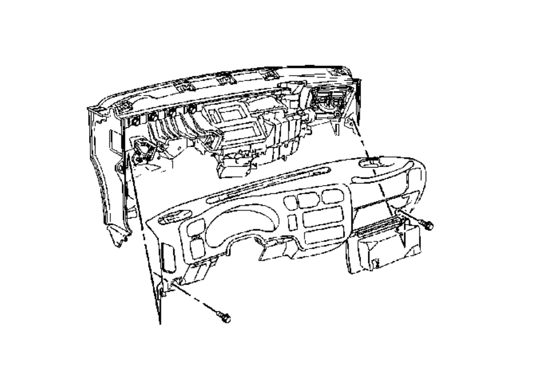

The air temperature actuator is located on the top right hand side of the HVAC module.

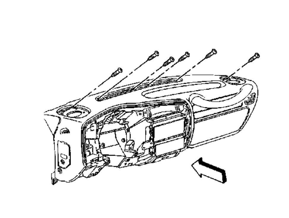

1. Remove the instrument panel carrier.
2. Disconnect the electrical connector (2).
3. Remove the air temperature actuator retaining screws.
4. Remove the air temperature actuator from the HVAC module.
IP Carrier Replacement
Removal Procedure
1. On vehicles equipped with a manual transmission, remove the shift lever. Refer to Control Lever and/or Boot Replacement in Manual Transmission - NV 1500.
2. On vehicles equipped with an automatic transmission, perform the following steps:
1. Apply the park brake.
2. Insert the ignition key and turn the ignition switch to the RUN position.
3. Depress the brake pedal and shift the transmission to the 1 position.
4. Turn the ignition switch to the OFF position.
Caution: Refer to Battery Disconnect Caution in Service Precautions.
3. Disconnect the battery negative cable.
Caution: Refer to SIR Caution in Service Precautions.
4. Disable the passenger side SIR system. Refer to Disabling the SIR System in SIR.
5. Remove the left sound insulator.
6. Remove the right instrument panel sound insulator.
7. If the vehicle is equipped with a multiple CD changer located in the center console, remove the center console. Refer to Console Replacement - Front Floor (Full Length (Auto Trans)) Console Replacement - Front Floor (Non-Full Length) Console Replacement - Front Floor (Full Length (Manual Trans)).
8. Remove the lower sound insulator.
9. Remove the lower left instrument panel mounting bolt.
10. Remove and retain the instrument panel storage compartment.
11. Remove the lower right instrument panel mounting bolt.
12. Remove and retain the left and right speakers and the speaker grilles.

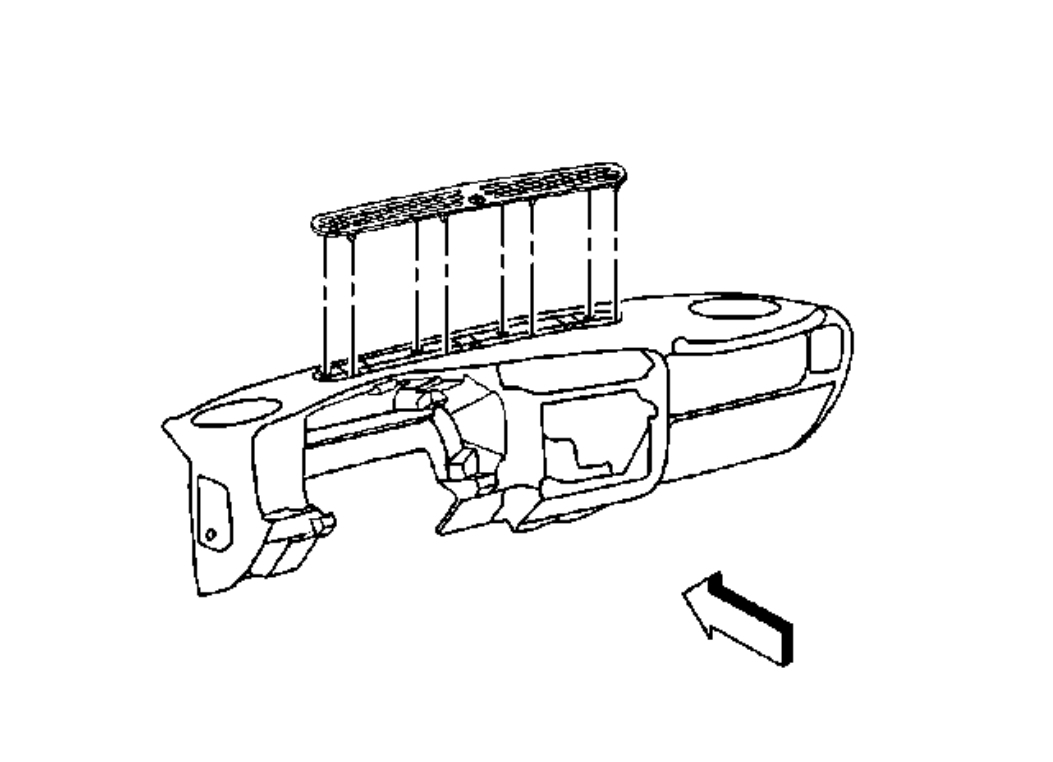

13. Use a flat-bladed tool to remove the windshield defroster grille. Retain the windshield defroster grille for use on the replacement IP carrier.
14. If the vehicle is equipped with a sunload sensor, twist the sunload sensor 1/4 turn counterclockwise in order to detach it from the windshield defroster grille. Retain the sunload sensor for use on the replacement IP carrier.
Important: Always disconnect the brown electrical connector from the BCM before disconnecting the purple electrical connector from the BCM.
15. Disconnect the brown electrical connector from the body control module (BCM).
16. Disconnect the purple electrical connector from the body control module (BCM).
17. Remove the knee bolster.
18. Remove and retain the instrument panel cluster.
19. Remove and retain the radio.
20. Remove and retain the HVAC control assembly.

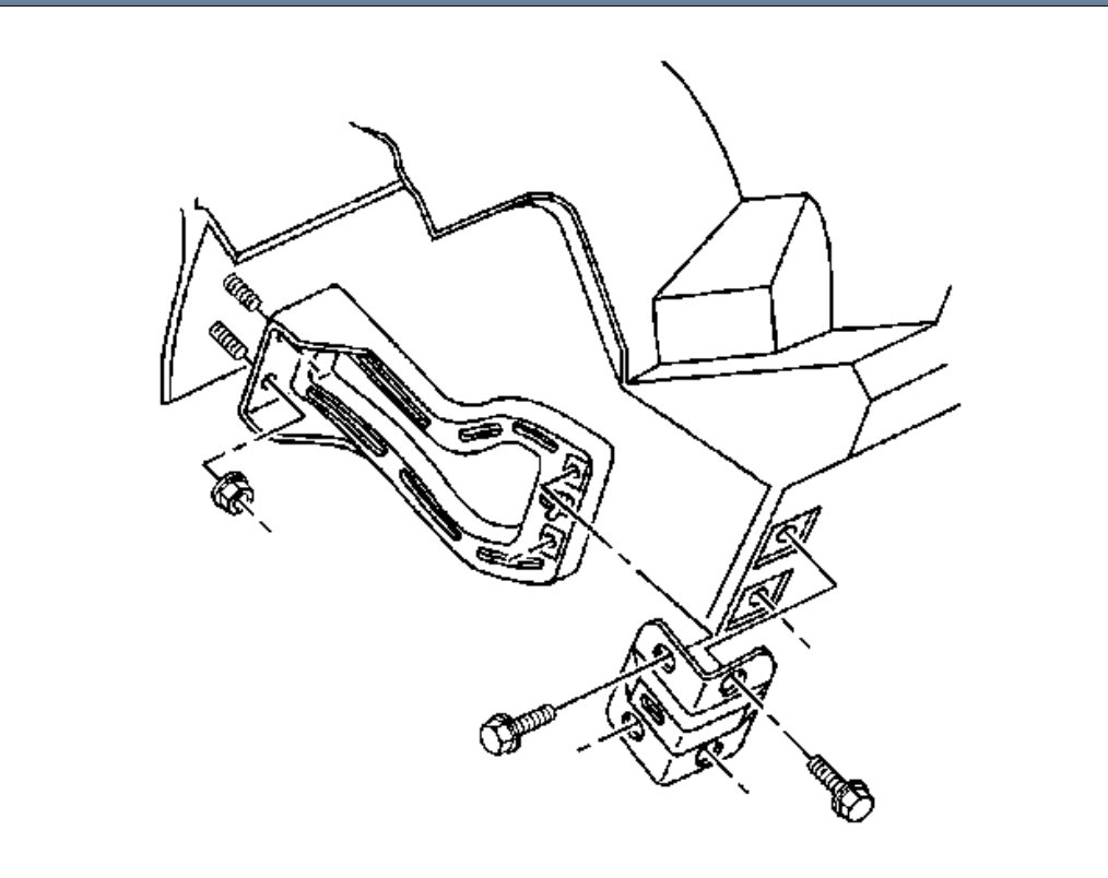

21. Remove the left and right instrument panel driver knee bolster brackets.
22. Lower the steering column for clearance. Refer to Steering Column Replacement in Steering Wheel and Column.
Important: Label all of the connections in order to avoid improper installation.
23. Remove the top instrument panel screws.
24. Roll the instrument panel down.
25. Disconnect the electrical connections, as needed.
26. Remove the fastener that retains the radio antenna cable to the instrument panel.
27. Remove the instrument panel from the vehicle.
28. If replacing the instrument panel carrier, retain parts for assembly onto the new instrument panel carrier.
