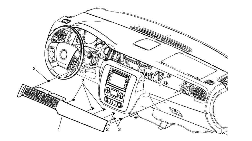

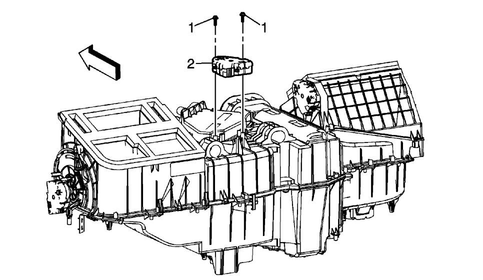

I attached the location of the blend door actuator for the passenger side along with the procedure.
I still think you have a clogged heater core. You should remove both hoses and flush the core with your garden hose. Flush back and forth several times until you get an even flow from both sides.

Did you read the procedure I sent you?
You remove the top cover and it is right there.

Not on a 2007 Yukon. Can remove the trim around the radio and temperature controls and remove radio and temperature controls and it is not accessible from there.
Oct 29, 2018 at 12:59 PM

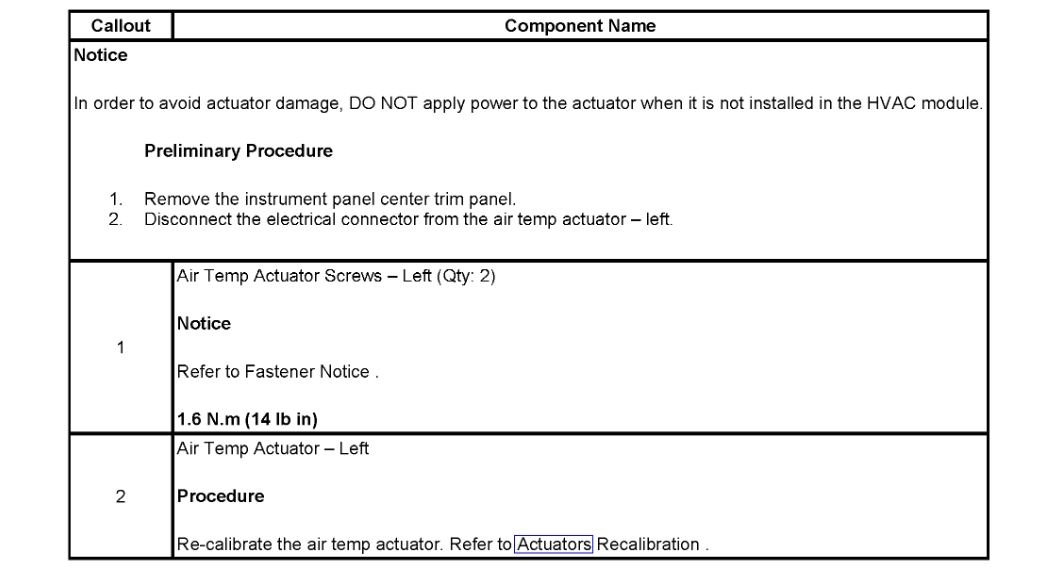

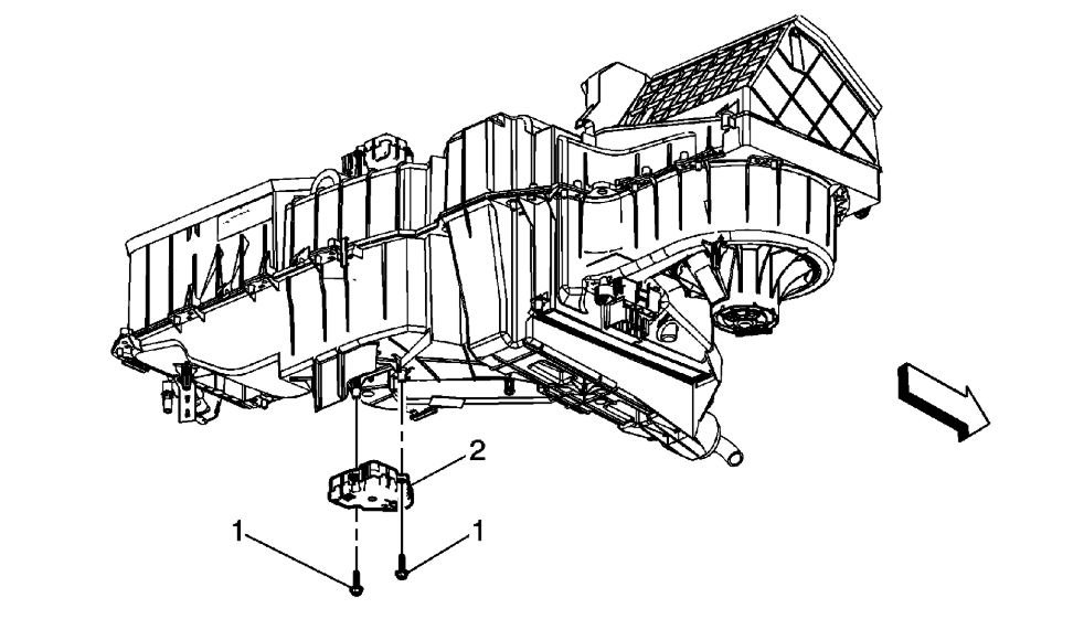

This is what it shows on my Alldata.
Oct 29, 2018 at 1:06 PM
