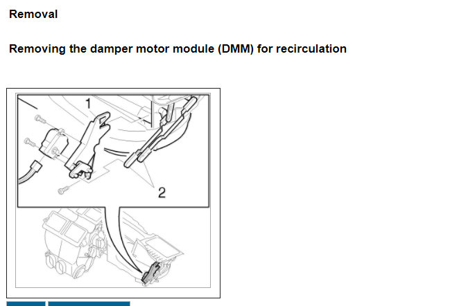

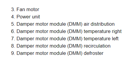

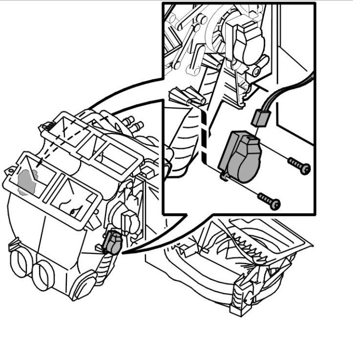

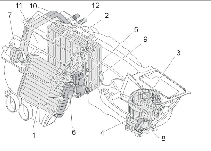

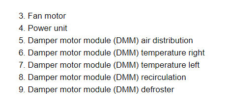

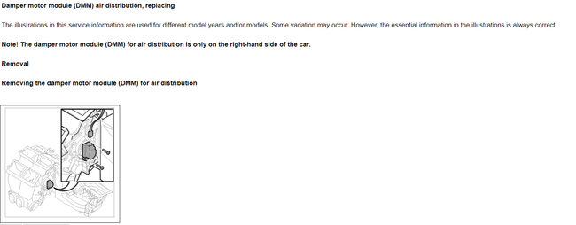

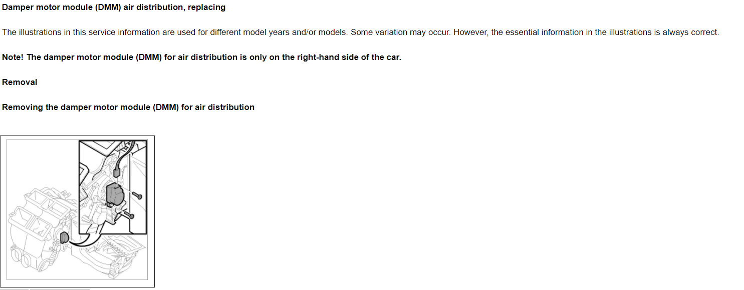

It sounds like you have a temperature blend door actuator that needs replacing. Here is a guide to show you what you are in for when doing the job:
Below are all of the blend door actuators just in case you want to see how the system works.
Check out the diagrams (below).
Jan 20, 2018 at 1:06 PM
