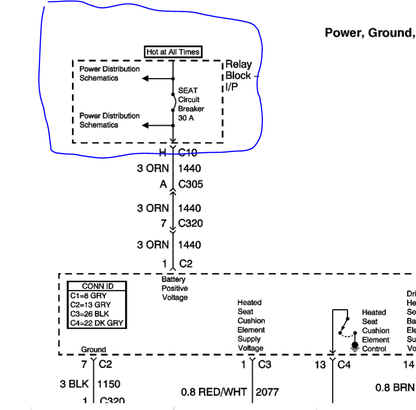

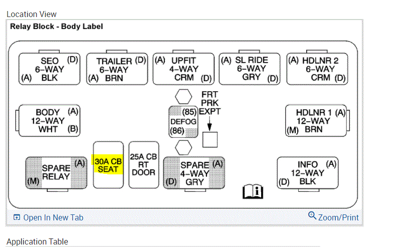

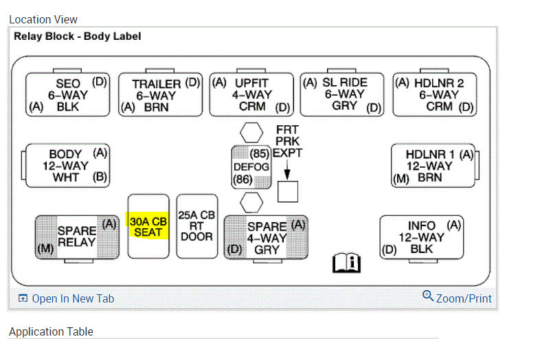

If they both started having the same problem at the same time, I suspect the circuit breaker is weak and may need to be replaced. There is a 30 amp circuit breaker under the dash. The idea that it runs for 20 seconds and then turns off, either the CB is bad, the switch can't handle the load anymore, or we have a short.
If you look at pic 1, it shows a portion of the wiring schematic. I circled the power supply and pic 2 shows the circuit breaker location in the relay block.
Check to see if the relay is getting extremely hot when the seats are on. If it is, try replacing it. If it doesn't, let me know.

Okay, I started it up turned on the drivers back heat button and hand on that 30Amp fuse did not get hot turned off after 10 seconds. but when I pressed the seat bottom or both button it shut off soon as I let go of button hand still on fuse didn't get hot. tried another spare switch I had that is good off another truck and did exact same thing. so reinstall original switch.
Dec 11, 2020 at 7:58 AM
Okay, if the circuit breaker is kicking, then here is what I want you to try. Disconnect one seat at a time and try the opposite seat to see if it still happens. Hopefully, it will narrow things down.
If you can determine it to be one specific seat, disconnect it and check the resistance between the power supply wire (disconnected from power) and ground. Let's see if there is a short to ground or if there is extensive resistance in the component.

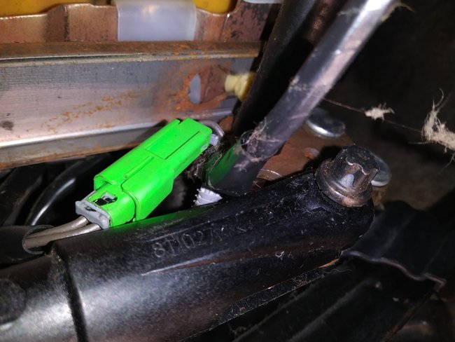

Okay, I need to know if I am testing correct wires and connectors. I did test both power orange+ and black on main bigger plug behind the seats. I get 12 volts on both seats. Need a bit more info on testing correct wire color and plug. I may have found the back heating element if the plug is green 2 wires one brown and one black wire. but that's as far as I got. Okay, got to both heating element plugs on the passenger side I took a ohm reading and got 29.3 on the white plug brown and black wires on the drivers side I got 11.3. so hoping this is correct way to check the heating elements.

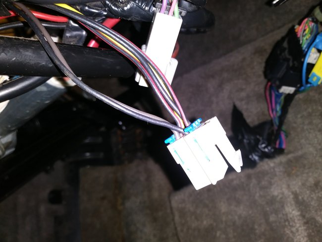

I think I found the element wire colors to take a OHM reading on the white plug in pic. I believe the back seat element would be on the yellow C and black D and the bottom cushion element would be brown A and black B on my wiring diagram. is this correct? What would be correct OHM reading on the elements or just open or closed loop?? please let me know. thanks

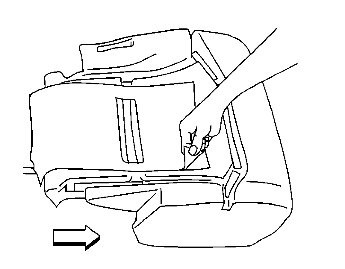

If you find it is the element which is bad, here are the directions for replacement. The attached pics correlate with the directions.
2003 GMC Truck K 1500 Yukon XL 4WD V8-6.0L VIN U
Seat Back Heater Element Replacement - Front
Vehicle Body and Frame Seats Seat Temperature Element Service and Repair Removal and Replacement Seat Back Heater Element Replacement - Front
SEAT BACK HEATER ELEMENT REPLACEMENT - FRONT
REMOVAL PROCEDURE
1. Remove the seat from the vehicle.
2. Remove the seat back trim cover.
pic 1
3. Peel the seat back heater off the foam pad.
4. Disconnect the seat back heater harness.
INSTALLATION PROCEDURE
pic 2
1. Connect the seat back heater harness.
2. Install the seat back heater.
3. Install the seat back trim cover.
4. Install the seat in the vehicle.

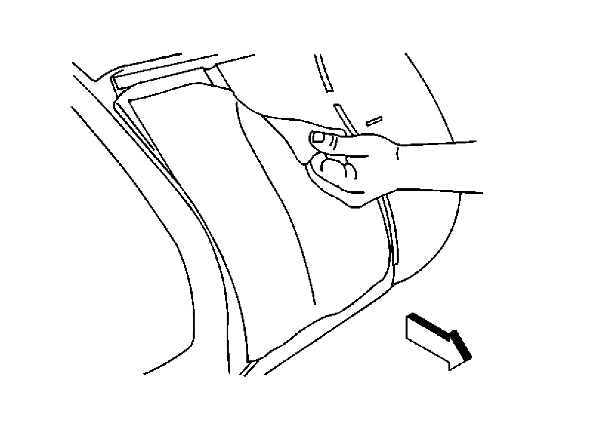

Seat Cushion Heater Element Replacement - Front
Vehicle Body and Frame Seats Seat Temperature Element Service and Repair Removal and Replacement Seat Cushion Heater Element Replacement - Front
SEAT CUSHION HEATER ELEMENT REPLACEMENT - FRONT
REMOVAL PROCEDURE
1. Remove the seat trim panel.
CAUTION: If the passenger seat cushion foam is damaged when you remove the heater element, replace the passenger pressence system in order to prevent personal injury.
2. Remove the seat cushion trim cover.
pic 3
3. Peel the seat cushion heater off of the pad.
4. Disconnect the seat cushion heater wiring harness.
1. Replace the inflatable restraint passenger presence system if the passenger seat cushion foam is damaged.
pic 4
3. Install the seat cushion heater.
4. Install the seat cushion trim cover.
5. Install the seat trim panel.
6. Re-zero the inflatable restraint passenger presence system for the front passenger seat.
