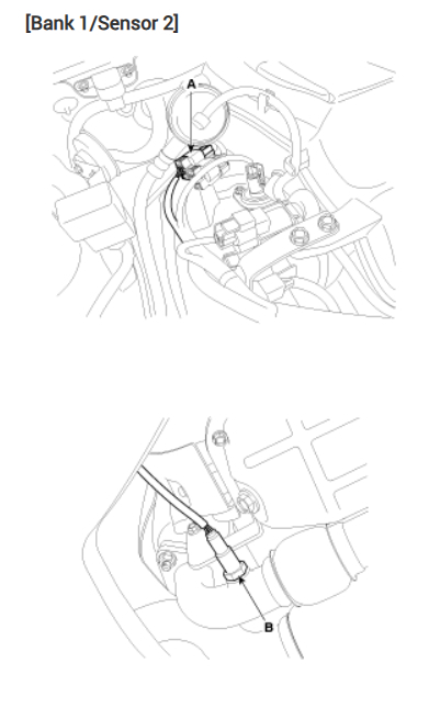

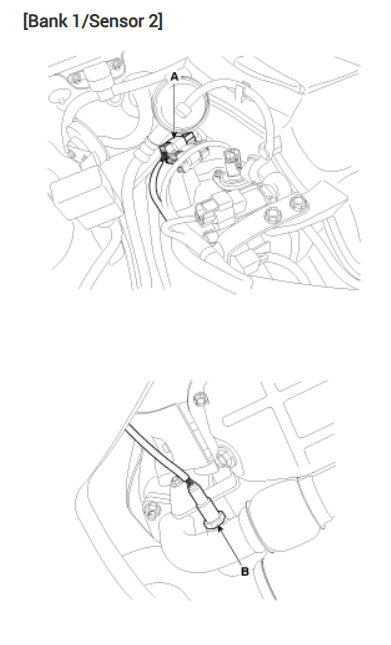

Where exactly is bank 1 senor 2 located on my '19 V6 AWD sorento?
Mar 6, 2026 at 4:57 PM
Hello, I can help you, the Bank 1 sensor 2 is located at the rear of the catalytic converter which is part of the exhaust manifold on the right side of the engine nearest the firewall. Check out the images (below). Let us know if you need anything else.
