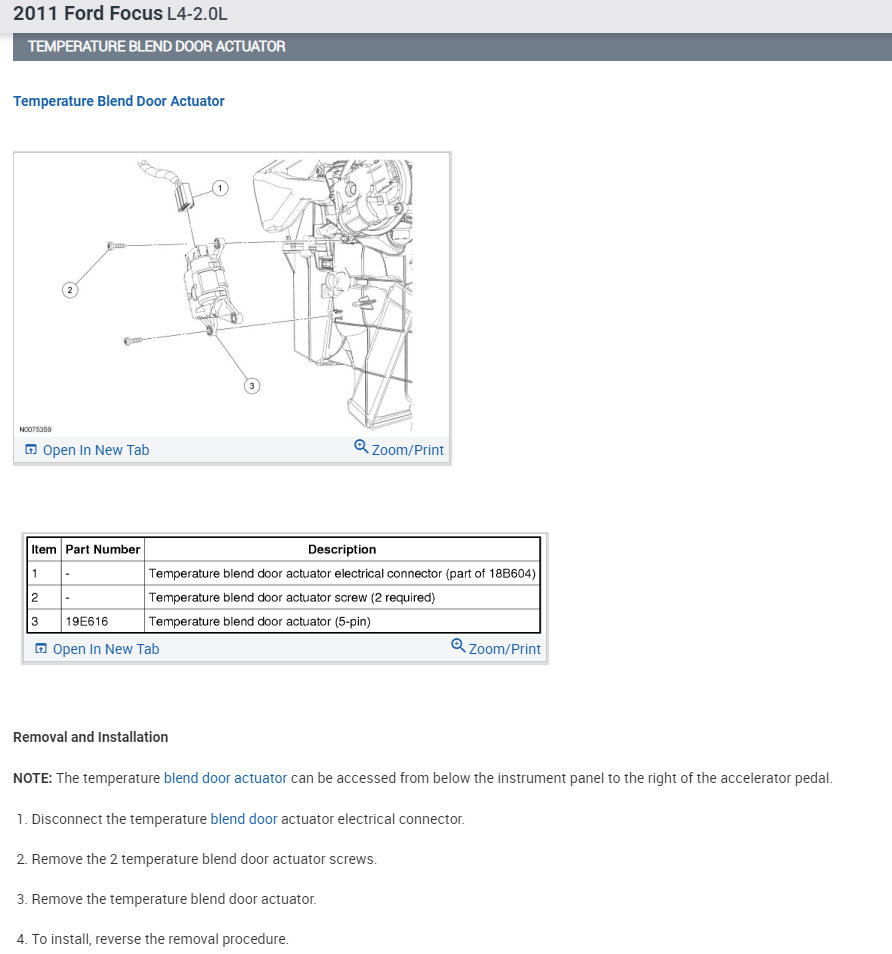

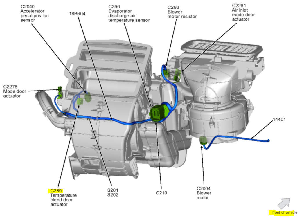

On your vehicle the blend door actuator can be accessed from under the driver's side dash, next to the accelerator pedal.
I have attached diagrams/instructions below for your reference.
