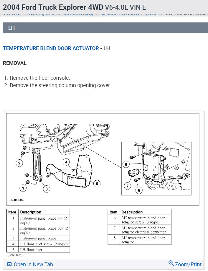

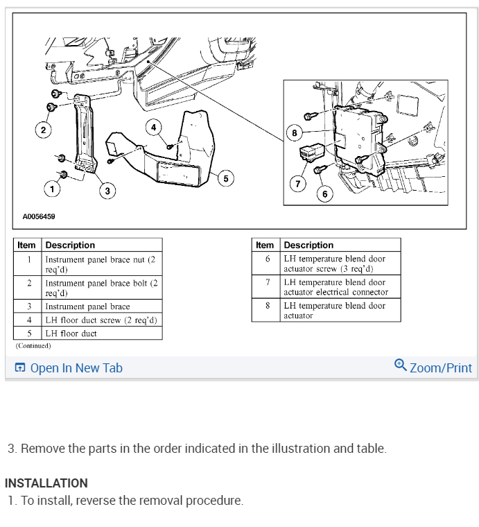

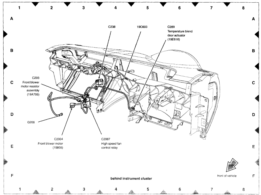

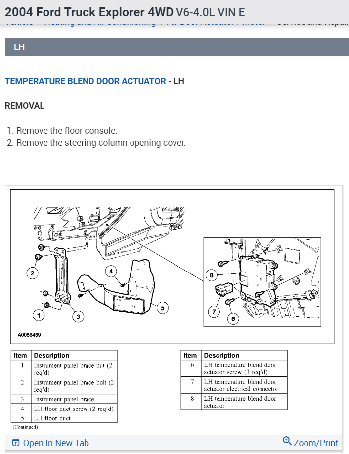

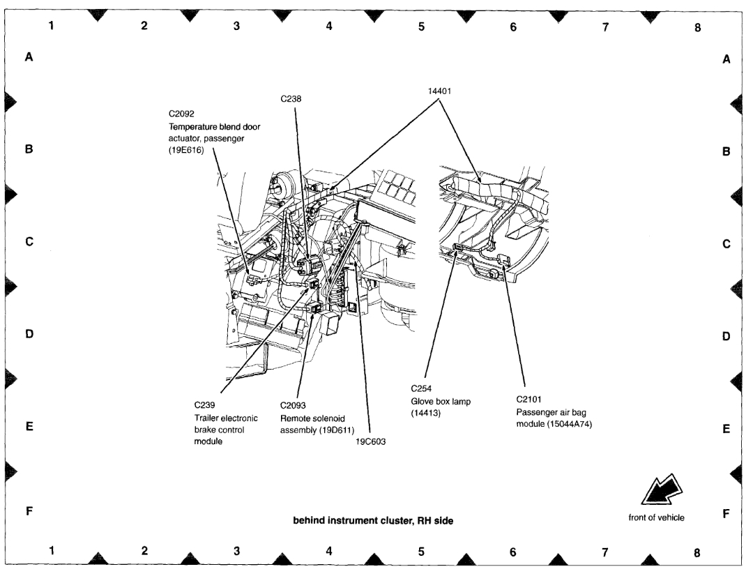

Even though it is a single system it uses two temperature blend door actuators. Here are the locations of both and how to change the driver's side out, which sounds like it is bad.
Check out the images (below). Please let us know how it goes.

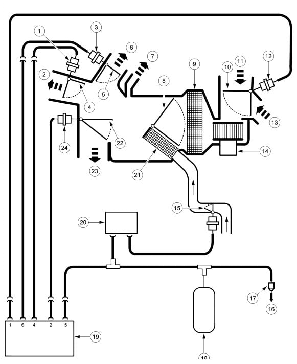

i need to know where #24 is located.
Oct 29, 2023 at 5:48 AM
BROKENEXPLORER
  • 13 POSTS
this door / flap does not move in any control position, heat, A/C, vent, defrost. There is plenty of hot air behind it, but it can't get past it. what is this door and should it be controlled somehow. it's at the very bottom of the HVAC, floor heat comes out of this opening.
Oct 29, 2023 at 7:22 AM

I can't find any lever or way that door can be moved with an actuator. It's spring loaded and I can push it with my finger, but I see nothing sticking out the side of the housing that would connect to an actuator. Any diagrams or help will be appreciated.
Oct 30, 2023 at 12:30 PM
BROKENEXPLORER
  • 13 POSTS
The door i'm talking about is under the blend door, in front of the heater core. I believe the door opens to allow air to pass through the heater core. When the door is closed air passes over the heater core.

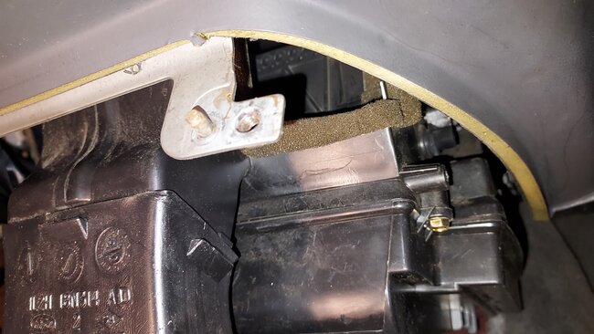

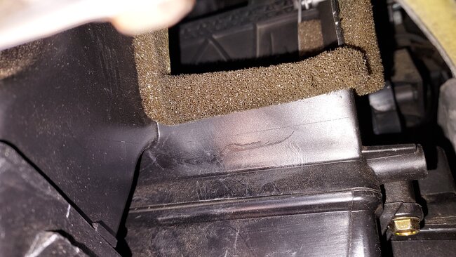

Thanks for the advice, I've been looking at YouTube videos and digging around under the dash and found the problem. I found the air recirculate door fell off the arm and was laying on top of the fan. This blocked most of the air flow through the system. I just removed it, not sure i need to put it back in place. for now, i'm just going to gorilla tape over the recirculate intake vent side so the outside air can't come straight in behind the glove box. I hope this will solve the issues.

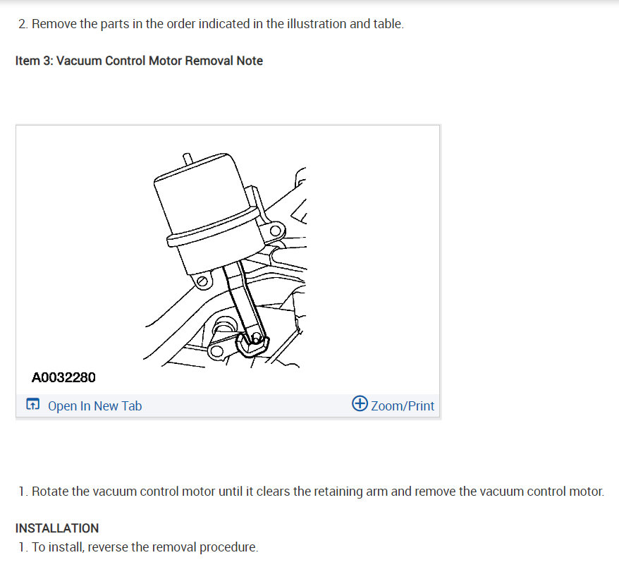

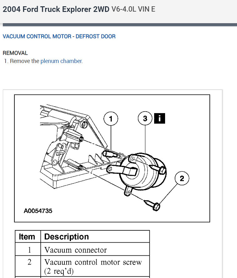

Hi Ken, thanks for all the great advice. still, something not right. Do you have any information on where the defrost vacuum actuator is located on the driver's side? I'm trying to trace where the yellow vacuum line goes from the HVAC door mode selector.
Feb 6, 2024 at 8:03 AM
The defrost vacuum actuator works for both sides, it is not controllable from side to side. it sounds like something is stuck inside the HVAC plenum not allowing the door to work freely. Here is the location of the defroster actuator so you can check it out. Check out the images (below). Let us know what you find.
