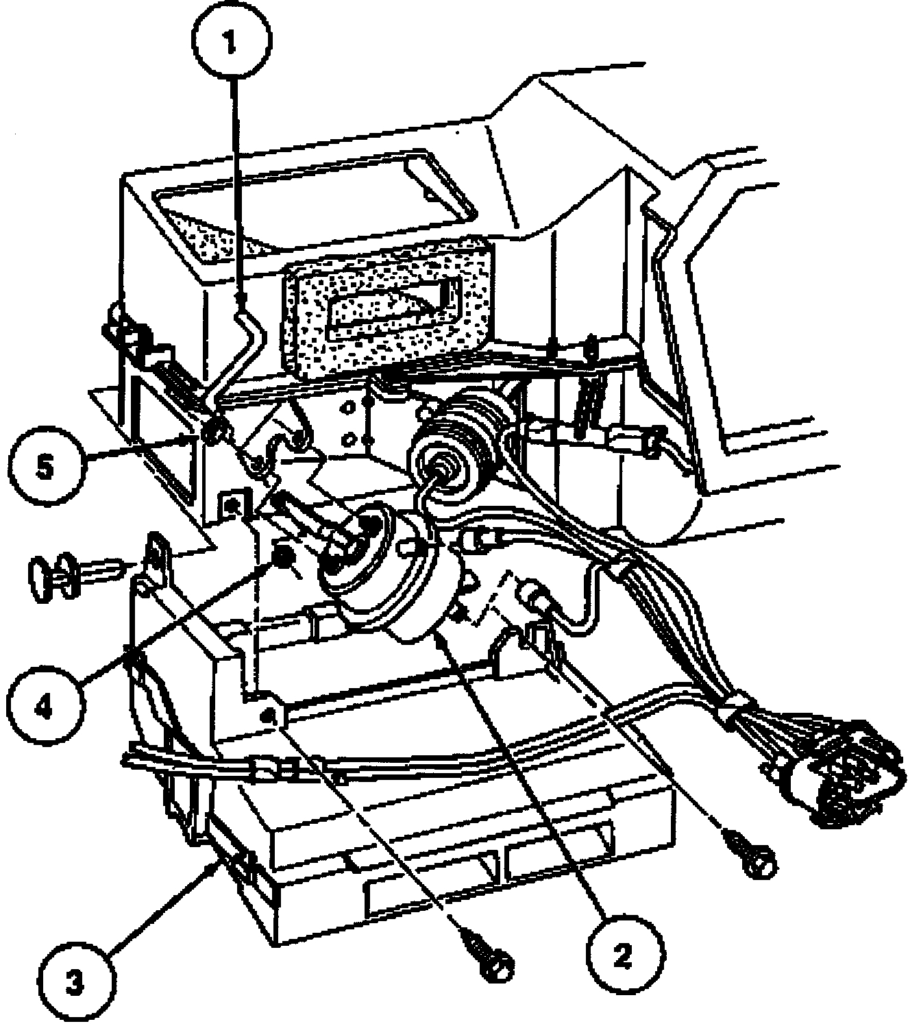

Here are the directions for the removal and replacement of the one specific to your vehicle. The attached pic correlates with the directions.
__________________________
1994 Lincoln Town Car V8-281 4.6L SOHC
Blend Door
Vehicle Heating and Air Conditioning Air Door Service and Repair Procedures Blend Door
BLEND DOOR
Doors
A/C Air Temperature Control
Removal
1. Remove the heater air plenum chamber from the vehicle as outlined.
2. Remove blend door actuator crank arm.
3. Move the A/C air temperature control door to the full heat position. Remove one screw retaining the A/C air temperature control door to the crank arm.
4. Remove the A/C air temperature control door from the crank arm and remove the door from the dash panel inlet opening of the heater air plenum chamber.
Installation
1. Position the A/C air temperature control door through the dash panel inlet opening of the heater air plenum chamber and to the door crank arm.
2. Install one screw to attach the A/C air temperature control door to the crank arm.
3. Check the A/C air temperature control door for freedom of movement. Correct any existing sticking, binding or grabbing condition.
4. Install A/C electronic door actuator motor if removed.
5. Install the heater air plenum chamber in the vehicle as outlined.
6. Check the system for proper operation.

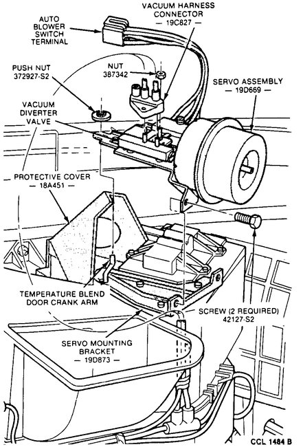

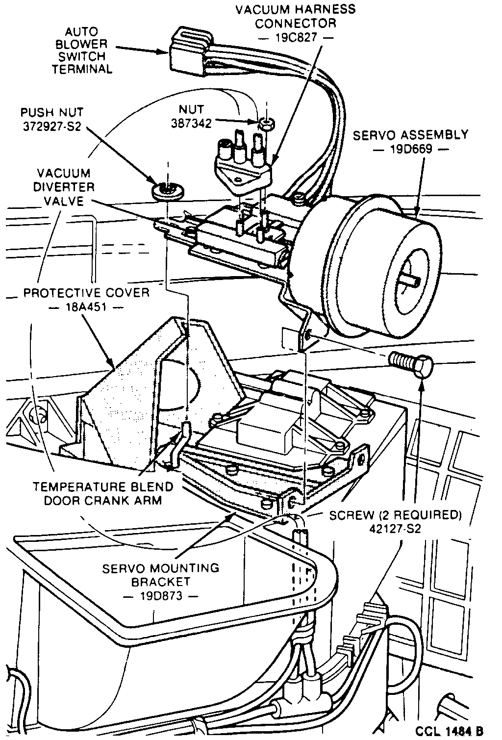

Here is a link that shows in general how to replace a blend air door actuator:
If you determine the problem is the actuator, here are the directions specific to your vehicle for replacing the actuator which I mentioned. Note that the actuator on your vehicle is vacuum actuated. Make sure it is getting vacuum.
WITH AUTOMATIC TEMPERATURE CONTROL
REMOVAL
1. Disconnect the battery ground cable.
2. Disconnect the glove compartment door stop (one screw) and let the door hang by the hinges.
Servo Motor Assembly See Pic 1
3. Remove the vacuum hose from the servo motor and unplug the electrical harness connectors.
4. Remove the two screws from the servo motor assembly mounting bracket and position the servo for access to the vacuum diverter valve.
5. Remove the retaining pushnut and vacuum connector clip, unplug the multiple vacuum connector from the vacuum diverter valve.
6. Remove the pushnut that retains the servo motor overtravel spring and arm link to the blend door crank arm. Remove the servo assembly from the vehicle.
INSTALLATION
1. Connect the servo motor overtravel spring and arm link to the blend door crank arm. Install a new pushnut.
2. Connect the multiple vacuum connector to the vacuum diverter valve and secure it with a vacuum connector and a new retaining pushnut.
3. Position the servo motor and install the two mounting screws.
4. Connect the vacuum hose to the servo motor and connect the electrical connector to the harness.
5. Replace the glove compartment door stop screw.
6. Connect the battery ground cable.
NOTE: On vehicles equipped with Electronic Engine Control (EEC), when the battery has been disconnected and reconnected, some abnormal drive symptoms may occur while the EEC processor relearns its adaptive strategy. The vehicle may need to be driven 10 miles or more to relearn the strategy.
7. Check the ATC system for proper operation.
I hope something here helps. Let me know if you have other questions.
