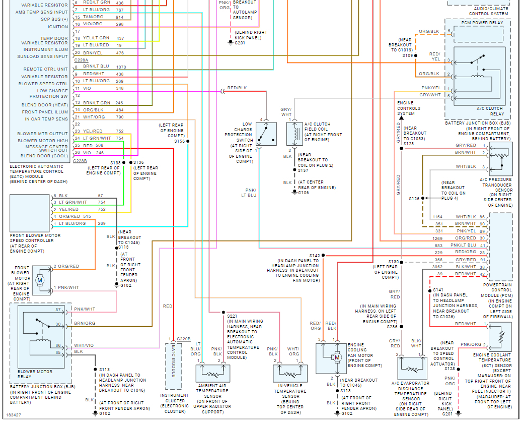

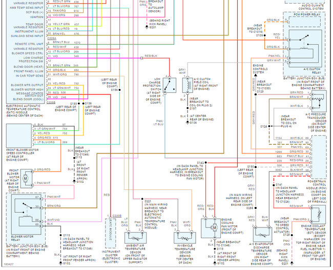

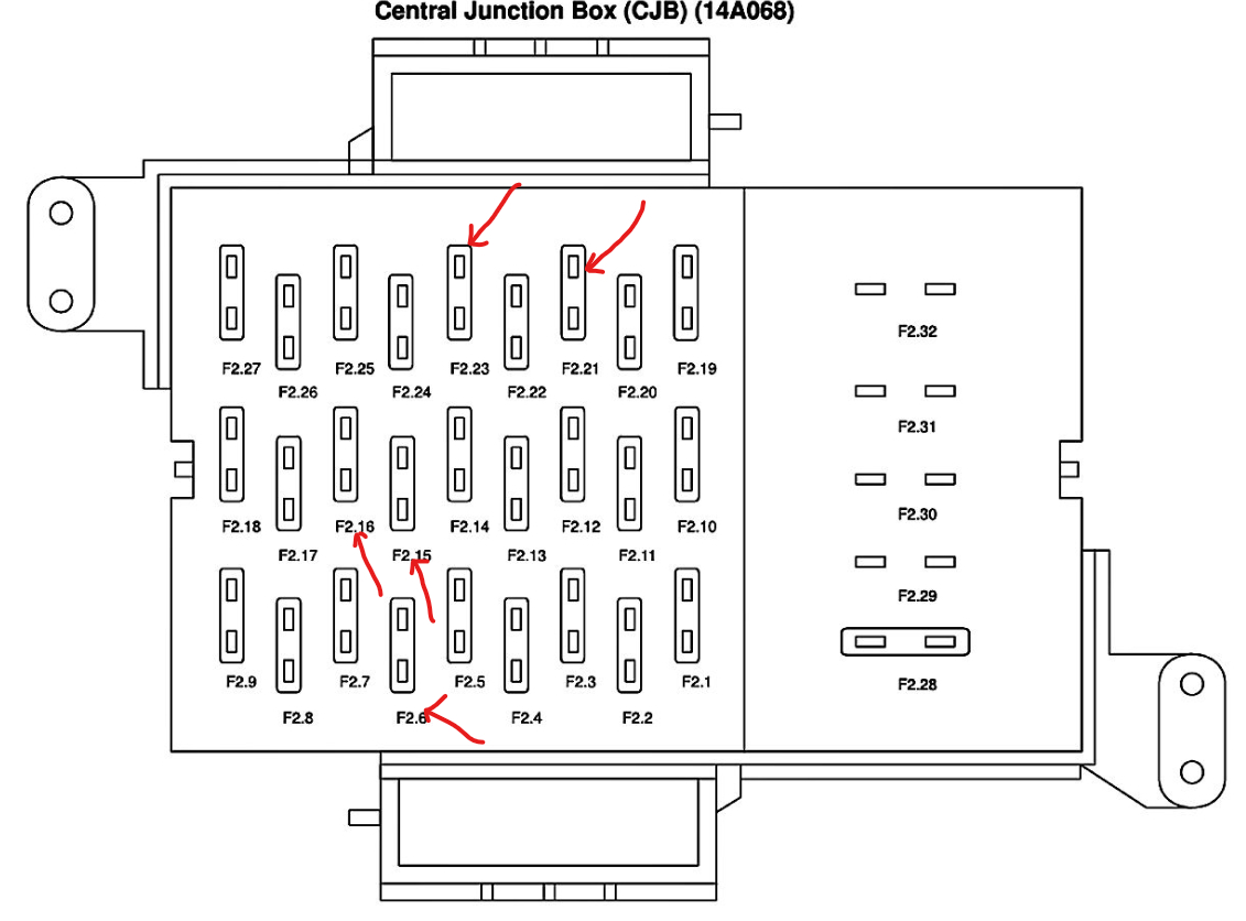

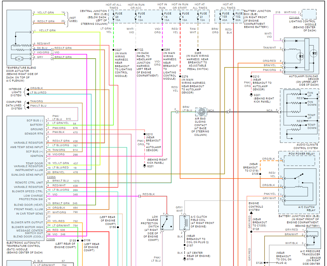

The signal is produced by the HVAC controller which you said you replaced, but there are five fuses we need to check in the fuse panel below the left side of the dash. The fuses are # 23, 15, 16, 6 and 21. here is a guide to help you and the fuse locations. I also have included the HVAC system wiring diagrams so you can see how the system works.
Check out the images (below). Let us know how it goes.
