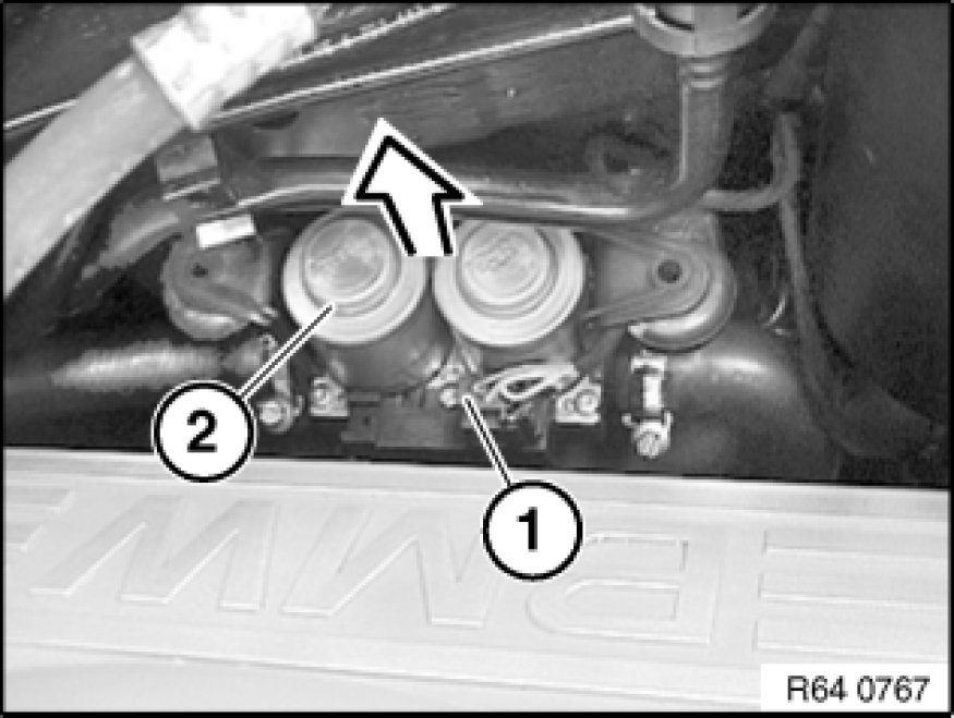

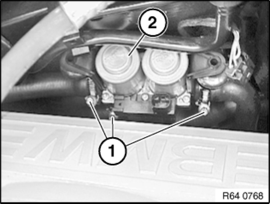

Note: To be sure the valve is the problem, turn the heater on high and allow the engine to warm up. Next, look at picture 2. You will see the solenoid and where two heater coolant hoses connect. One is on each end. Once the engine is warm and the heater is on, feel both hoses. If you find one is hot and the other isn't, replace the valve.
_____________________________________________________
64 11 274 - Replacing water valve for heater (automatic A/C High)
See Picture 1

See Picture 2
Disconnect plug connection (1).
Installation Note:
Ensure correct cable routing.
Pull out heater valve (2) upwards slightly.

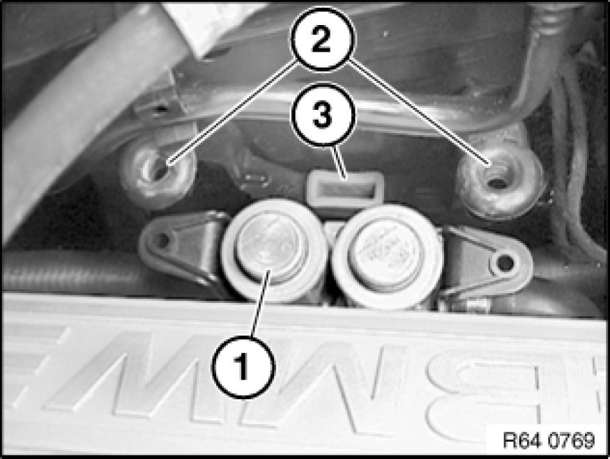

See Picture 3
Release hose clamps (1) and detach water hoses.
Remove water valve for heater (2).
