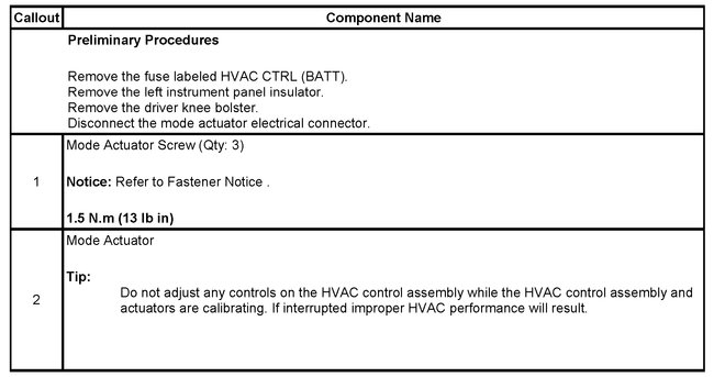

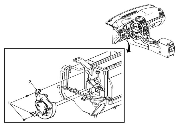

Next, as far as no defroster, do you mean the air flow direction won't change? If so, that would be related to the mode door actuator. Take a look at the two pictures I attached. They show the actuator replacement procedure.
