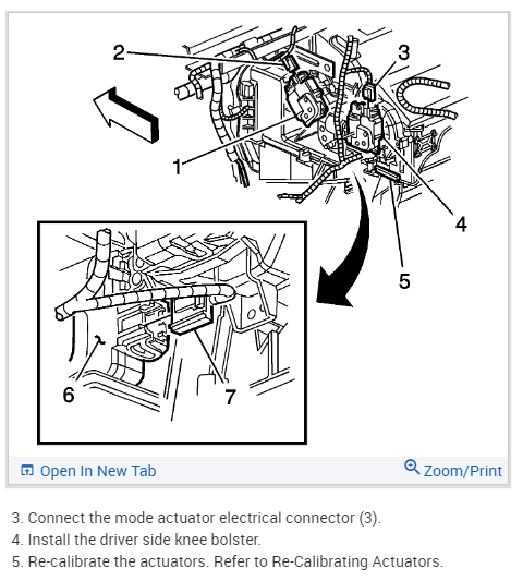

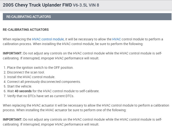

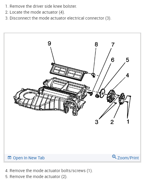

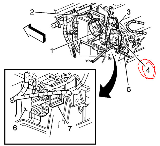

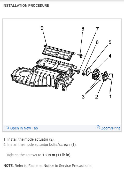

i changed the blend door actuator and i also changed the climate control panel the anti freeze is filled the heater core is good and the thermostat was checked as well. any ideas would be greatly appreciated.
