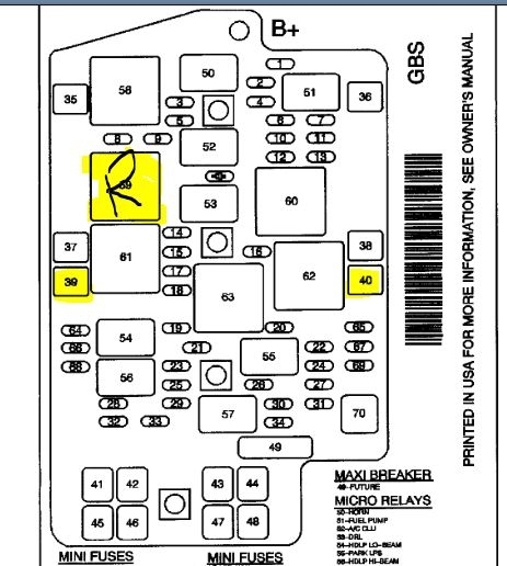

If it cools down when moving and overheats when stopped, it sounds like the radiator cooling fan is not turning on. Check to see if you notice them running when it starts getting hot.
Take a look through this link:
Now, if you find they aren't working, we need to check a couple things. First, we need to confirm that fuses 39 and 40 are not blown. Also, check relay 59. These are all located under the hood in the fuse / relay box. I attached a pic and highlighted the things needing checked. I placed an R on the relay. Here are a few links you may find helpful. Also, the last link explains how to check a relay.
https://www.2carpros.com/articles/how-a-car-fuse-works
Next is the relay. If you find another relay in the box with the same part number, switch the two and see if the fans work then. Or, here is the link that explains how to check a relay:
