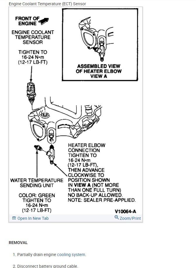

Where is it located on the engine exactly?

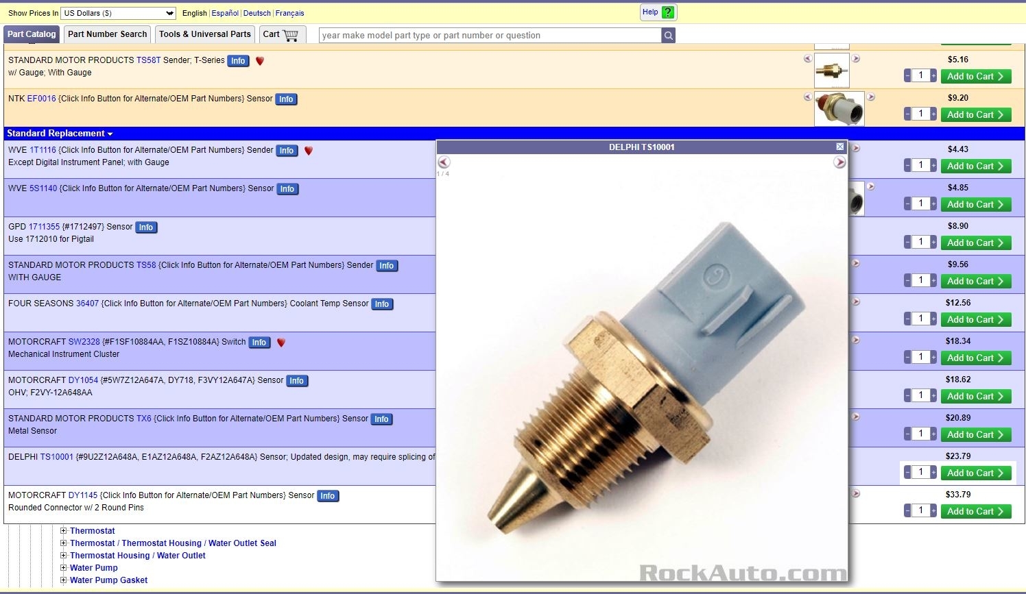

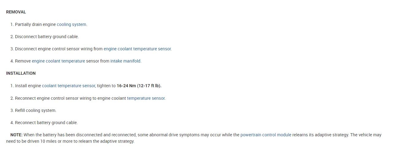

I attached pictures and the procedure for you of the sensor below.
https://www.2carpros.com/articles/coolant-temperature-sensor-cts-replacement
Check out the diagrams (Below). Please let us know if you need anything else to get the problem fixed. Roy
