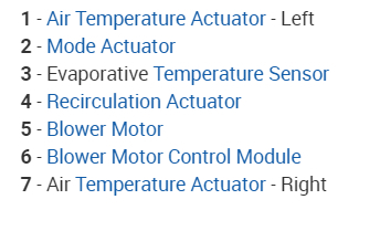

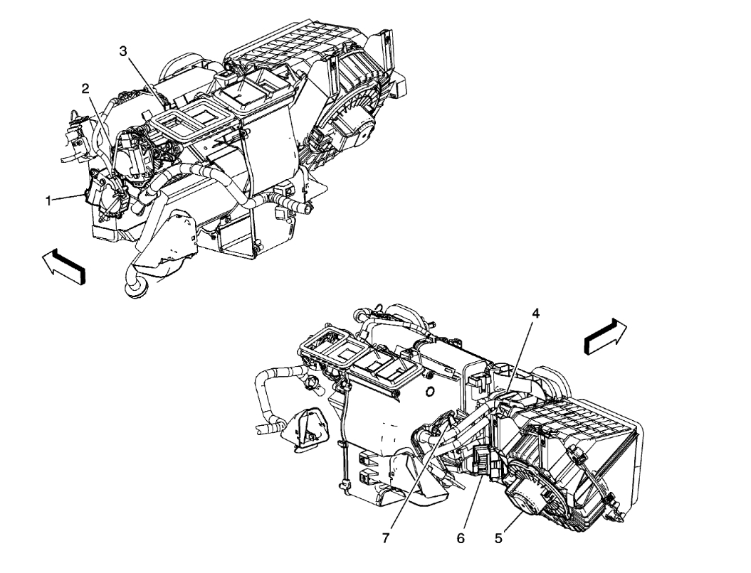

Yes, you have a blend door actuator on the drivers side that needs to be replaced. here is a guide to help walk you through the repair with diagrams below to show you how on your car:
