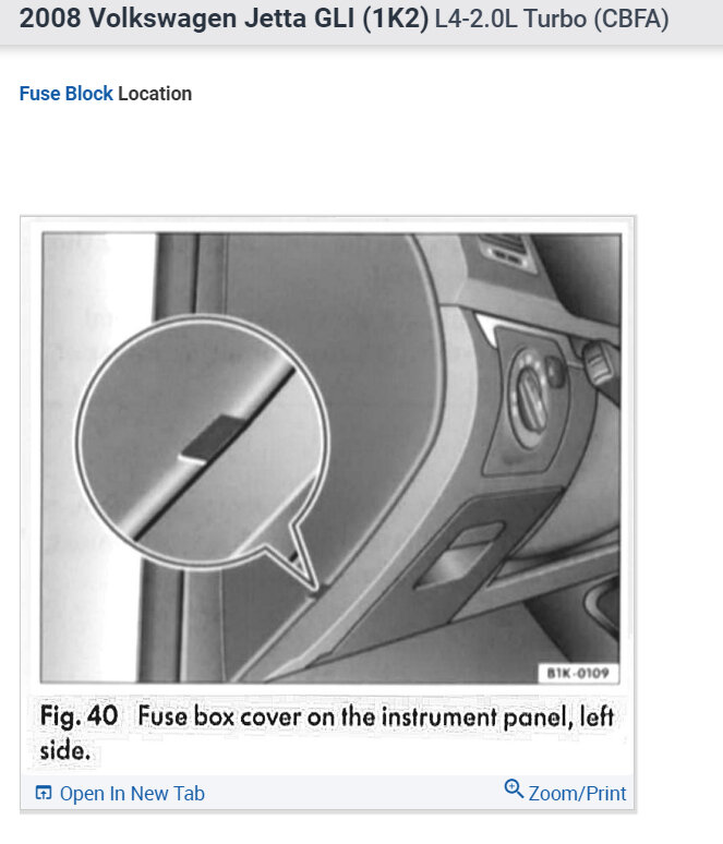

fuse associated with the A/C blower motor. Where is it located, the fuse?

Sure, it is fuse #22 - 40 amp in fuse panel C. here is a guide to test it and the fuse location in the image below:
Check out the images (below). Please let us know if you need anything else to get the problem fixed.
