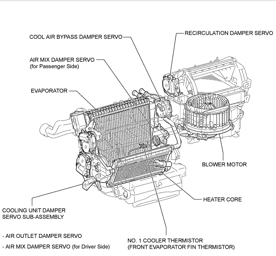

Air is not flowing through rear passenger head vents. Front air is blowing fine from the front dash.
Jun 23, 2018 at 5:52 PM
This sounds like the passengers side blend door actuator is not working right. Here is a guide to show you what you are in for when changing the actuator and diagrams below that will show you the location on your car:
