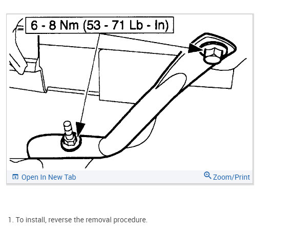

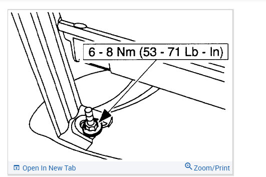

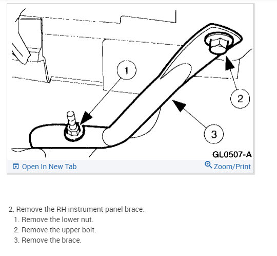

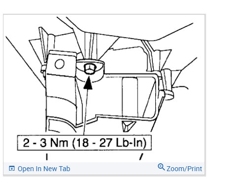

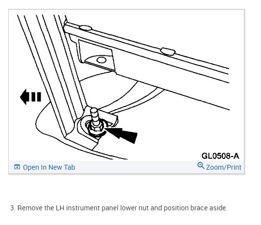

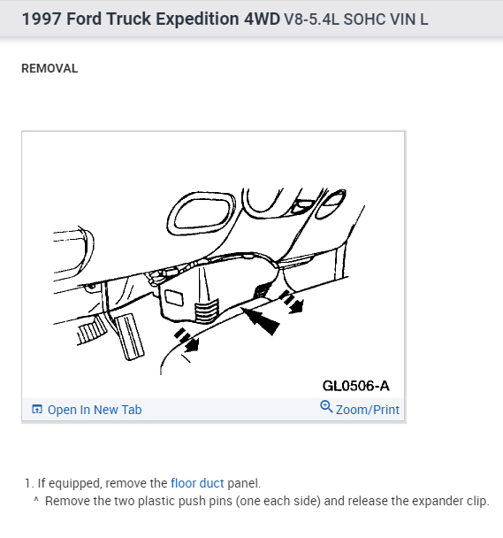

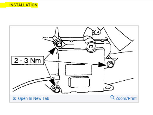

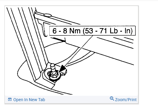

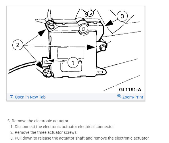

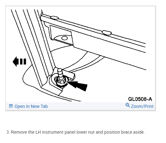

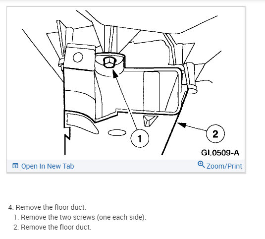

Replacing the blend air door actuator really isn't that difficult. The worst part is accessing it under the dash.
To get you started, here is a link that explains in general how one is done:
If you look below, I attached the directions for the removal and replacement of the actuator on this vehicle.
Before replacing it, place your finger on the actuator and see if you can feel the clicking to confirm that it is the correct part.
See pics below.
