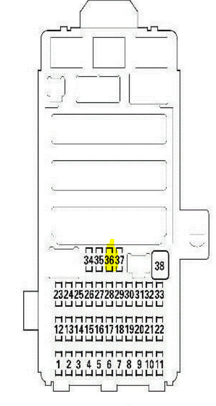

First, check the No. 36 (10 A) fuse in the under-dash fuse/relay box. See pic 1 below for location.

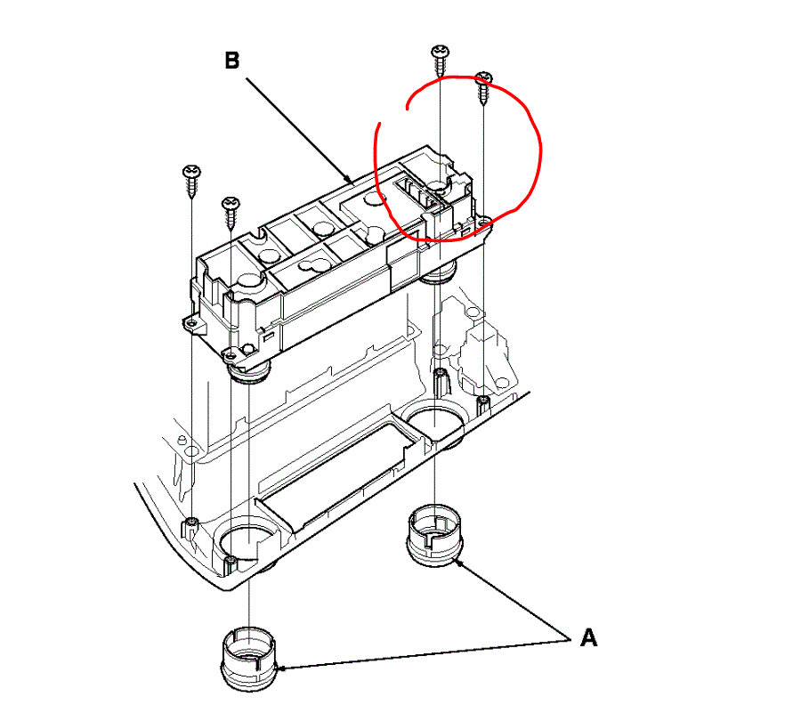

Next, the HVAC control unit 24P connector is located on the rear of the control unit in the dash. Check to make sure it isn't loose. See Pic 2.
