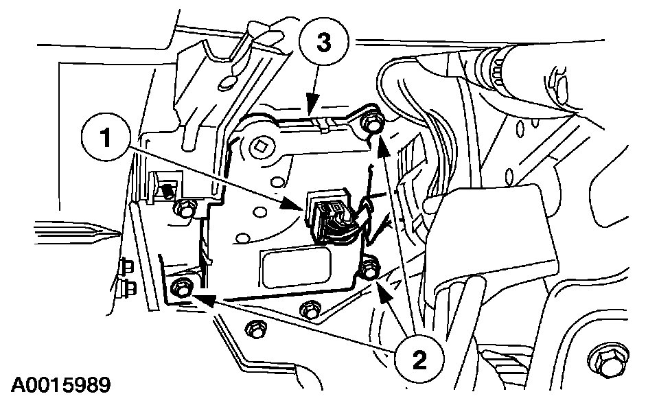

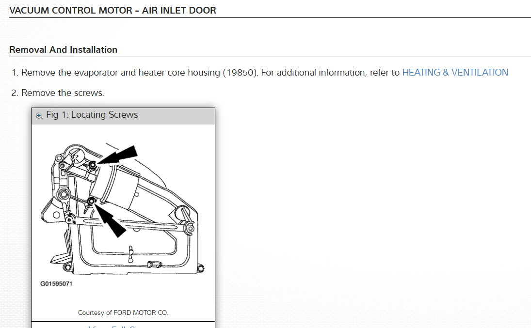

Here are the directions specific to your vehicle. This isn't a bad one to access. The attached pics correlate with the directions.
_______________
2004 Ford Taurus V6-3.0L DOHC VIN S
Temperature Blend Door Actuator
Vehicle Heating and Air Conditioning Air Door Actuator / Motor Service and Repair Procedures Temperature Blend Door Actuator
TEMPERATURE BLEND DOOR ACTUATOR
REMOVAL
pic 1

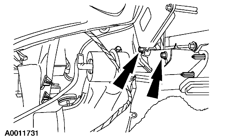

1. Remove the right-side lower instrument panel insulator.
pic 2

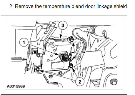

2. Remove the temperature blend door linkage shield.
pic 3

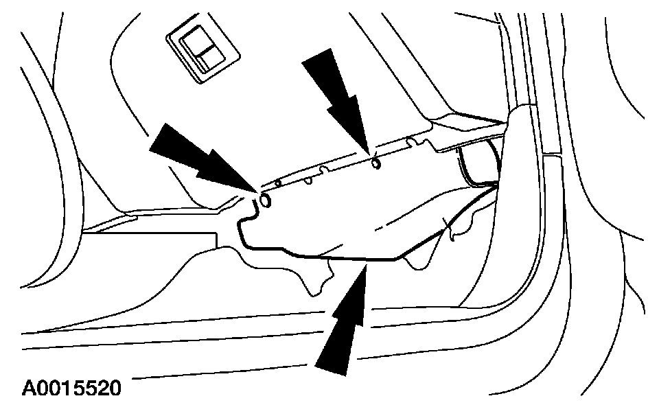

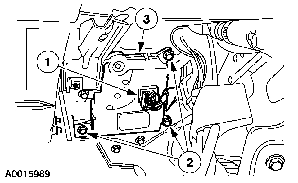

3. Remove the temperature blend door actuator.
1 Disconnect the electrical connector.
2 Remove the screws.
3 Remove the temperature blend door actuator.
INSTALLATION
1. To install, reverse the removal procedure.
