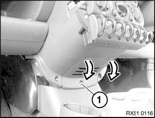

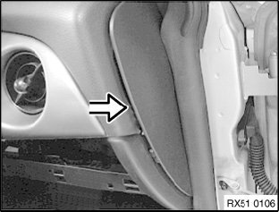

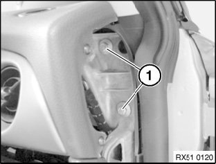

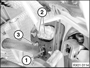

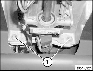

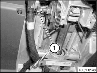

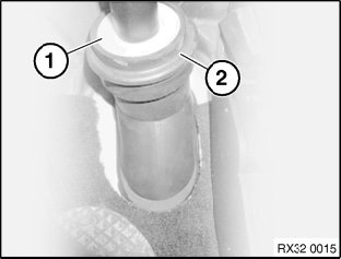

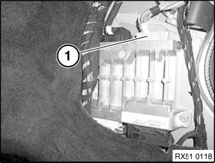

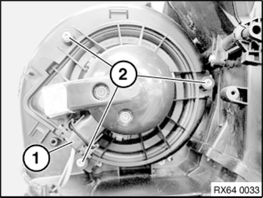

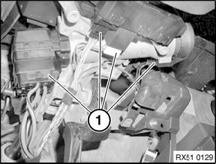

As far as replacing the blower motor... ugh! It is not easy. The dash needs removed. Here are the directions for removing the dash to access the motor. The first 13 pictures correlate with these directions. The last picture is that of the blower motor. Once everything is removed, it is easy to access.
51 45 030 REMOVING AND INSTALLING INSTRUMENT PANEL TRIM (WITH CARRIER AND HEATER)
51 45 030 Removing And Installing Instrument Panel Trim (With Carrier And Heater)
Necessary preliminary tasks:
Drain coolant
Version with air conditioner: Drain off air conditioner
W10 only: Remove battery container
W11, W17 only: Remove intake filter housing
Remove both trims for roof pillars (A-pillar) at front
Remove radio receiver
Remove inside entrance cover strip

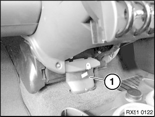

Remove lower section of steering column trim
Unclip and disconnect heater hose (1).
Release screws (2), tightening torque 7.5 Nm
Detach A/C lines.
Installation: Replace O-rings.
Release nut (3) on guide pin/heater, tightening torque 7.5 Nm
Turn steering wheel to expose nut (1).
Release nut (1), tightening torque 21 Nm
Installation: Replace nut (1).

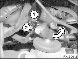

Release screw (2).
Detach steering column.
Detach steering column (1) from rubber seal (2).
Release screw (1).
Release retaining clips and take off cover.

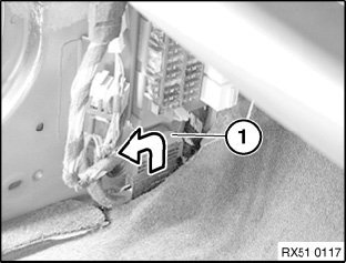

Turn plug connection (1) in direction of arrow and unclip.
Unfasten plug connection (1) and disconnect.
Unlock and disconnect plug connector (1) from BC1.
Release side instrument panel trim on left and right and remove.
Release left and right mounting bolts (1) of instrument panel trim,
1AZ Instrument panel trim, screws to body 48 Nm

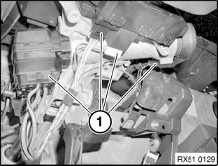

Unclip wiring harness at holders (1) on instrument panel trim.
Unlock and disconnect plug connections (1) from steering column.
Unlock and disconnect plug connection (1) from heater/air conditioner.
Release screws (1),
2AZ Lower instrument panel trim, screws 8 Nm
Important: Two persons are required to remove the instrument panel trim.
Installation: Make sure that connection (1) to rear heater duct is secured to heater/air conditioner prior to installation and placed in the correct position.
Okay, as you can see, it isn't a simple job. This post is either going to help or create a headache. I hope it helps. lol

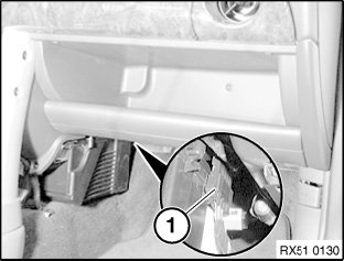

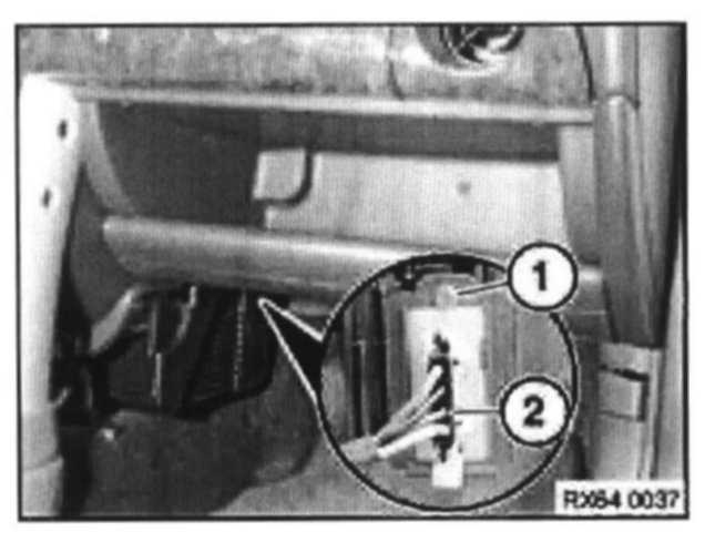

As far as the resister, most times when one is bad, the fan will operate on high only. I attached a picture of the blower motor resister. If you want to replace it, once located simply:
Remove bolt (1).
Remove resistor pack (2).
Let me know if that helps or if you have other questions.
