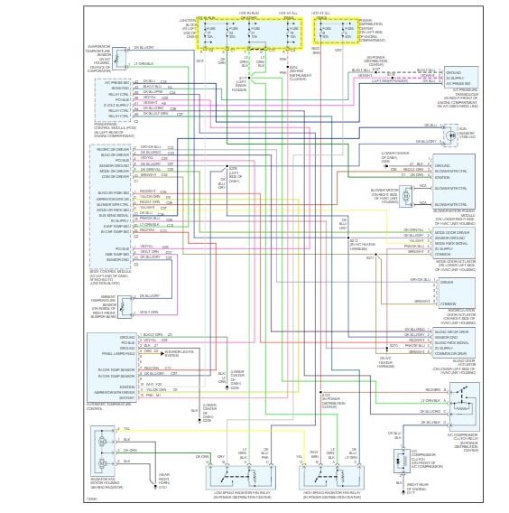

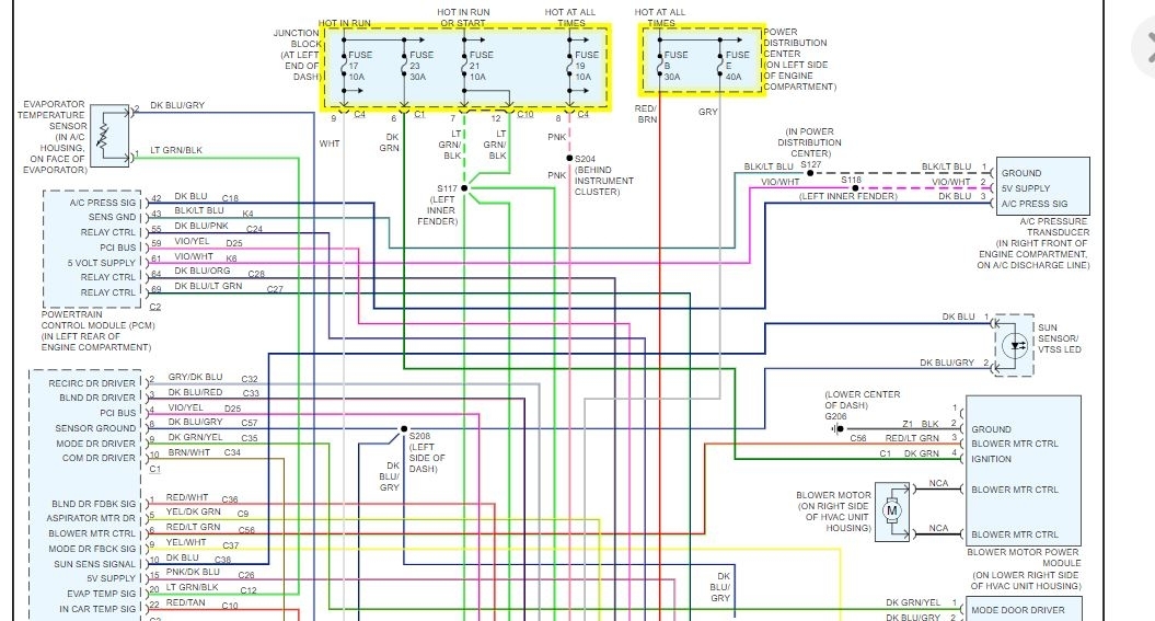

The control is powered by a couple fuses. I attached a diagram of the fuses you need to test.
Check for power on both sides of the fuses with a test light or voltmeter.
