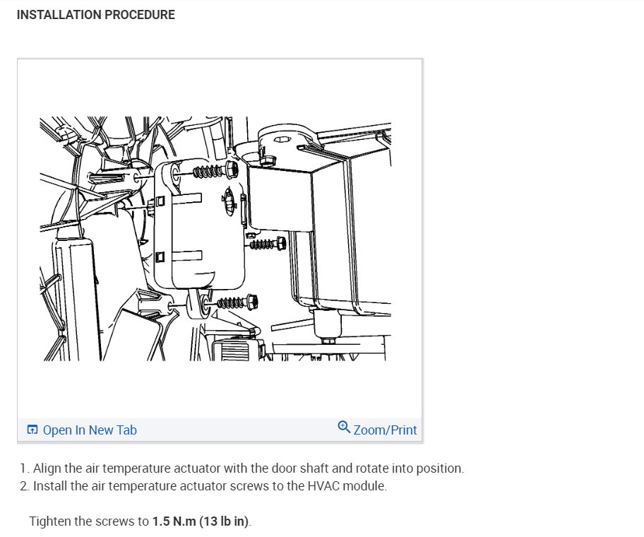

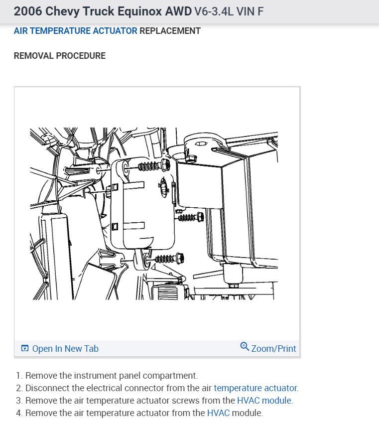

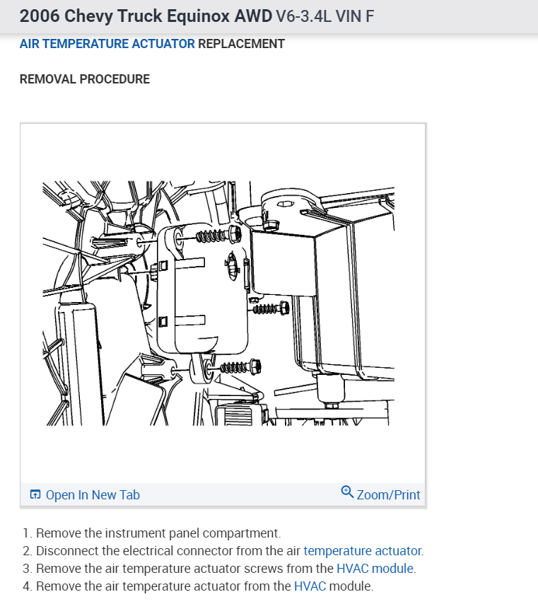

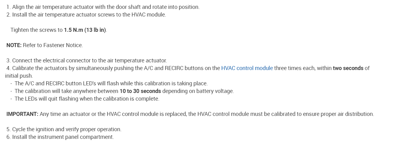

So, what happens is the head gasket can leak slightly which fills the heater core with exhaust gases which causes the heater not to work. This guide can confirm the issue, if the test comes up negative, I would try switching out the temperature control blend door actuator which I have included instructions be in the images below.
This guide can help as well:
https://www.2carpros.com/articles/car-heater-not-working
Check out the images (below). Please let us know what you find.
