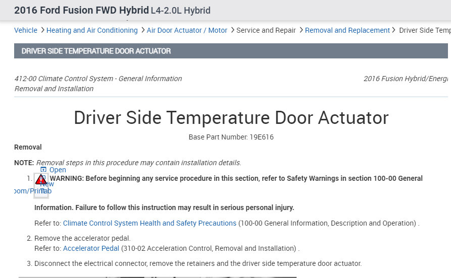

Here is what I recommend, first, take a look through this link, it explains in general how to replace a blend air door actuator:

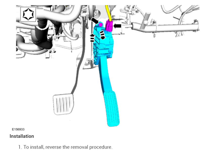

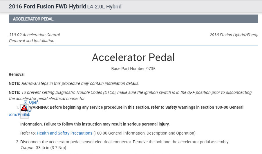

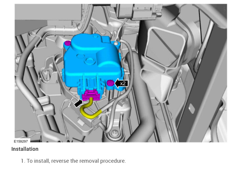

If you look below, the first two pictures are the directions specific to your vehicle for replacement. Note that the accelerator pedal needs to be removed to access the actuator. Therefore, the remaining pics are the directions for removing and installing it.
See pics below.
