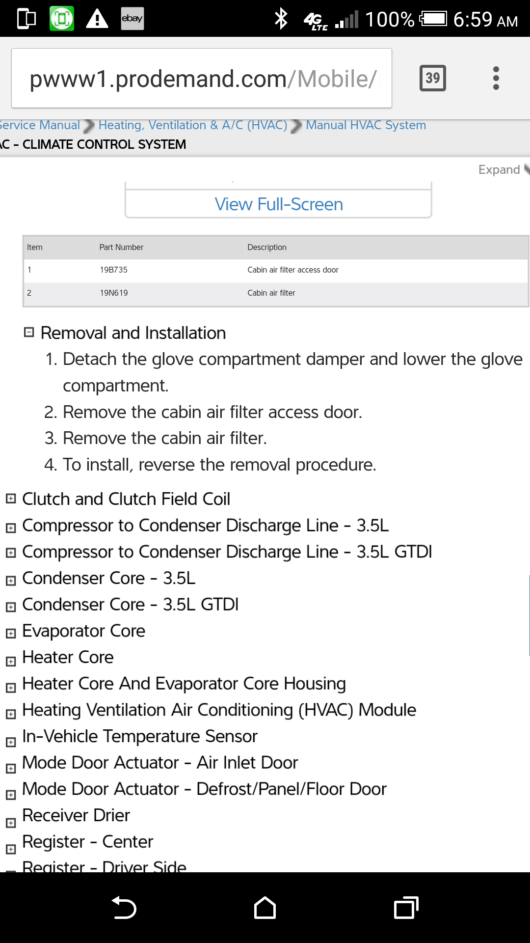

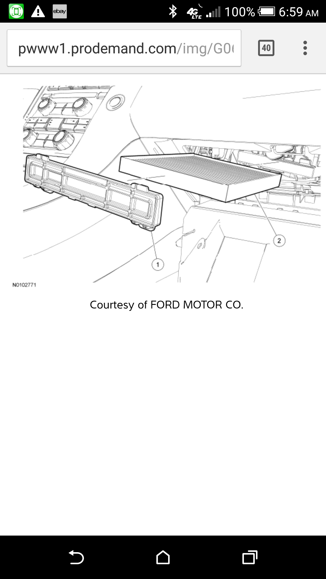

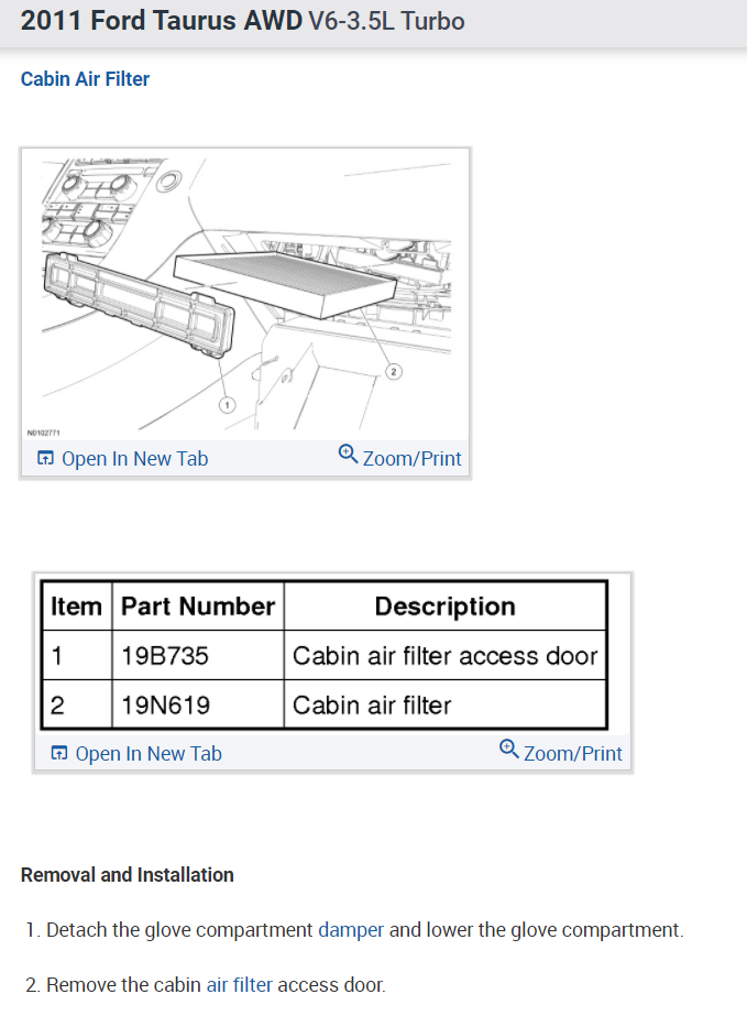

You do mean airflow is barely coming out? I would change the air cabin filter here is a guide to help walk you through the steps with instructions below to help you with your car.
https://www.2carpros.com/articles/how-to-change-an-air-cabin-filter
Check out the diagrams (Below). Please let us know what happens.

Have you checked to see if the cabin air filter is plugged up from not being changed in a really long time,?
Jan 13, 2017 at 7:44 PM
It sounds like it could be a blend door actuator has gone bad. Does it sounds like the blower is working normally but no air is coming out?
Best, Ken
Jan 13, 2017 at 10:31 PM
SATURNTECH9
  • 30,869 POSTS
When you change the different air positions does the air come out full speed in any of the positions ?Try removing the cabin air filter and closing the cabin air filter door and see if the air flow improves.
Jan 14, 2017 at 6:55 AM
SATURNTECH9
  • 30,869 POSTS
I posted the instructions and diagram for the pollen filter removal.Just make sure you pay attention to which way the arrow on the pollen filter is going.So when you put one back in you know the new one is installed correctly.
Jan 14, 2017 at 7:03 AM

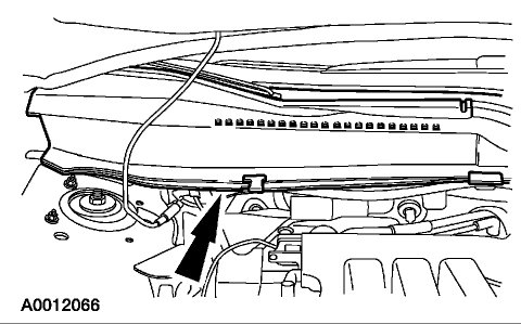

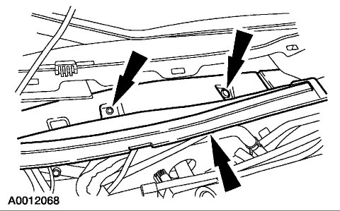

Remove the right side cowl vent screen. Remove the screws and the water shield. Remove the pollen filter. To install filter, reverse removal procedure.

under hood right side Removal & Installation open hood Remove the right side cowl vent screen.. Remove the screws and the water shield. Remove the pollen filter. To install filter, reverse removal procedure.

(2000-2007) Open hood Remove the right side cowl vent screen. Remove the screws and the water shield. Remove the pollen filter. To install filter, reverse removal procedure.
