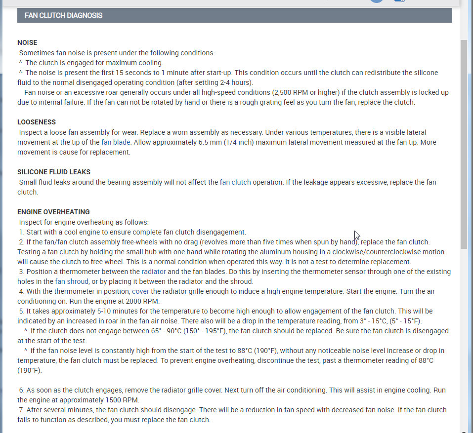

Okay. I understand now. Just to confirm the fan runs all the time? If this is the case, your fan clutch is stuck and causes the fan to run when the engine runs and this is not going to allow your coolant to come up to temperature.
https://www.2carpros.com/articles/fan-clutch-symptoms
https://www.2carpros.com/articles/fan-clutch-removal
Below is some more info on this but it sounds like it needs to be replaced.
Let me know if I am still missing something. Thanks
