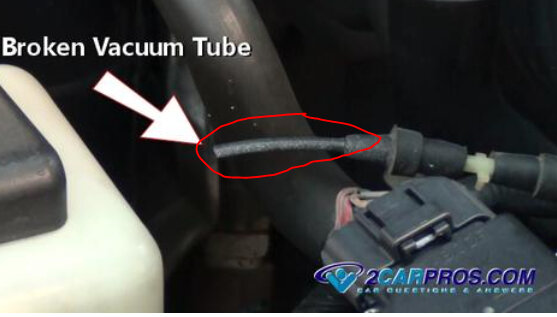

Does this seem to happen when the engine us under a load such as going up a hill? I ask because the HVAC duct work and control doors are operated using engine vacuum. Based on what is happening, it sounds like either there is a vacuum leak under the dash, the mode door vacuum actuator is faulty, or the vacuum supply from the engine is leaking.
Try this. Turn the system on with the engine running. See if you can hear a hissing sound from anywhere under the dash, including where the controller is. Additionally, check for engine vacuum leaks under the hood on the engine.
Try that and let me know the results. Also, Chrysler and others love using vacuum tubes. They are known to dry out and crack. See the pic below. It shows what I'm referring to.
See pic below.
