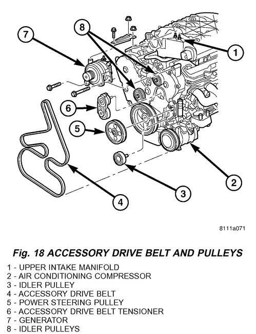

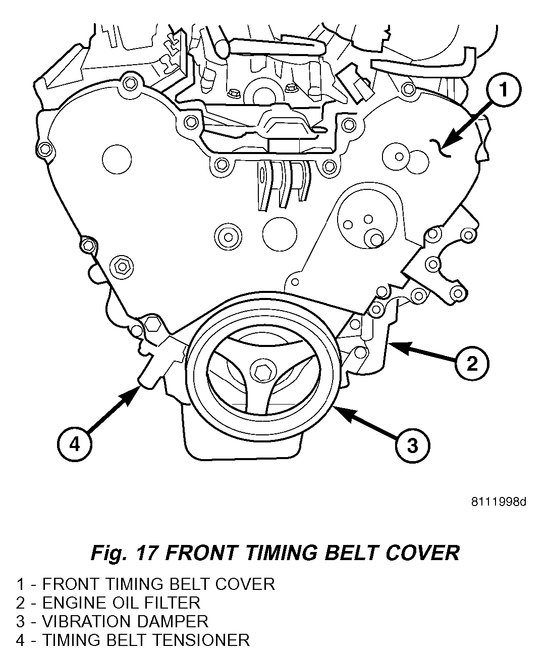

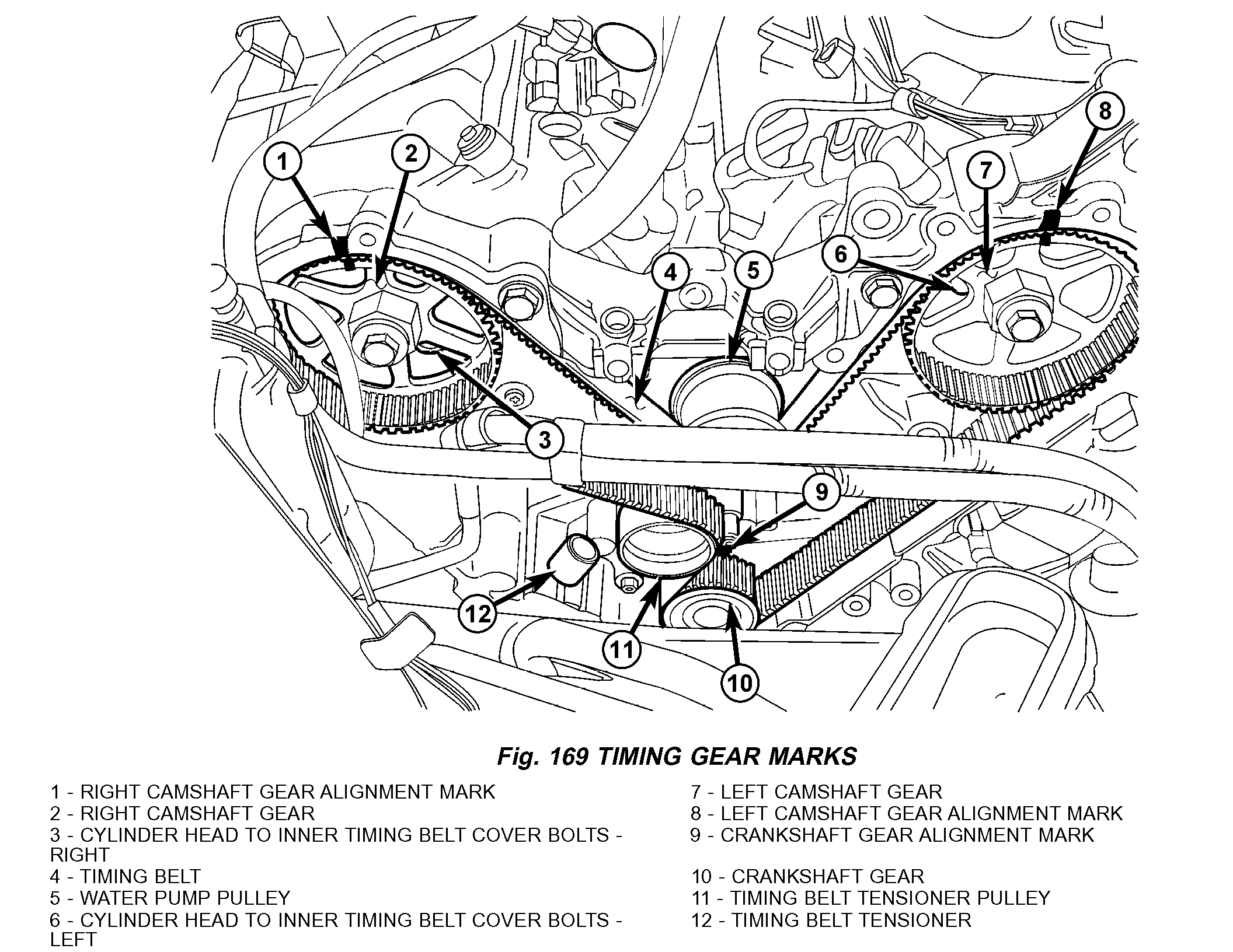

12) Remove the outer timing belt cover.

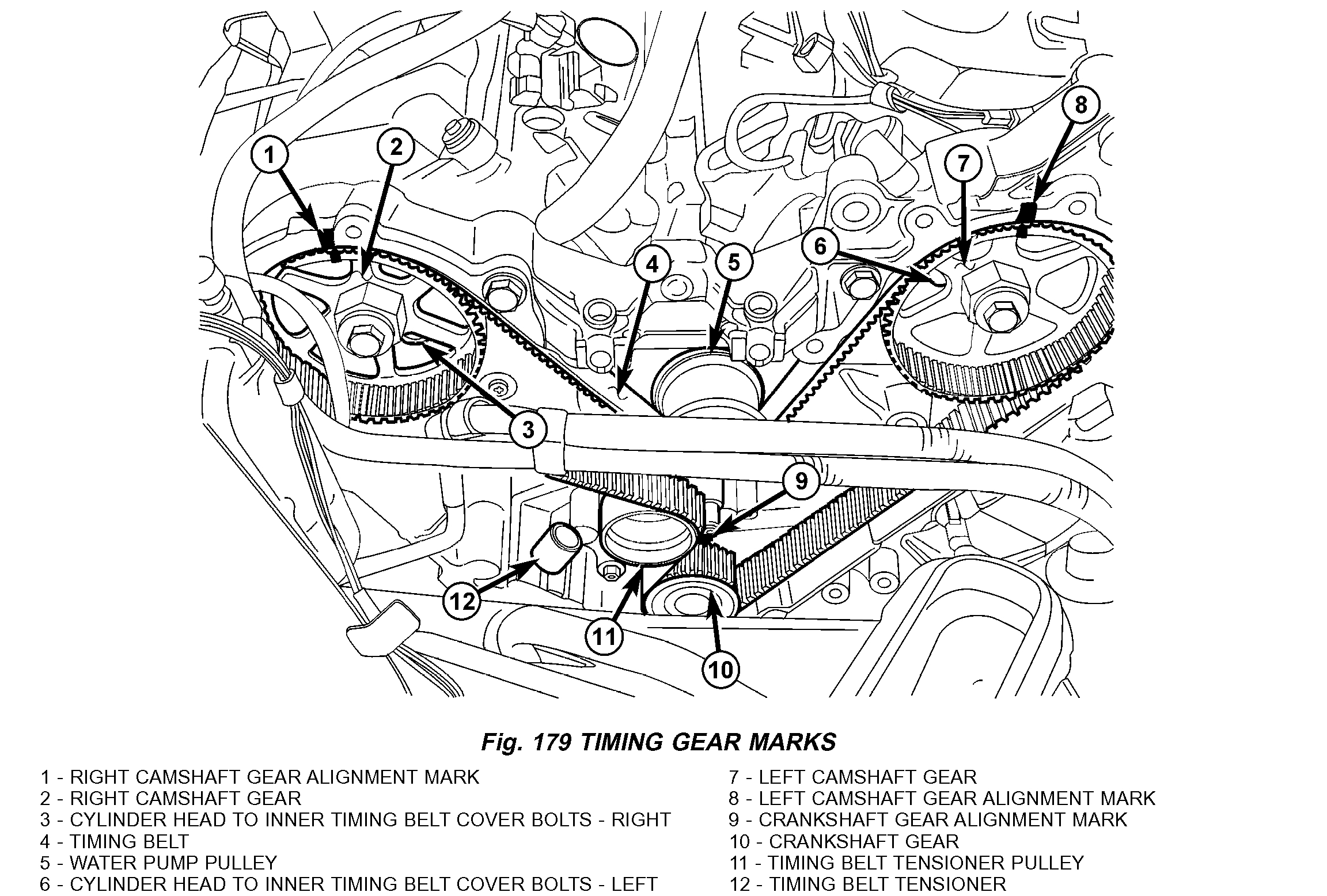

pic 1

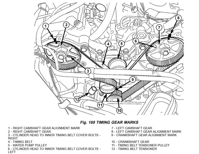

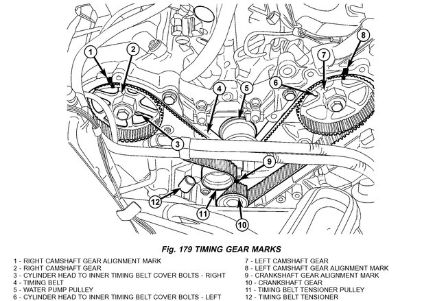

13) Rotate the engine to TDC and align the timing marks (Fig. 19).
14) Remove the timing belt tensioner, timing belt, then reset tensioner (Fig. 19).

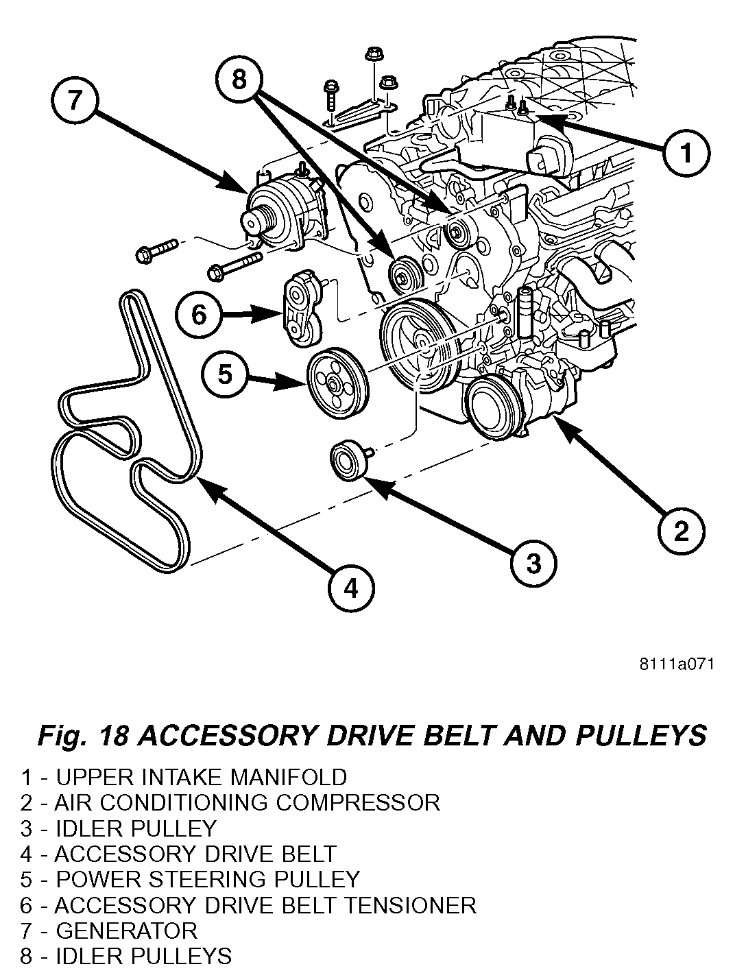

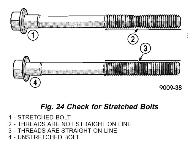

pic 2

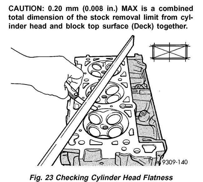

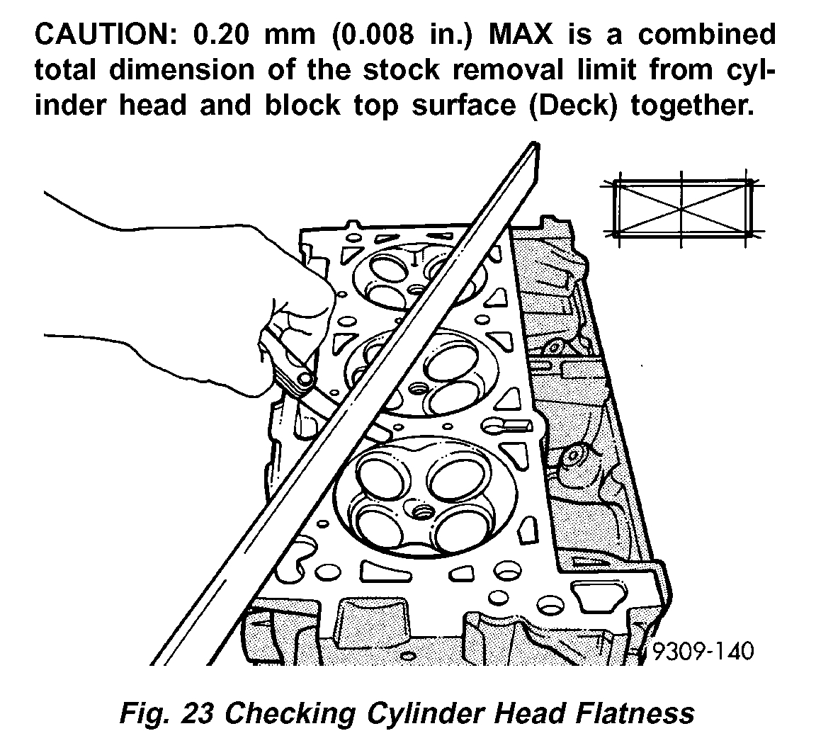

3) Check cylinder head for flatness (Fig. 23).
4) Cylinder head must be flat within:
- Standard dimension = less than 0.05 mm (0.002 inch)
- Service Limit = 0.2 mm (0.008 inch)
- Grinding Limit = Maximum of 0.2 mm (0.008 inch) is permitted.
CAUTION: 0.20 mm (0.008 inch) MAX is a combined total dimension of the stock removal limit from cylinder head and block top surface (Deck) together.

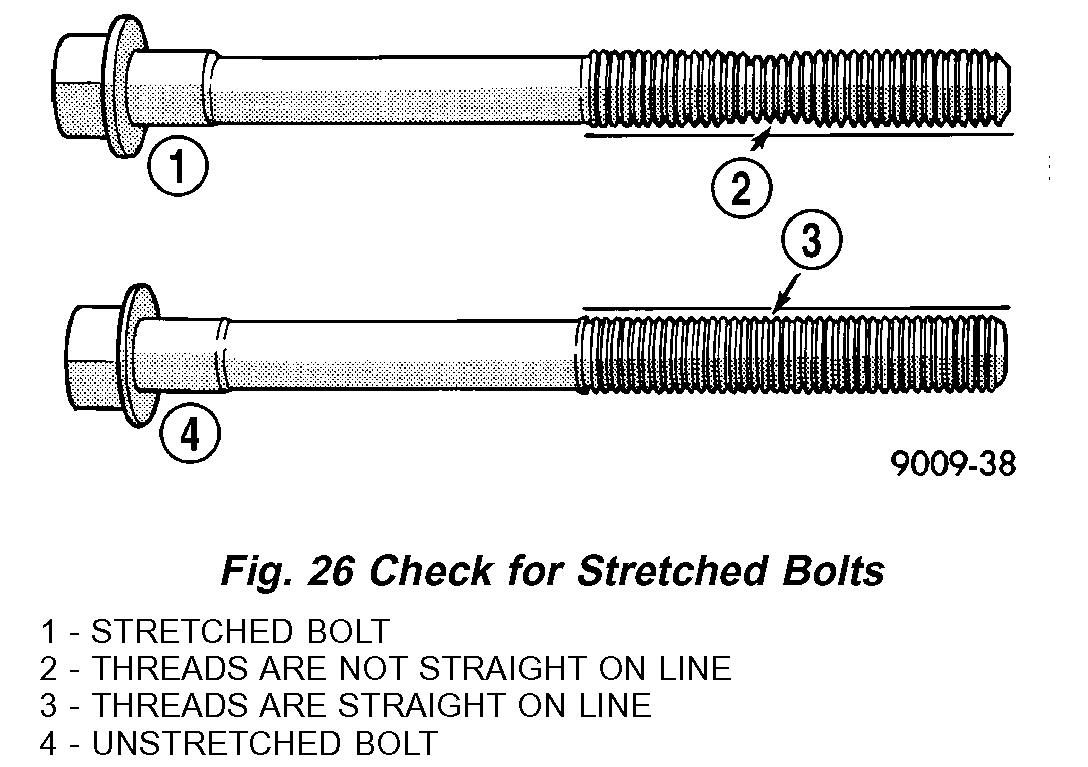

CAUTION: THE CYLINDER HEAD GASKETS ARE NOT INTERCHANGEABLE BETWEEN CYLINDER HEADS AND ARE CLEARLY MARKED RIGHT OR LEFT.
The cylinder head bolts are tightened using a torque plus angle procedure. The bolts must be examined BEFORE reuse. If the threads are necked down the bolts must be replaced (Fig. 24).

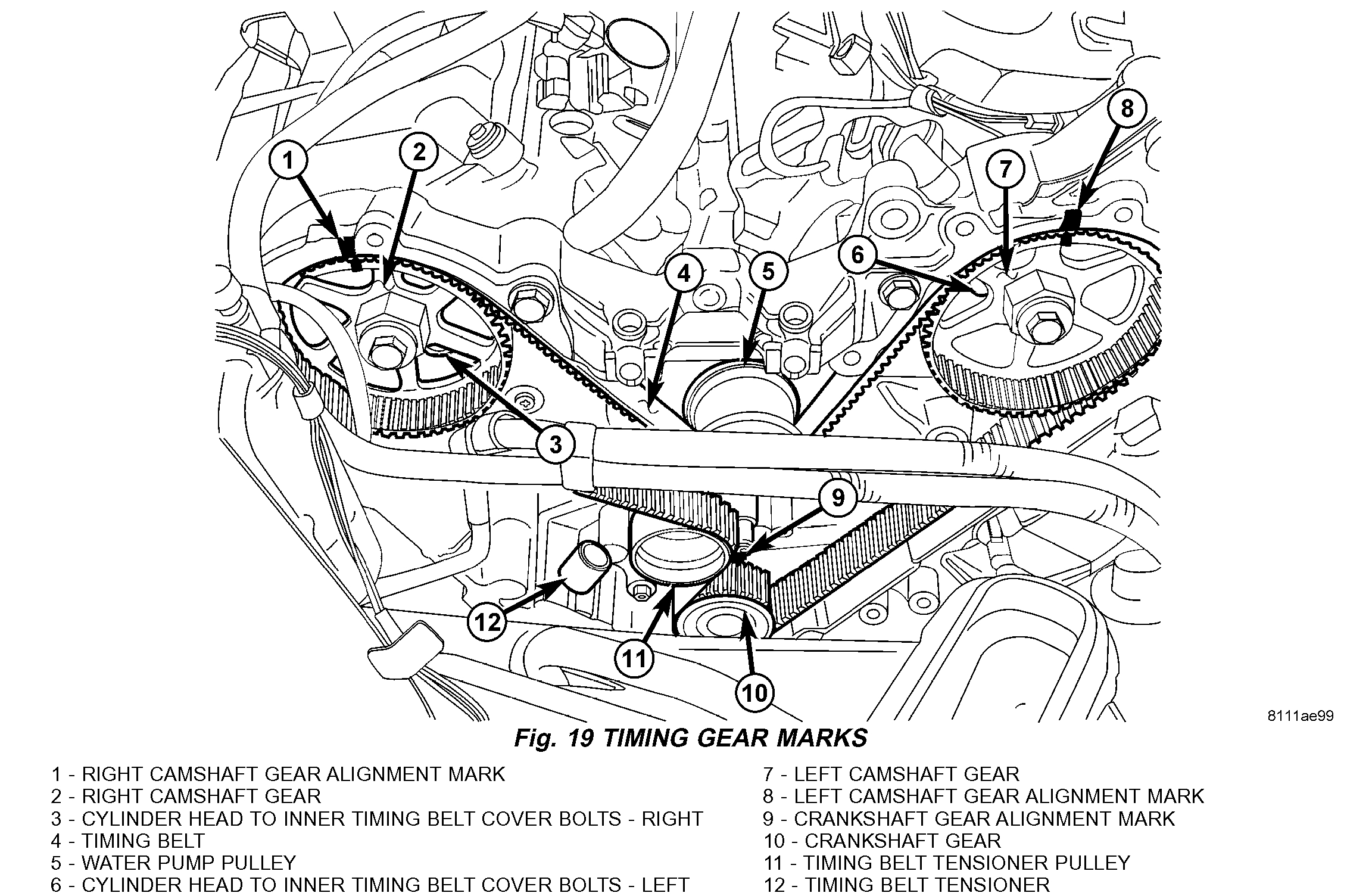

pic 3

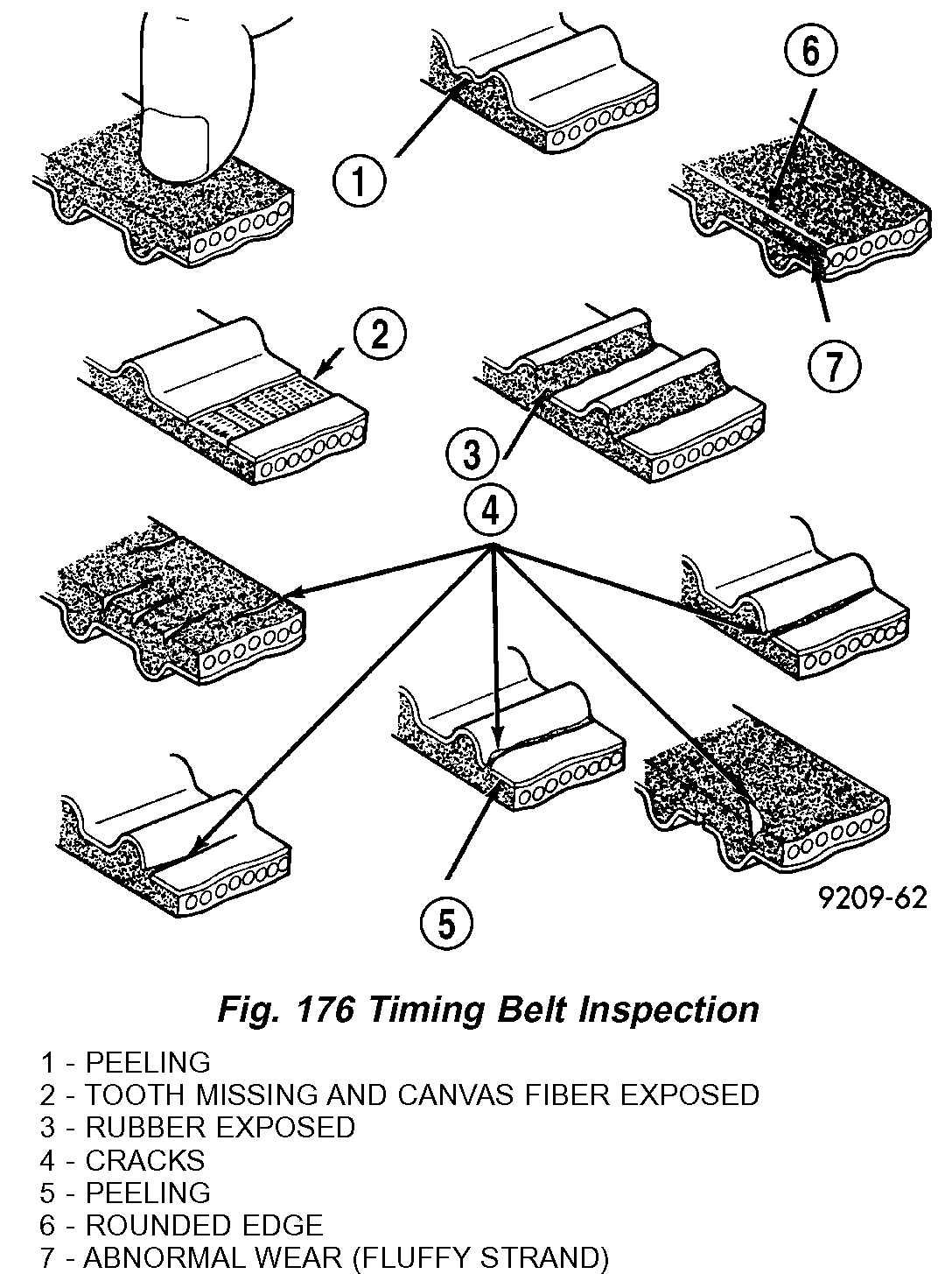

Necking can be checked by holding a scale or straight edge against the threads. If all the threads do not contact the scale the bolt must be replaced (Fig. 26).

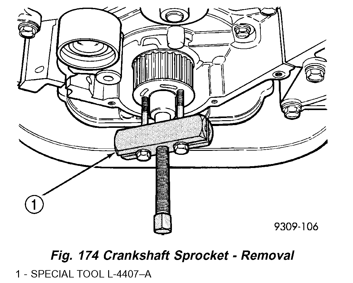

pic 4

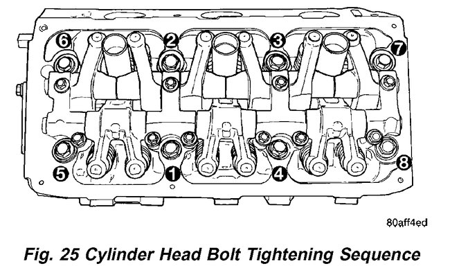

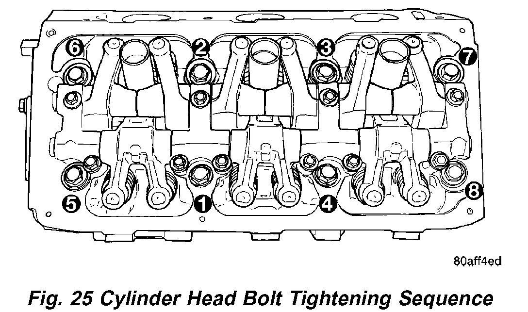

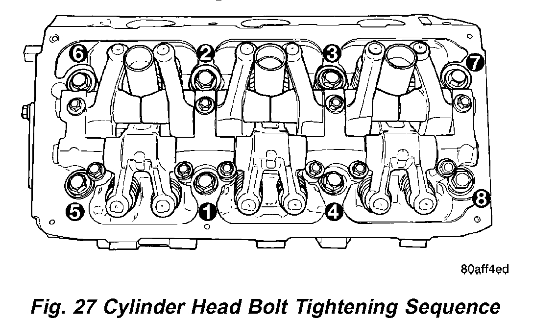

4) Tighten the cylinder head bolts in the sequence shown in (Fig. 27). Using the 4 step torque-turn method, tighten according to the following torque values:
- Step 1: All to 61 Nm (45 ft. lbs.)
- Step 2: All to 88 Nm (65 ft. lbs.)
- Step 3: All (again) to 88 Nm (65 ft. lbs.)
- Step 4: + 90° Turn Do not use a torque wrench for this step.
5) Bolt torque after 90° turn should be over 122 Nm (90 ft. lbs.) in the tightening direction. If not, replace the bolt.

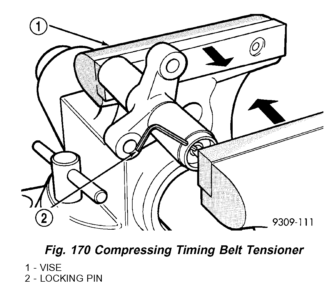

pic 5

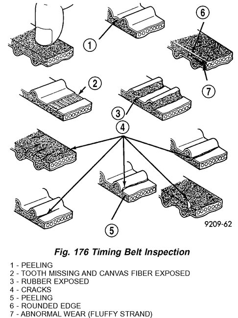

12) Remove accessory drive belt (Fig. 18).
13) Remove vibration damper (Fig. 17).
14) Remove lower accessory drive belt idler pulley (Fig. 18).

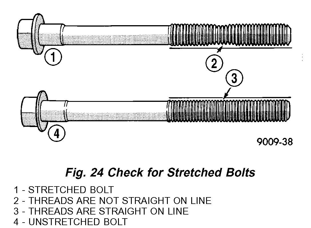

pic 6

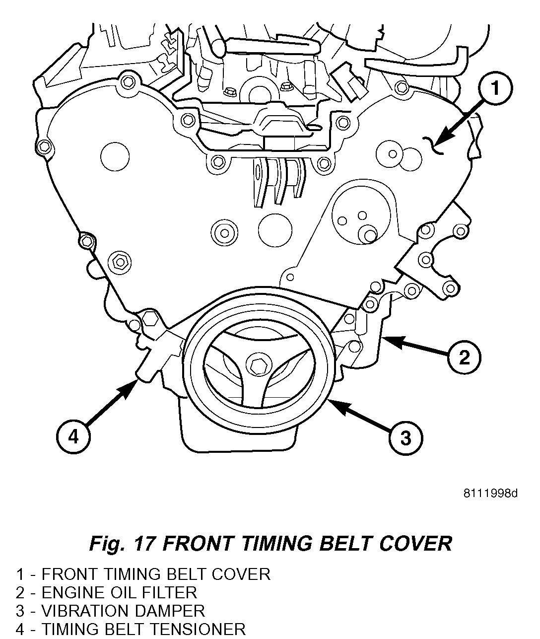

16) Remove lower outer timing belt cover bolts (Fig. 17).

31) Rotate the engine to TDC and align timing belt marks.
32) Remove the timing belt tensioner and reset the tensioner. (Fig. 17).
33) Remove the timing belt.

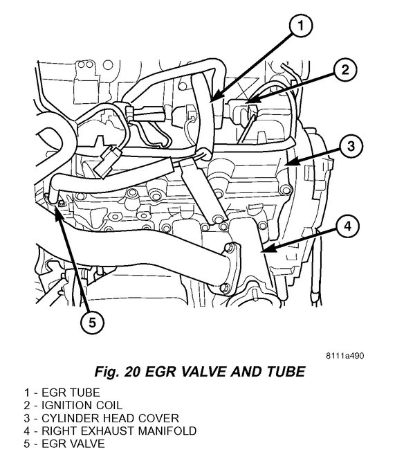

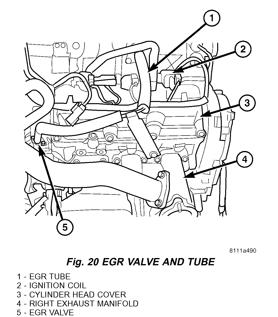

34) Remove the right valve cover to cylinder head ground strap (Fig. 20).
35) Remove the EGR valve and tube assembly (Fig. 20).
36) Remove the right cylinder head cover (Fig. 20).

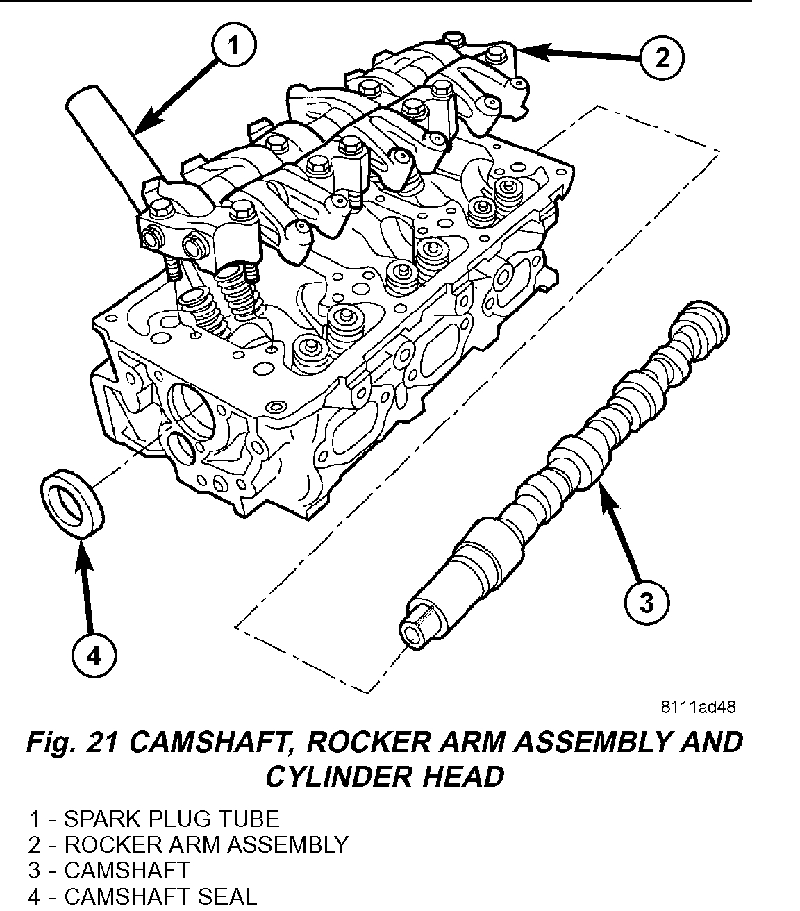

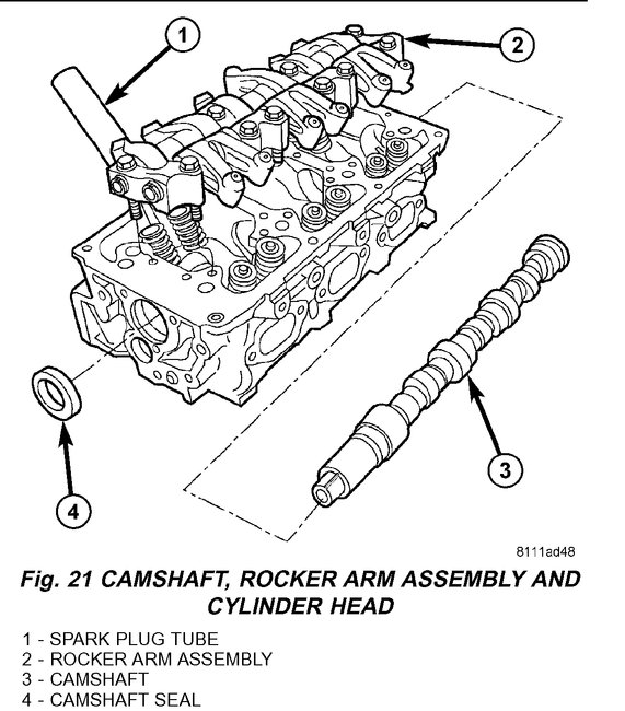

37) Remove the right rocker arm assembly (Fig. 21).
38) Remove the right rear camshaft thrust plate.
39) Counterhold the cam gear and remove the right cam gear retaining bolt.
pic 9
40) Push the camshaft out of the back of the cylinder head approximately 3.5 inches and remove the cam gear (Fig. 22).

5) Tighten the cylinder head bolts in the sequence shown in (Fig. 25). Using the 4 step torque-turn method, tighten according to the following torque values:
6) Bolt torque after 90° turn should be over 122 Nm (90 ft. lbs.) in the tightening direction. If not, replace the bolt.

Timing belt removal
TIMING BELT AND SPROCKETS
REMOVAL - TIMING BELT
TIMING VERIFICATION
Remove the outer timing covers. Rotate the crankshaft until the pointer on the crankshaft sprocket aligns the TDC mark on the oil pump. Check to determine if the camshaft sprocket timing marks are aligned with the marks on the inner timing cover. It may take an additional full revolution of the crankshaft before the camshaft sprocket marks are aligned (Fig. 169).
CAUTION: The 3.5L is NOT a freewheeling engine. Therefore, loosen the valve train rocker assemblies before servicing the timing drive.
1) Perform fuel pressure release procedure.
2) Disconnect negative battery cable.
3) Remove both cylinder head covers and loosen the rocker arm assemblies.
4) Remove the front timing belt cover.
5) Mark belt running direction, if timing belt is to be reused.
CAUTION: When aligning timing marks, always rotate engine by turning the crankshaft. Failure to do so will result in valve and/or piston damage.
pic 14
6) Rotate engine clockwise until crankshaft mark aligns with the TDC mark on oil pump housing and the camshaft sprocket timing marks are aligned with the marks on the rear cover (Fig. 169)
7) Remove the timing belt tensioner (Fig. 169) and remove timing belt.
8) Inspect the tensioner for fluid leakage.
9) Inspect the pivot and bolt for free movement, bearing grease leakage, and smooth rotation. If not rotating freely, replace the arm and pulley assembly
10) When tensioner is removed from the engine it is necessary to compress the plunger into the tensioner body
CAUTION: Index the tensioner in the vise the same way it is installed on the engine. This ensures proper pin orientation when tensioner is installed on the engine.
pic 15
a) Place the tensioner into a vise and SLOWLY compress the plunger (Fig. 170). Total bleed down of tensioner should take about 5 minutes.
b) When plunger is compressed into the tensioner body install a pin through the body and plunger to retain plunger in place until tensioner is installed.

INSPECTION - TIMING BELT
1) Remove front timing belt cover.
pic 17
2) Inspect both sides of the timing belt. Replace belt if any of the following conditions exist (Fig. 176):
a) Hardening of back rubber back side is glossy without resilience and leaves no indent when pressed with fingernail.
b) Cracks on rubber back.
c) Cracks or peeling of canvas.
d) Cracks on rib root.
e) Cracks on belt sides.
f) Missing teeth.
g) Abnormal wear of belt sides. The sides are normal if they are sharp as if cut by a knife.
h) Vehicle mileage or time at component maintenance requirement.
3) If none of the above conditions are seen on the belt, the front timing belt cover can be installed.
TIMING BELT
CAUTION: If camshafts have moved from the timing marks, always rotate camshaft towards the direction nearest to the timing marks (DO NOT TURN CAMSHAFTS A FULL REVOLUTION OR DAMAGE to valves and/or pistons could result).
pic 18
1) Align the crankshaft sprocket (10) (Fig. 179) with the TDC mark (9) on oil pump cover.
2) Align the camshaft sprockets (2, 7) timing reference marks (1, 8) with the marks on the rear cover.
3) Install the timing belt starting at the crankshaft sprocket (10) going in a counterclockwise direction. Install the belt around the last sprocket. Maintain tension on the belt as it is positioned around the tensioner pulley (11).
NOTE: If the camshaft gears have been removed it is only necessary to have the camshaft gear retaining bolts installed to a snug torque at this time.
4) Holding the tensioner pulley (11) against the belt, install the tensioner into the housing and tighten to 28 Nm (250 inch lbs.). Each camshaft sprocket mark should remain aligned the cover marks.
5) When tensioner is in place pull retaining pin to allow the tensioner to extend to the pulley bracket.
6) Rotate crankshaft sprocket 2 revolutions and check the timing marks on the camshafts and crankshaft. The marks should line up within their respective locations. If marks do not line up, repeat procedure.
NOTE: If camshaft gears have been removed and timing is correct, counterhold and tighten the camshaft gears to final torque specification.
7) Install the front timing belt cover.
8) Tighten the rocker arm assemblies and install the cylinder head covers.
9) Connect negative battery cable.
