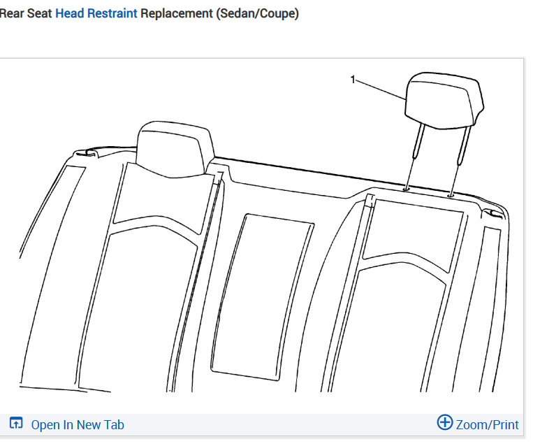

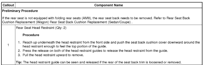

May 31, 2025 at 1:21 PM
Here is how to replace the rear seat headrest. Check out the images (below). Let us know if you need anything else.
